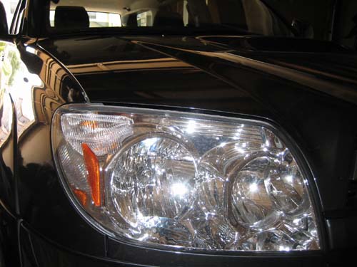

I'm gonna let you guys in on a little mod I tried a couple weeks ago and have been monitoring since. I call it the "eyelid cold air inlet" mod (not really though :p ) . The seal between the headlight and the hood is rubber, and when the hood is shut this rubber stripping presses up against the hood to seal out water and air from entering the engine bay at the top of the headlight. I decided this was a most convenient location to let in some cool outside air (and dirt, and water, etc.) because of its proximity to the front hole in the volant airbox. I opened a slit above the passenger headlight about 1/4" wide and 12" long (the width of the headlight). To do this I simply taped down the rubber seal as low as possible, then inserted a few washers at the point on the passenger side where the hood bumper rests. This lifted the hood about a quarter inch on the passenger side and now I have a nice long hardly noticible gap to let cool air straight in to the airbox.
Over the past few weeks its been pretty hot in Denver, and after I completed this mod, I can honestly tell a difference in hot weather engine response. Around town or at idle on a really hot day when the entire engine compartment is extremely hot and the intake charge is hot the engine runs sluggishly, even with the A/C off. I notice that when I get moving for a couple miles, the cooler air coming in from the headlight gap is having an immediate effect on engine response (where without the mod, even with the new intake, it still reacted sluggishly for some time). I didn't go so far as to measure the air at idle and while moving (or with the mod and without the mod for that matter), but I think its a worthwile mod if you don't live in dusty/rainy areas. I've had the gap open for two weeks now and driving in a hard rain for 2 hours I didn't have any signs of water in the airbox or on the filter. Driving on dirt roads for a whole day only resulted in a thin layer of dust inside the engine compartment with a slightly noticible dust on the filter, which hopefully, the filter took car of. A bug filled 3 hour each way roadtrip resulted in no bugs or road debris of any kind in the box nor the engine compartment. I have it taped temporarily but I think after a few more weeks of careful supervision, I will make a more permanent solution.

Good idea Outrnnr
I was thinking about something like this. Actually more in lines of hooking some sort of duct work to the hood scoop.
This mod works too... Never thought of bringing cool air through there. lol
That's why this forum is so great!
Now, if we can come up with a direct duct from there...
Maybe a pre-filter may help too. I better stop now. I see more money being spent in the near future.

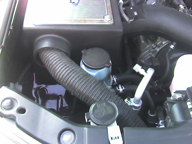

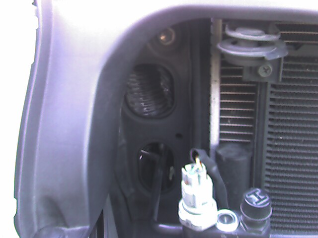

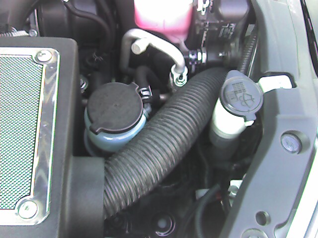

Another thing I thought of was running a hose from the hole in the front of the Volant airbox down behind the passenger headlight to the small black air deflectors at the very bottom of the front passenger fascia. My plan was to cut a hole in these and use a scoop (funnel, vaccum attachment, etc.) to draw air in the hose using ram pressure to force it up into the box. This way air would make it but water wouldn't. The design has some fundamental flaws however. First, two relatively short radius 90 degree turns need to be made on the way to the airbox. This would be a large flow restriction. Other things to condsider are the smootheness and diameter of the hose plus the vertical distance the air has to travel to get up to the airbox. It looks like 1.5" is the max diameter that can fit behind the passenger headlight without cutting or moving anything. I just don't think there would be enough ram air pressure to move a considerable amount of air at non-highway speeds. Secondly, the scoop for the air would be only inches above the road. This means a couple things: Alot of dust and water vapor would make it into the hose, and in the summer it would be pulling hot air from just above the surface of a hot street, maybe even hotter than it would pull from the fender.
After consideration of all the above options, plus a few others, I decided that pulling air from above the passenger headlight is a good way to go (See my pic a couple posts up ^). I opened up a gap a quarter inch wide by twelve inches long. Doesn't sound like much, but it equates to 3 square inches or the area of a 2" diameter hose. Additionally, the air becomes laminated by the smoothness of the front headlight, moves to the top of the headlight, and is "scooped" by the gap between the hood and the top of the light. This entry point is only inches directly in front of the hole in the Volant airbox. Yeah, not all of the air entering will make it into the box, but I've had it like this for a few weeks now and notice a more consistent performance and sound in hot weather driving.

Might i suggest a flexible coupling, found at like Lowes/Home Depot though.
I have used this same coupling in a few other applications where the need for a larger to smaller flexible connector was needed. I am currently looking for a picture on one of the websites but the internet sucks at the hotel I am at.
Also i would try and locate some silicon hose that does not have the ram intake robbing ribbing that the dryer hose has that you are using. Since the hose is smaller in nature, keeping interior turbulence to a minimum is a must. With larger diameter setups you can get away with it since the of air is less disturbed.
