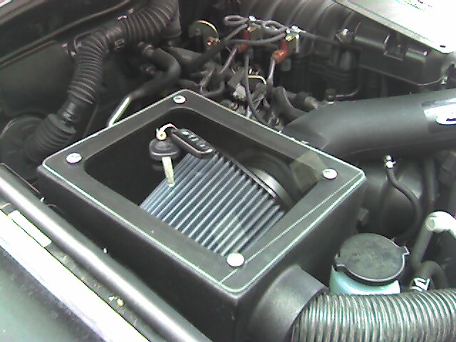

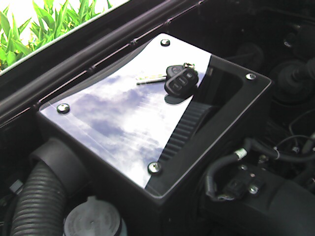

have you ever wondering "hmm... is my intake filter is dirty?" or "is there a bee/mice inside my intake box?" ........ don't worry ........ i got a solutions ........
introducing ......... SEE THRU INTAKE !!!!!!!! ............. :D :D :biggrin2: :biggrin2: :lmao: :lmao:

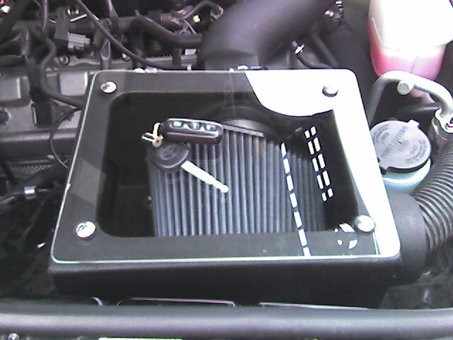

Now i can see my intake filter if it's dirty or not ..... :) :) so i don't have to open/close the original intake cover. i just made it from left over plexi glass from my computer project
Hey you got a different and bigger filter than I did!! Mines a much smaller round conical filter, not an oval conical one like you have!!! Anyone else notice this?
Yeah..? I got the same oval filter. I initially thought the 03~04 and 05~06 must have different filter, but I noticed that Ysutarko has an 05 like yours. Interesting.
btw guys. My filter seems not oiled from factory. Maybe it is, and I don't know any better. But, it looks a bit dry compared to the K&N I had before. How does yours look?

Y, that top to your box is badass. I think I want to do that....
