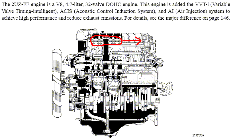

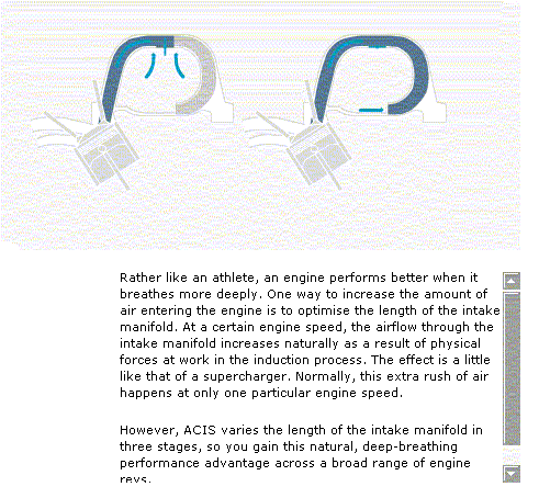

Hey everyone with '05+ V8's with the Volant CAI installed:
Does anyone notice the sound change at 4200 rpm? It seems like it instantaneously gets louder. Anyone know what this is? Could this be the VVT-i switchover point or maybe the ACIS (Acoustic Control Induction System)?
For those who don't know what the ACIS is, basically its a set of vanes that force air in the intake manifold to take longer paths to the cylinder keeping the low rpm, low load operation smooth and quiet. At some pre-determined point, under some pre-determined throttle postition this vane opens and reduces the intake plenum length so the the air gets to the cylinder more directly. As a bi-product the intake roar gets louder, and I'm thinking that maybe this could be the cause of the sound change at 4200 rpm.
I wouldn't mind knowing where the control for the motor of the ACIS vanes is located, how it works, and what rpm it opens the vanes at...
Any info/thoughts here?
