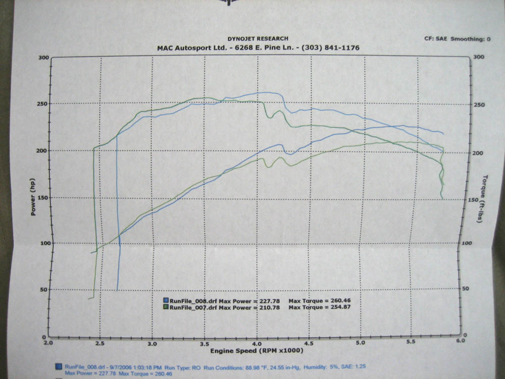

Here are the dyno proven results of the Volant CAI. Installed on an '05 Sport Edition with just exhaust being the other mod. The AFR's are at a factory 11.8:1. The gains are plotted against stock + catback exhaust.
17 AWHP and 6 AWTQ, not bad...

Pretty cool.
Wondering how these numbers would compare to a dyno at sea level.
These are SAE corrected numbers, so they'd be roughly the same at sea level. Uncorrected I put down like 150 WHP up here at 5500 ft!!
Im right on with those numbers. I love it between 3500 and 4200 rpms, its a beast. it sounds like a jet engine taking off at that level. make sure you hit us up after you run it with that new pcu your getting....
