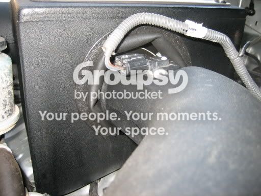

mole: The 1/8" hose fitting was too small like we said. So, I used a zip tie as well.

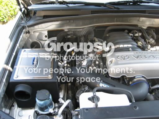

Here is a pic of the CAI installed
volant.jpg~original

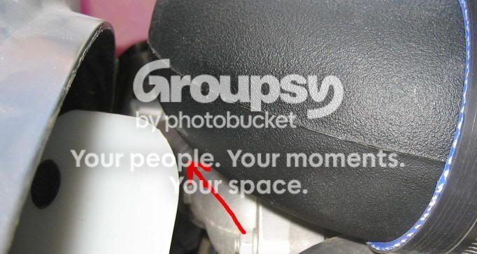

This shows the clearance (or almost lack of) at the fan
FAN2.jpg~original

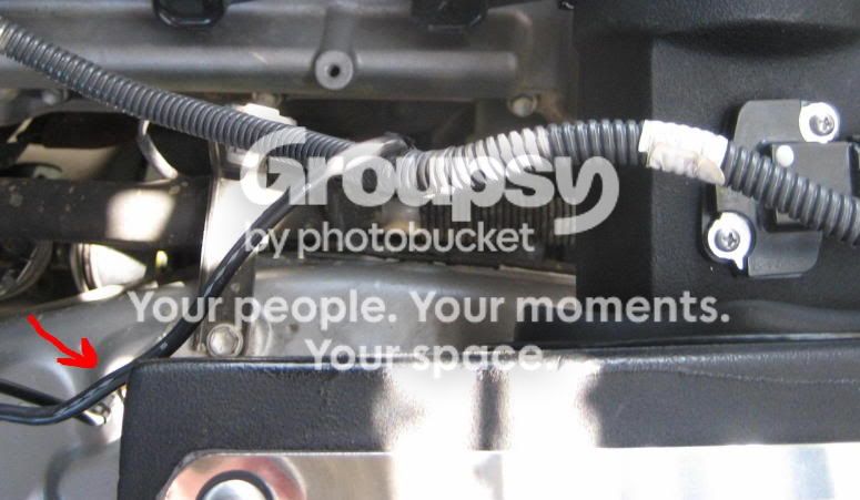

Here is where I was able to re-mount the ground from the MAF
MAFgrnd2.jpg~original

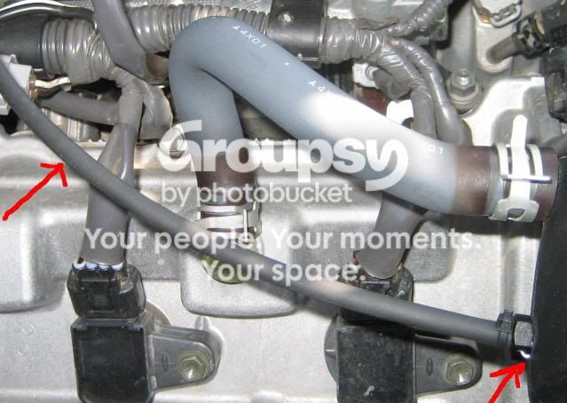

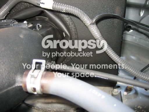

Here is a new 1/8" breather tube. I also added teflon tape to the breather tube screw in connectors. Seem too loose for me.
Breather2.jpg~original
