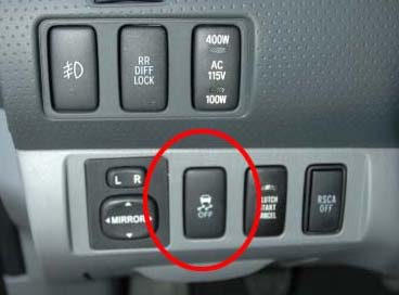

btw, would the VSC switch from the Taco work?

when I put the taco fog light switch in for my Hellas...I noticed a couple of unused wiring plugs...not sure what they are for...any chance one of these is for the VSC off switch?

But on another note, the Taco VSC button. If that were to be installed, does anyone know the wiring for it... and wouldnt you need the OEM harness (all those easy clip on clip off wires can turn around and bite you)? This would be nice, because ou wouldnt need to restart it to re-engage it.
