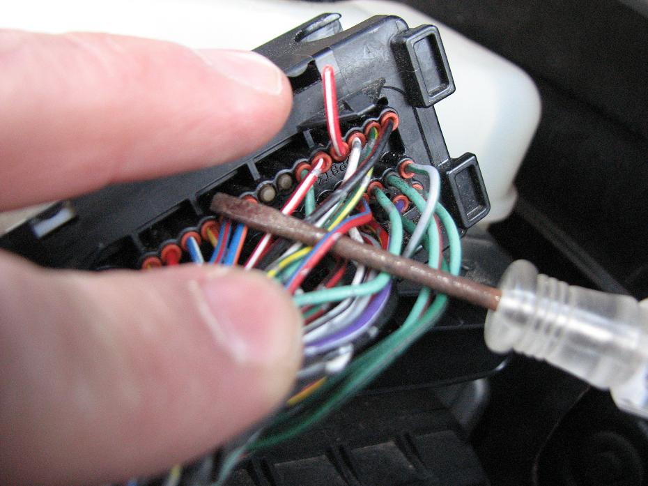

So, I purchased a used "Trac Off" switch and for ha ha's, I connected it to the empty blue connector & (breath hold...) tried it. Nothing. I confirmed that on my 4wd, the "Trac Off" switch has no effect on the condition of VSC (or any thing else that I could tell). Now on the 2005, the skid control ECU is in the engine bay at the brake fluid reservoir (I think its under the dash on earlier models???). I confirmed that the red & white wire in the connector (at position #43) at the skid control ECU is in fact the same wire at the blue connector behind the dash. The wire I needed to tap (red/blue) was at position #27 of the same connector. I simply cut the red/white wire close to the connector & tapped it into the red/blue wire a couple inches from the connector (I had to remove some of the loom & tape to tap it there). I sealed the connection (heatshrink tubing) and re-taped the harness & replaced the loom.

A word of caution if anyone proceeds with this. I originally used copies of the 2003 wiring diagram. For that year, the red/blue wire at the skid control ECU is listed at position #3 & the red/white wire is at #26. The 2006 wiring diagram mirrors what I found on my 2005 (YMMV!). Please confirm what wires you cut / tap beforehand! For mine, on the skid control ECU connector #41 is light green, #42 is RED/WHITE, #43 is also RED/WHITE, and #44 is white/green. With the connector disconnected from the skid control ECU check for continuity between the red/white at #43 & the red/white at the blue connector for the trac off switch (WITHOUT the switch connected to it).

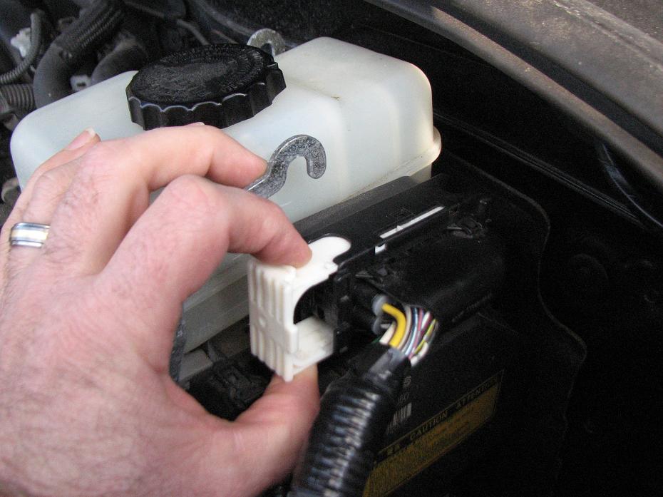

In the 1st picture below is the connector for the skid control ECU. To disconnect it, pull the white locking piece forward (about 1/2 way in photo) & pull the connector itself easily toward the fender at the same time.
In the 2nd picture my fingers point to the red/white wire I cut (connect the other end - not seen here - to the red/blue wire) & the red/blue wire to connect/splice/solder it into, the one that runs over the screwdriver in the picture NOT THE BLUE WITH RED AT THE TIP OF THE SCREWDRIVER. The black cover that snaps on (you can see it in the 1st photo) has been removed.

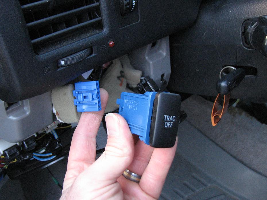

The 3rd shows the switch I used that plugs into the factory harness without modification to the plug or wiring.
SSt4r - I am wanting to do this mod and also have an '05. You didn't happen to take any pics of your install, did you? I hate to go cutting wires unless I'm sure I know exactly what I'm doing......and I don't know what I'm doing. Pics would really be helpful.
00328, I just added pictures above, let me know if that helps or if you need something else. This taps the same circuit as this thread originally described; I just tapped the red/blue wire in a different location in the truck for my version.
Awesome pics man! Thanks.
I didn't realize the connections were made in the engine bay.
So you didn't have to run any wires through the fire wall and the blue plug is sitting right there behind the dash?

I didn't run ANY wires through the fire wall. The red/white wire in the picture is also in the blue plug & yes, the blue plug is right in the dash - with the center diff. lock & a couple others.
I DID have to modify the trac off switch. It is momentary (ie: doesn't stay on) & I made it on/off - see "Martini"'s link above to convert the switch. Or just use any on/off switch.

Ok, finally got this mod done. Did it exactly like SSt4r did.
Got the switch and modded it to on/off. Not hard to do just a little trial and error. Found the plug sitting right behind the lower dash panel and it plugged right into the switch.
Switch lights up just like the other switches, looks completely factory. :bravo:

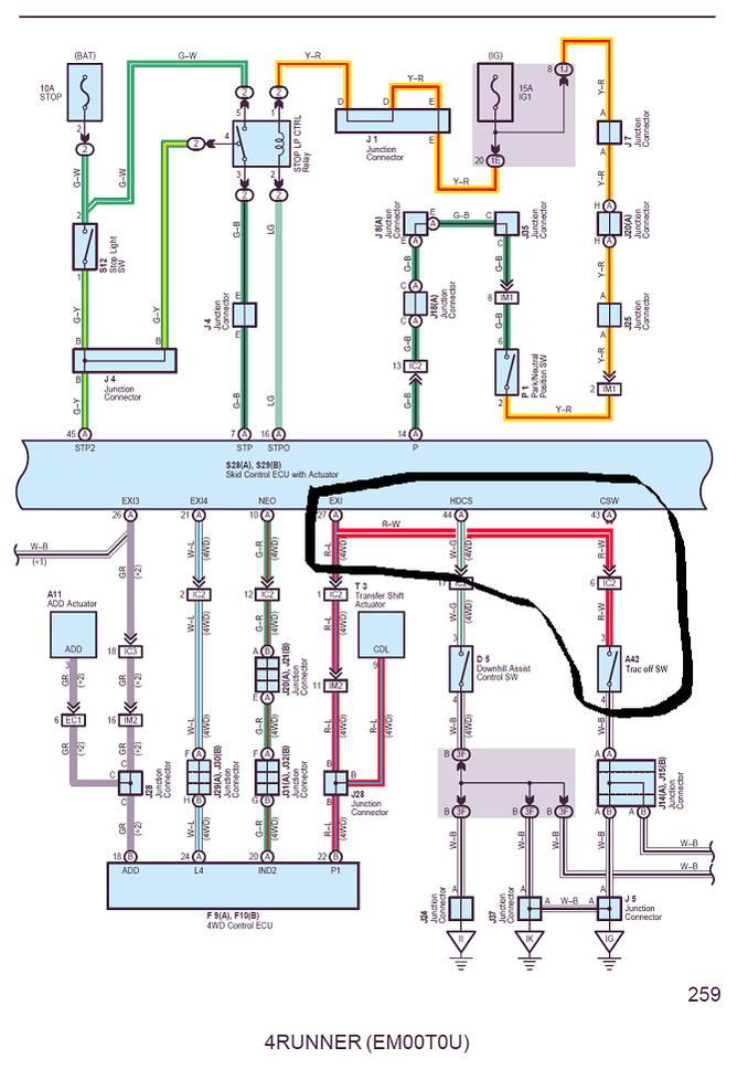

Included below is my "modified" wiring diagram of how I proceeded.
Those diagrams mean nothing but mumbo jumbo to me. It was your pics that really made it easy. Thanks for taking the time.
