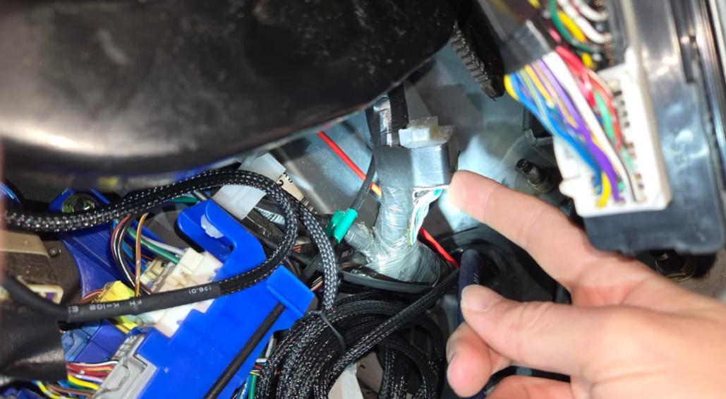

Here is the skid control ECU. It is under the dash in-between the parking brake and brake pedal. At least on our cars (2003 & 2004 V8s). The red arrow points to the plug you'll need to unplug and work with.
1103200928_HDR
Find the red/white wire, cut it and tap it into the red/blue wire.
1103200929
That's it! Once you plug in the modified TRAC switch, it works as intended. The switch lights up at night, pushing it anytime causes the "VSC OFF" light to come on.

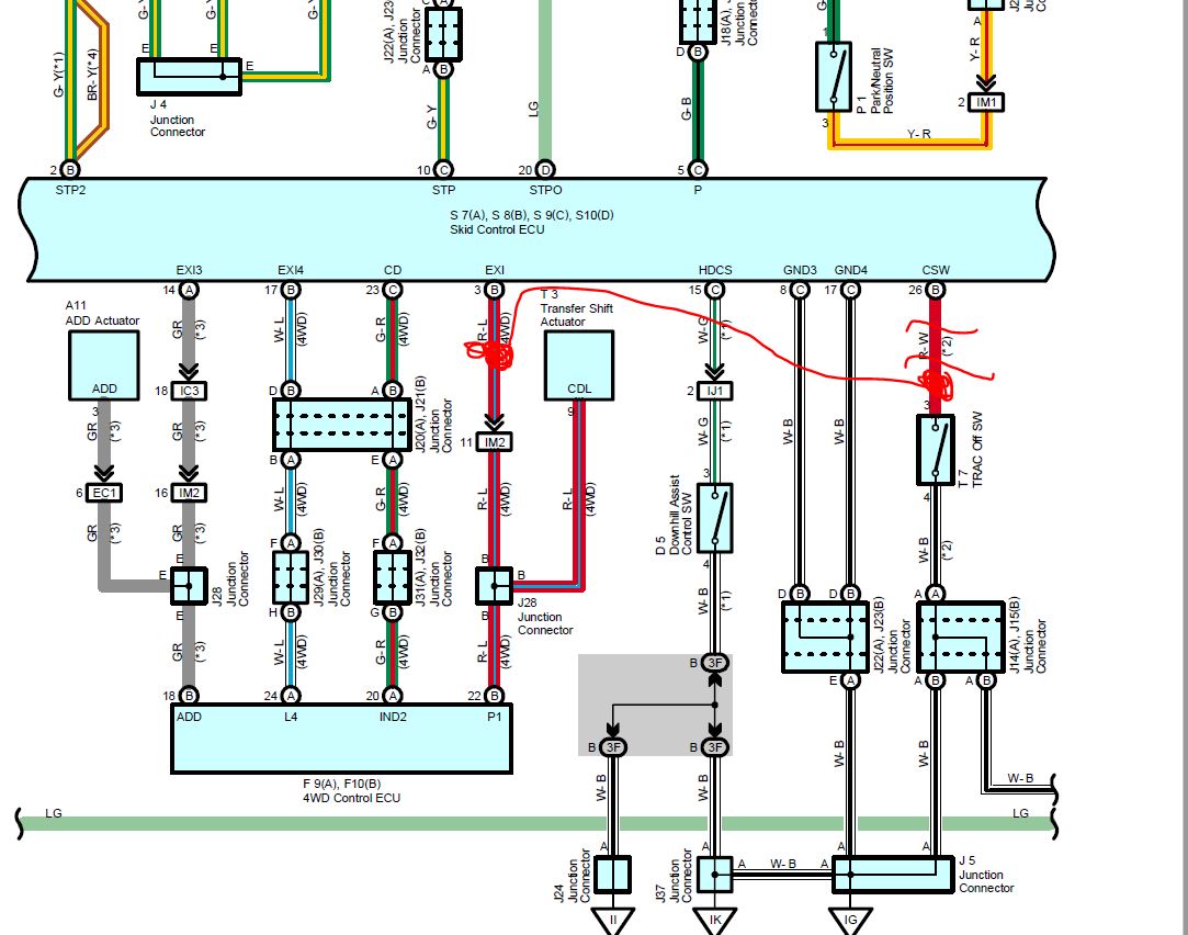

I know that some of you are talking about a Red with blue wire on pin 26 on your ECU but i got a Red with white wire on the pin 26 of my ECU as shown below from my EWD. However, more reading revealed that the wire from the TRAC OFF switch may need to go to pin #3 on the ECU as shown below. In my case, I'd need to cut the Red with White wire going to pin #26 and then connect it to Red with Blue wire on pin #3. Am I understanding this correctly?
Of course the sw has to be changed from momentary to maintained using the method described on the FJC forum.
Curious what else is needed to achieve this on a '03?
Apologies if this has been resolved already and I missed it.

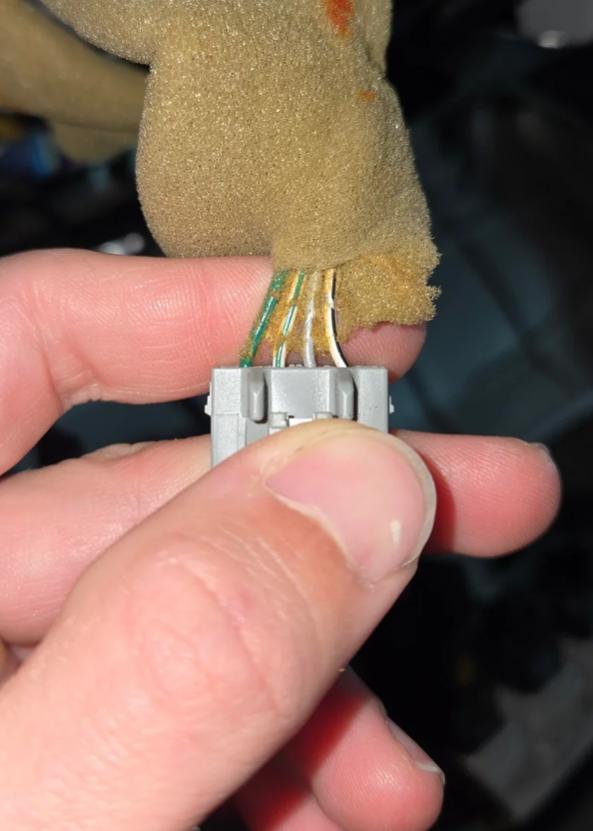

Bonus: photo one has an unused connector in the driver side kick panel above the parking brake. What was this connector used for in other models? Can it be repurposed into any of the things I mentioned above. Can I gain a feature of another model by finding that switch and connector and plugging it in?
Second photo is the connector for my original CDL switch, which the car no longer uses (due to TCase swap eliminating the CDL)
