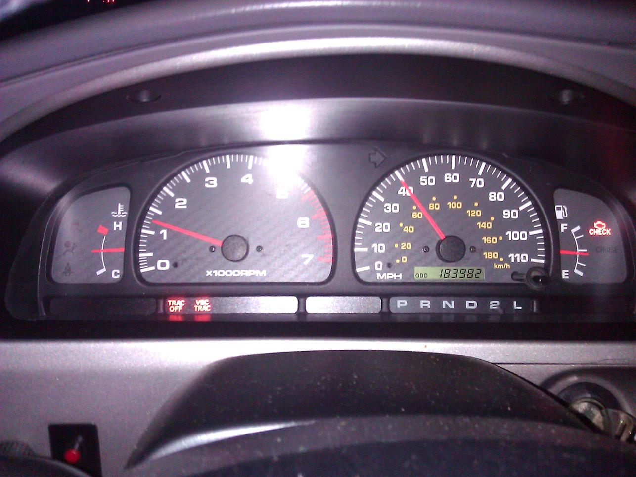

happened to me today :(

http://www.toyota-4runner.org/4th-gen-t4rs/100881-cel-vsc-lights-o2-sensor-work-around.html
Check out my work-around for this annoying issue. Basically all you would have to do is share the sensor reading from the post-cat O2 sensor on the good side.
In my case, the driver's side rear O2 sensor was throwing the code. I left the two heater wires on this 'bad' O2 sensor and took the signal wire and ground wire over to the good side.
Lo and behold! No more codes. I think this is just a bad cable or ground issue but it could be something more unethical since it brings people in for service ($$$). In any case, my wife and kid are in that 4runner now and I want it running right. There are many people that just figure the vehicle runs OK even with the lights. I personally did this for a couple years and I was caught in some icey conditions and crazy lane chages at other times. You WANT the VSC and 'posi' effect these systems give you.
Edit: I had replaced the 'bad' rear O2 sensor and it did not fix this issue. Toyota was no help. I even swapped over the O2 sensors and the problem did not track that! Troubleshooting 101! The rear O2 sensors are just there to check up on the catalytic converter. I passed emissions easily (fast test on the dyno emissions station), so I know that it is something in the harness or computer.
