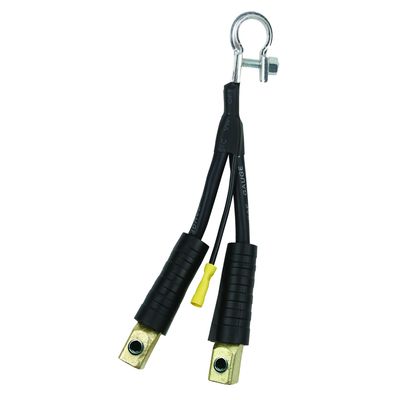

So today I had the negative battery cable repaired using a Lynx O.E/Battery Cable. After putting the battery back in, the check engine light, VSC TRAC, and TRAC OFF lights turned on and stayed on. These lights never turned on before I messed with the battery. When i put the key into the ignition initially the VSC TRAC and TRAC OFF lights would turn off but they would turn on as soon as I began to drive. I went to my nearest autozone and had them check the CEL and it gave the code of P2238. That was the only code it gave. I explained the situation and he said most likely the CEL will go away after driving 30 miles. he was right......the CEL light was gone. Now i just have the VSC TRAC and TRAC OFF lights that stay on. Anyone know whats going? If i keep driving will they eventually turn off? I never had this problem before repairing the battery cable.
