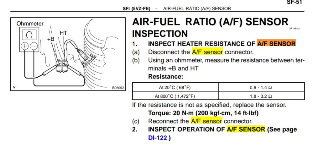

P0420 is often caused by the 2nd sensor needing replacing. It can be tested, use the FSM for complete specs/procedures. If it's ok, it may be time for a new/updated cat but that should be last to be considered due to cost.

SC TRAC/VSC OFF/CHECK ENGINE. Would like some actual answers
