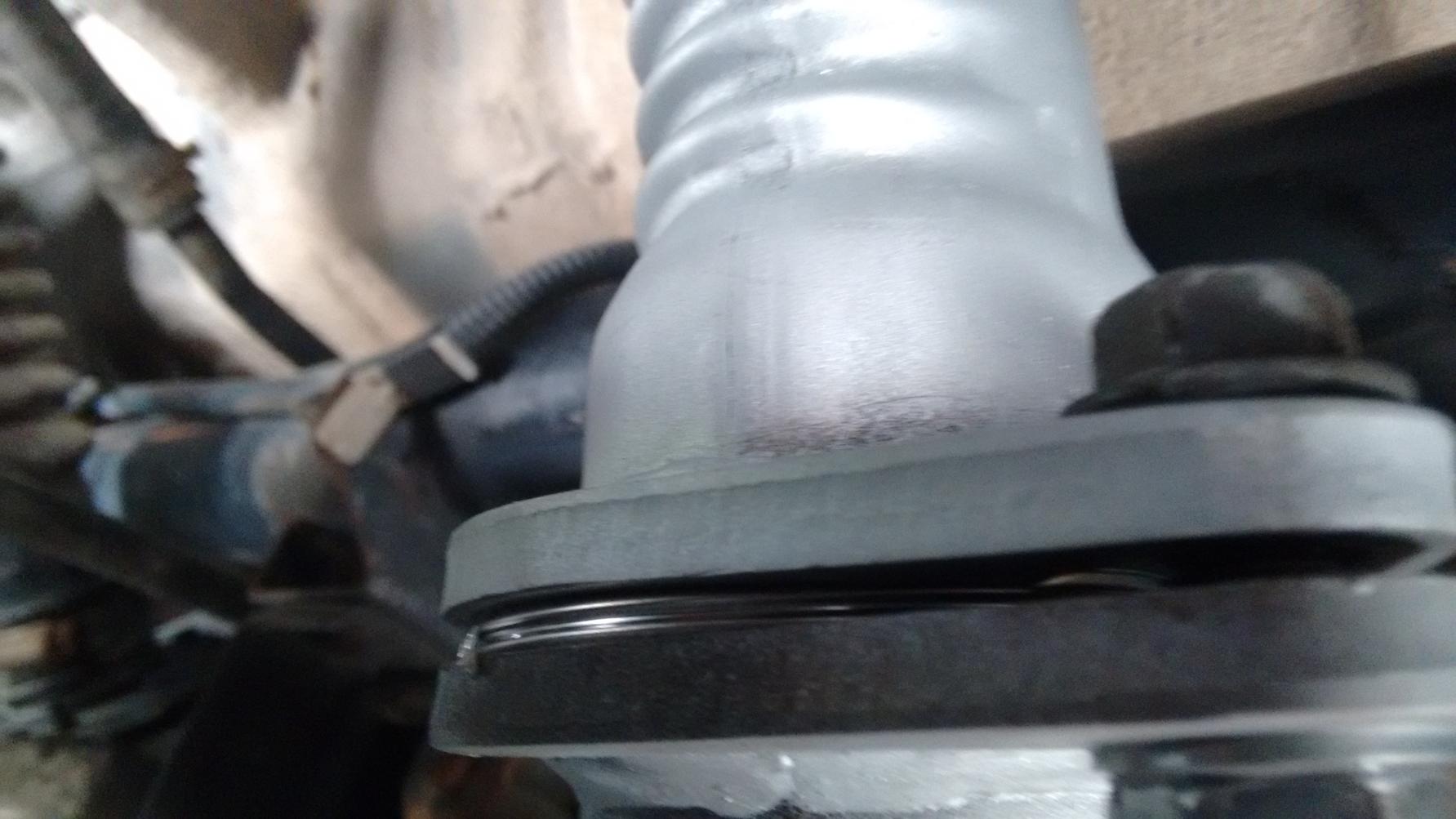

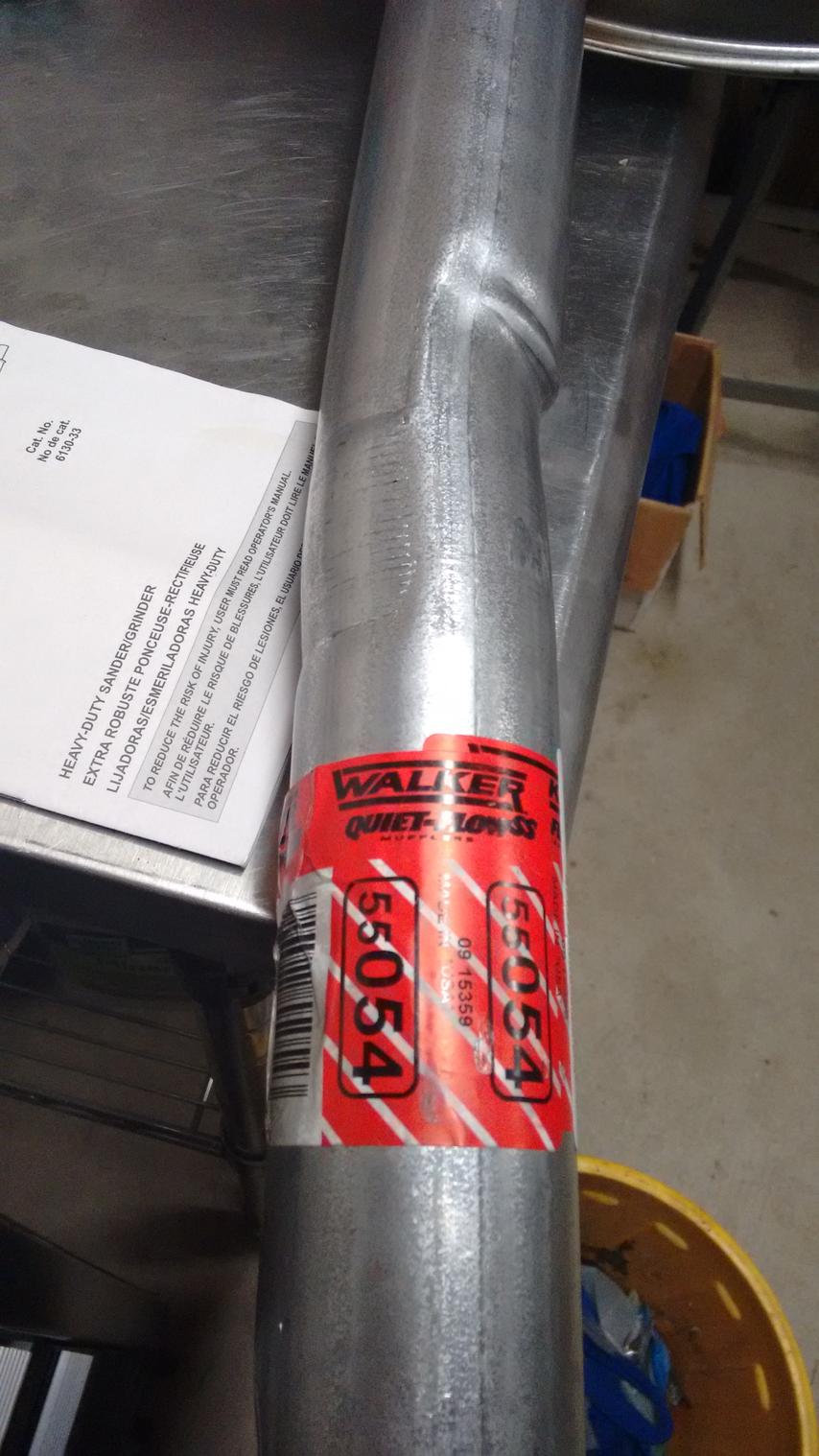

My 55054 arrived this week, along with the 54081 tailpipe. Not packed very well by Amazon, so it the muffler had a couple of small dings in it. But it does have some slag welds, along with some ragged creases from whatever jig was used to bend it. I guess I was expecting a bit too much for the reasonable price I paid. I'll spray paint with high temp aluminum and install this weekend. Will definitely use anti seize on the 02 sensor threads! Stock original is leaking and won't pass inspection next month. It's a muffler....We'll see how it goes.View attachment 193

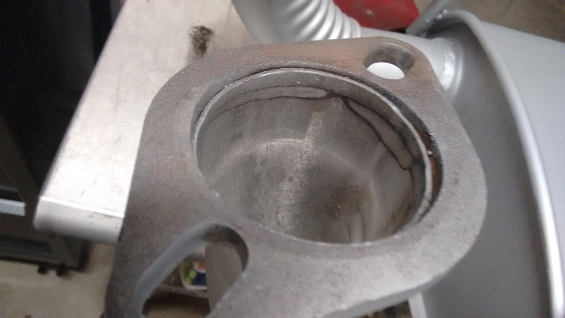

With the end of March approaching, I tried to sneak an inspection in on my 1998 Limited; but it failed as expected. Take a look at the length of the stub exiting the new muffler flange. It looks like it would be a nice spigot fit into the tailpipe flange, but there is no way it will clear the tailpipe to properly crush the gasket. I have read previous threads where some members double stacked gaskets, but I am not going to go that route. Was thinking of cutting the stub just above the gasket thickness using the Dremel. Was also thinking of taking a ball peen and hammering the edge inward so the stub slides inside the tailpipe as I torque the flanges. Appreciate any opinions or another approach if others have run into this.

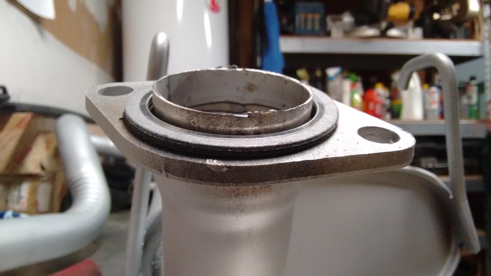

Thanks for the part numbers. Bought the Fel-Pro gaskets you recommended and both flanges fit up fine. Also sprayed the muffler with high temp aluminum paint prior to installation. Hoping it will last for several years. Back to the inspector on Monday.

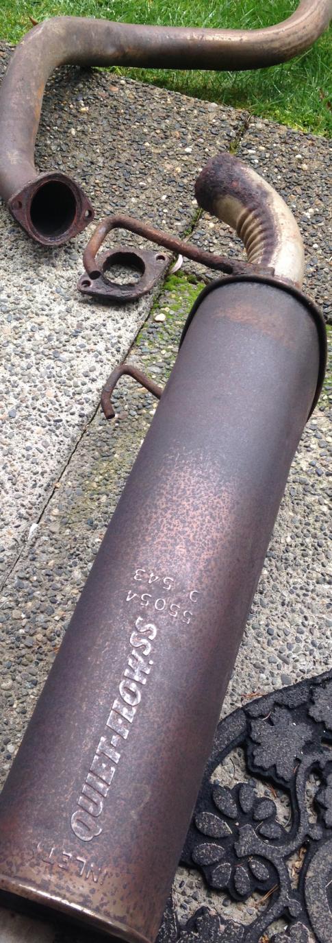

I purchased a Walker 55054 online, eBay or Amazon, in Feb of 2016. Lost the receipt. Attached is a picture of the rear flange area which rusted out and separated from the tailpipe. 4 years of use in wet & snowy Washington state.
