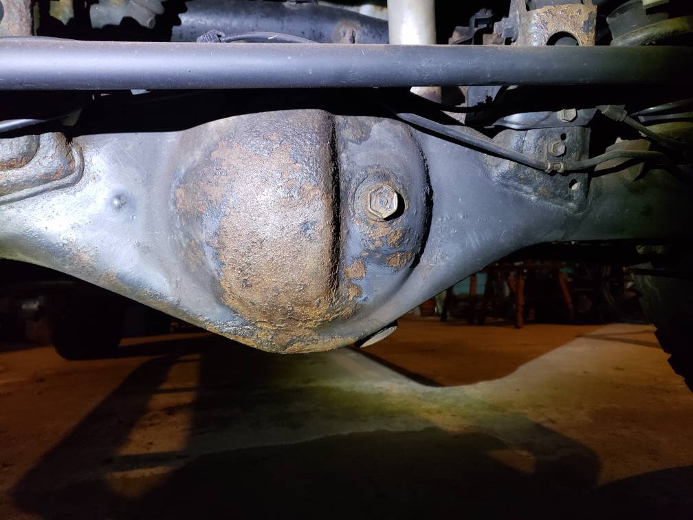

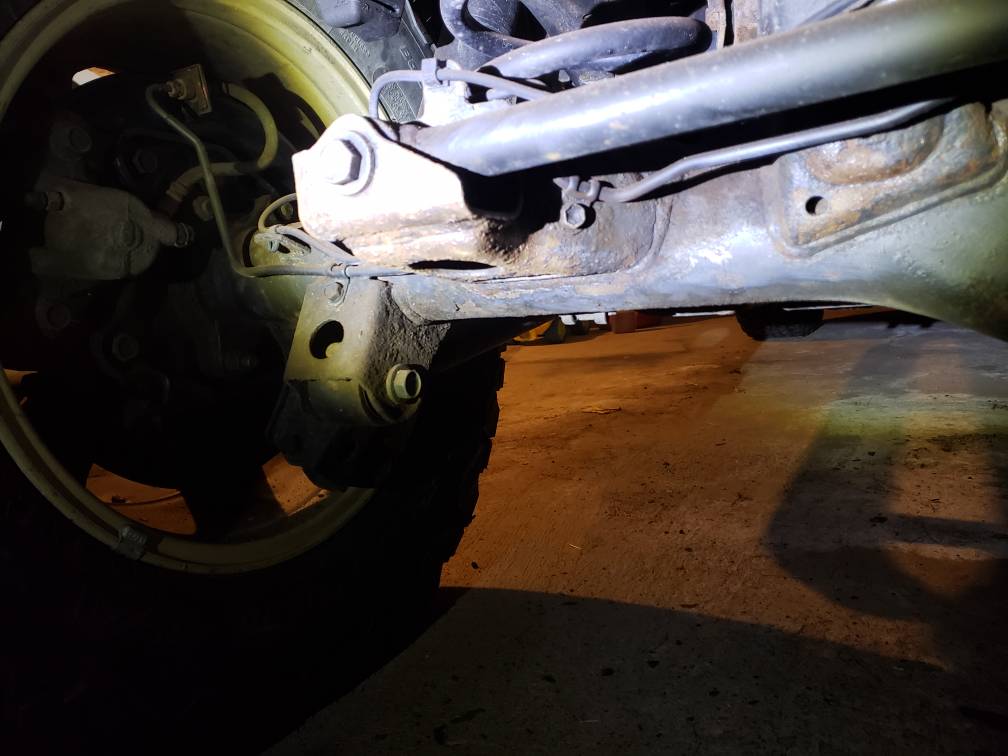

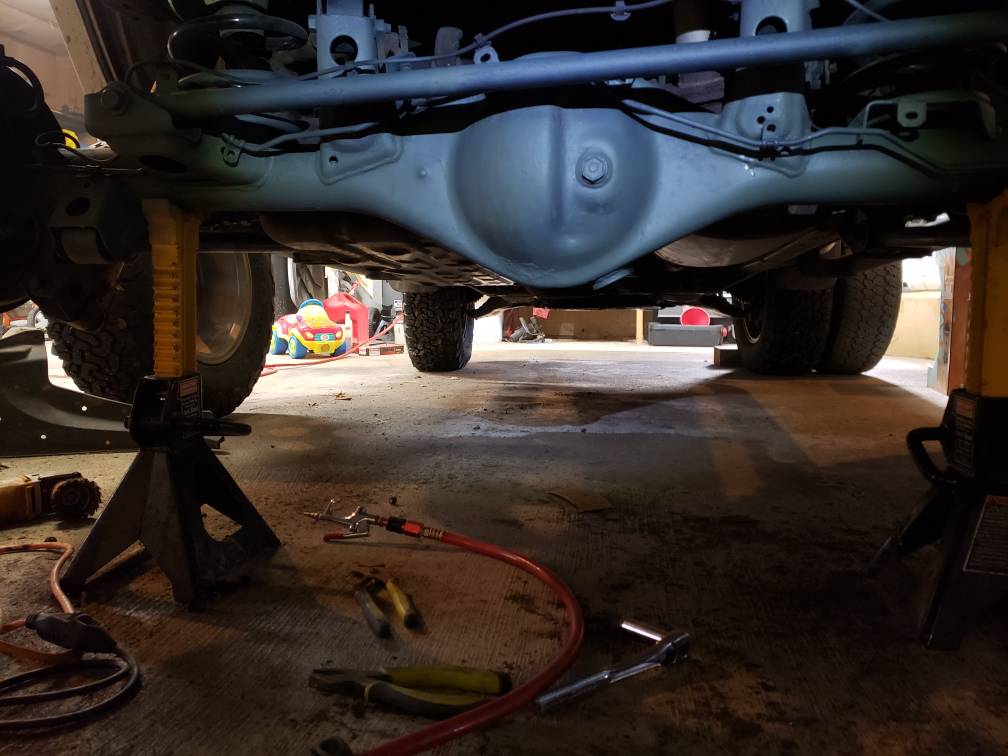

I don't post much but I figured it time to say hi. I've owned Wanda since she had 2 miles on her. 10 wonderful years later she's starting to show her age. I've brushed her down and painted her before but I've let it go too long. I've decided it time for a full sand down and repaint. Then I'm going to coat the frame. I shouldn't have waited until winter but better late than never. This is going to be a long project but it needs done.

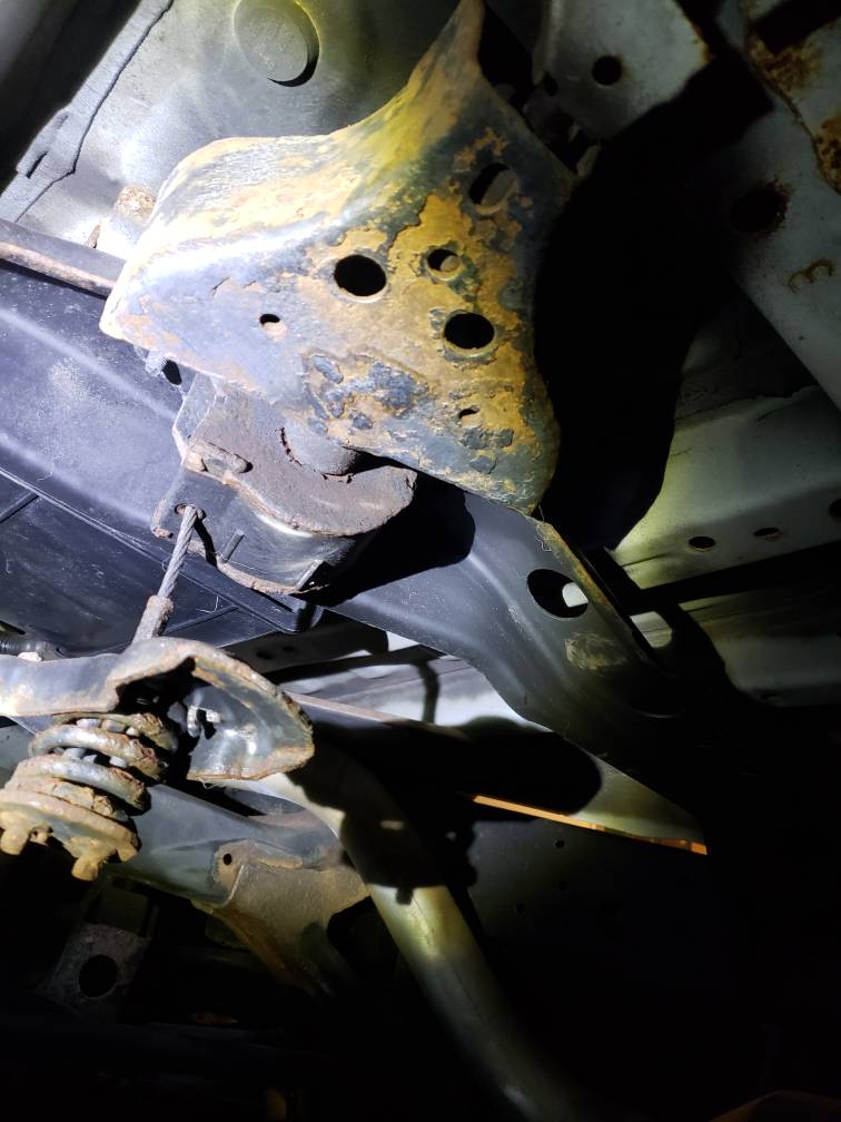

It was a lot worse at first but I didn't take pictures until I started. I started with a wire brush and quickly said F that. Then I broke out my drill and a wire wheel. Progress was happening but this is still going to be a long project. Luckily she isn't my daily driver and snow isn't in the forecast.
I'm debating on using an angle grinder and an abrasive pad as I've killed 2 drill batteries in an hour. Thoughts?

I wouldn't have even tried a drill, an angle grinder will be so much better.
You could use a wire wheel attachment or they make paint stripping 'sponges' that might work well too. Buy plenty and have at it.
Wear some face protection at least if you use the wire wheel, from my experience sometimes the wires like to fly off.

I started with what I had. All I could find at first was my trusty wire brush. After wanting to kill myself I found an old wire wheel. Tomorrow I'm going to make a trip to harbor freight for an angle grinder and disc set. I've been working a lot so this could be a long process. I just purchased a fluid film set for when I'm done.

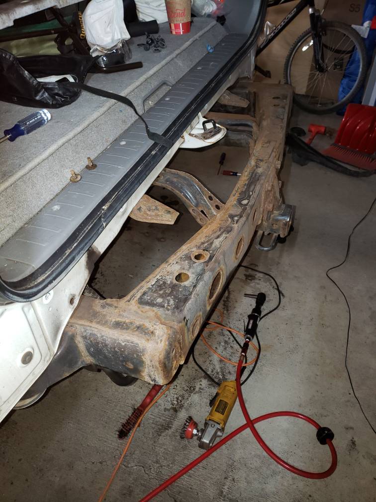

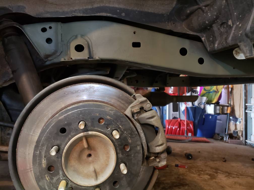

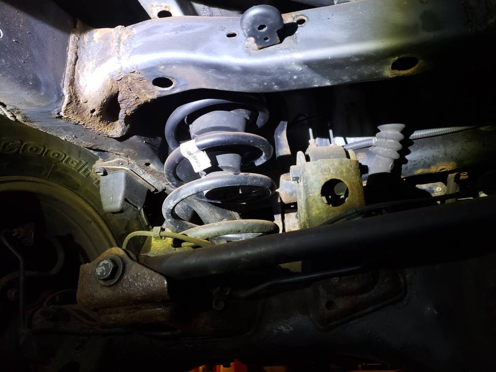

I initially used my drill with wire brush because it's what I had. I decided to start late at night, nothing open. I then went to harbor frieght and got a cheapo die angle grinder and some 2 and 3 inch pads. They seemed to work well but the angle grinder had a leak and sucked. It went back and I have an Ingersoll Rand on order. I then picked up a braided wire wheel for my 4.5 inch angle grinder. That did the fastest job but really can only get to the main sections that are open. When my new die grinder comes in I'll use that for the smaller areas.

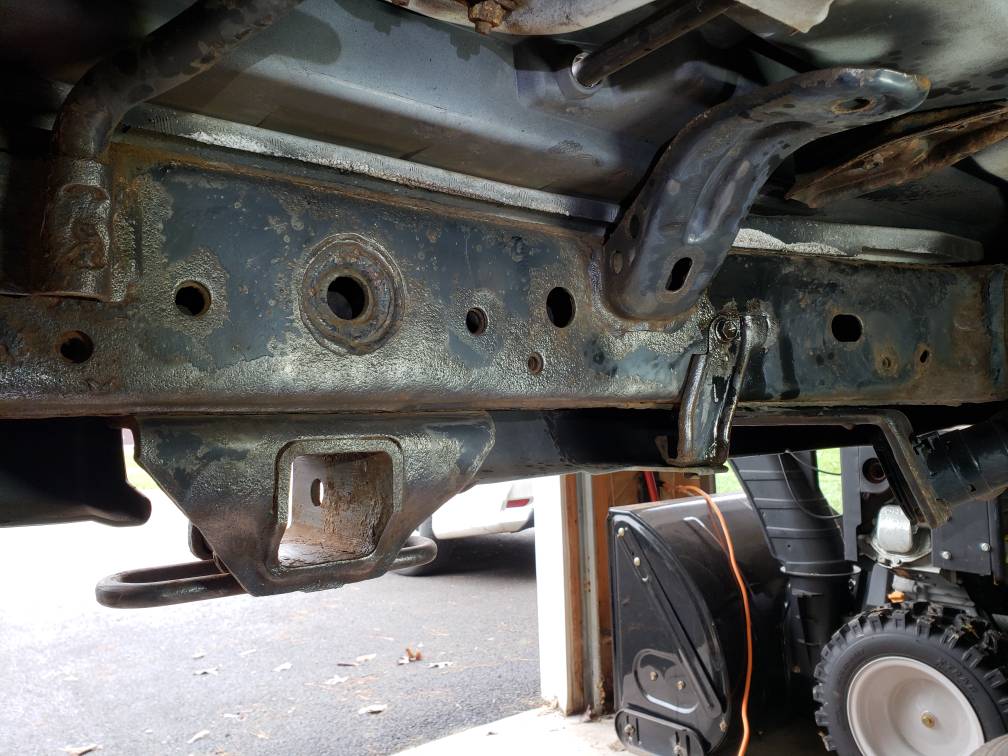

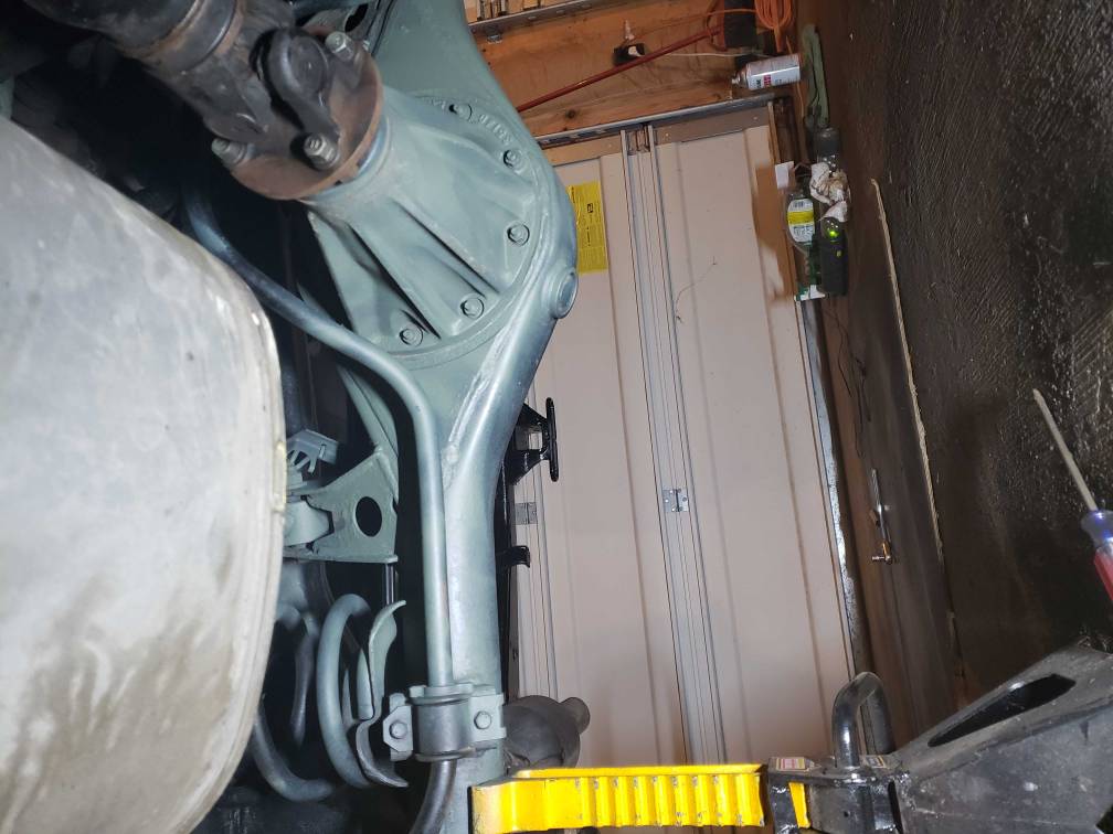

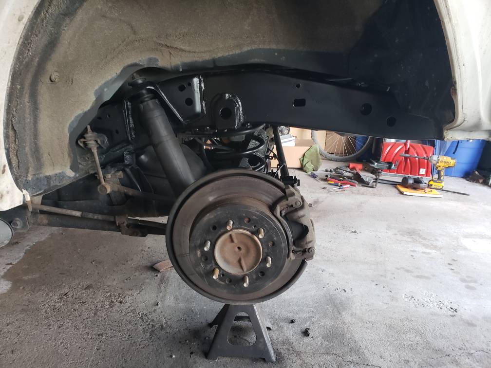

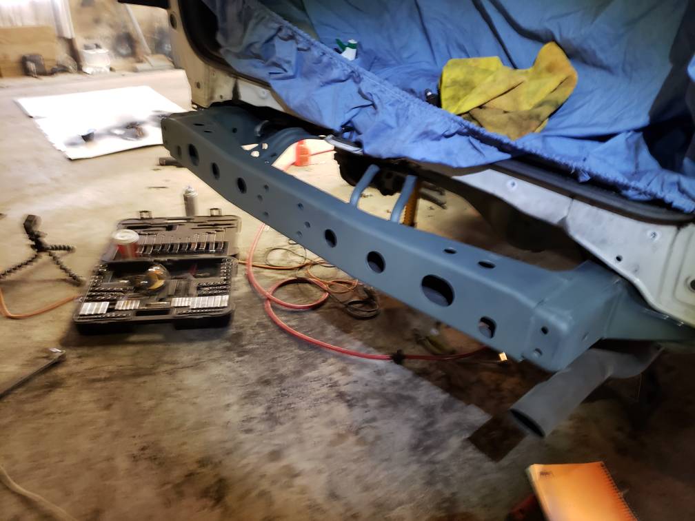

I took the bumper cover off and did a ton more grinding. I finally got from the axle back decent and put down 2 coats of metal primer. Sadly broke a few bolts l, nothing that important. Once I finish this part I think I'm going to jump to the front and clean that up. This middle of the frame is pretty clean but I will eventually do that.
Sent from my SM-G960U1 using Tapatalk

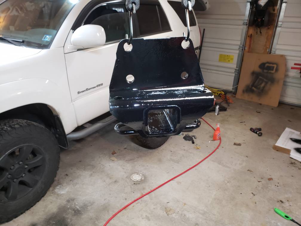

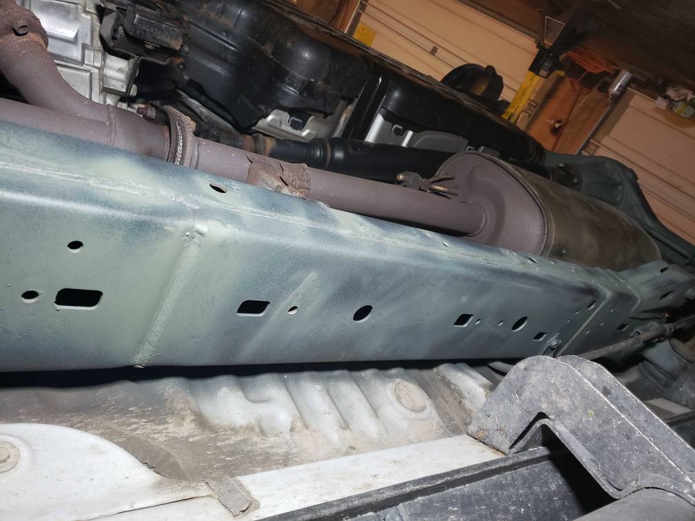

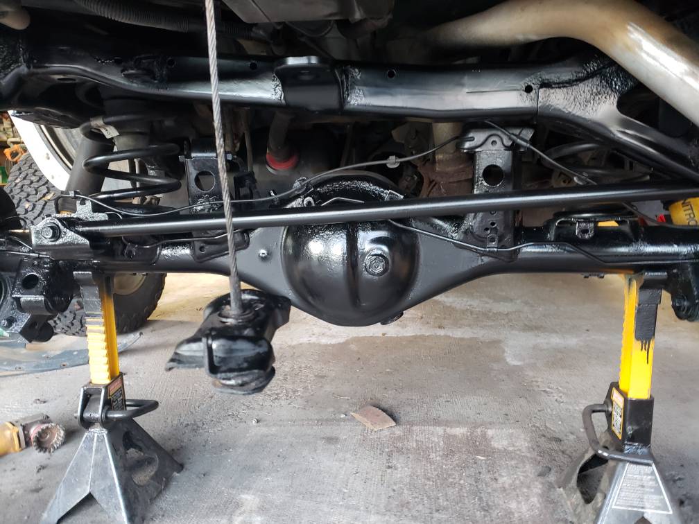

2/3 coats or primer and 2/3 coats of paint. Turned out well. I'm just waiting on my sprayer to cost it with fluid film but I'm going to give it a few days to cure. I wont be able to do any more work until next week and I'll see what's next.

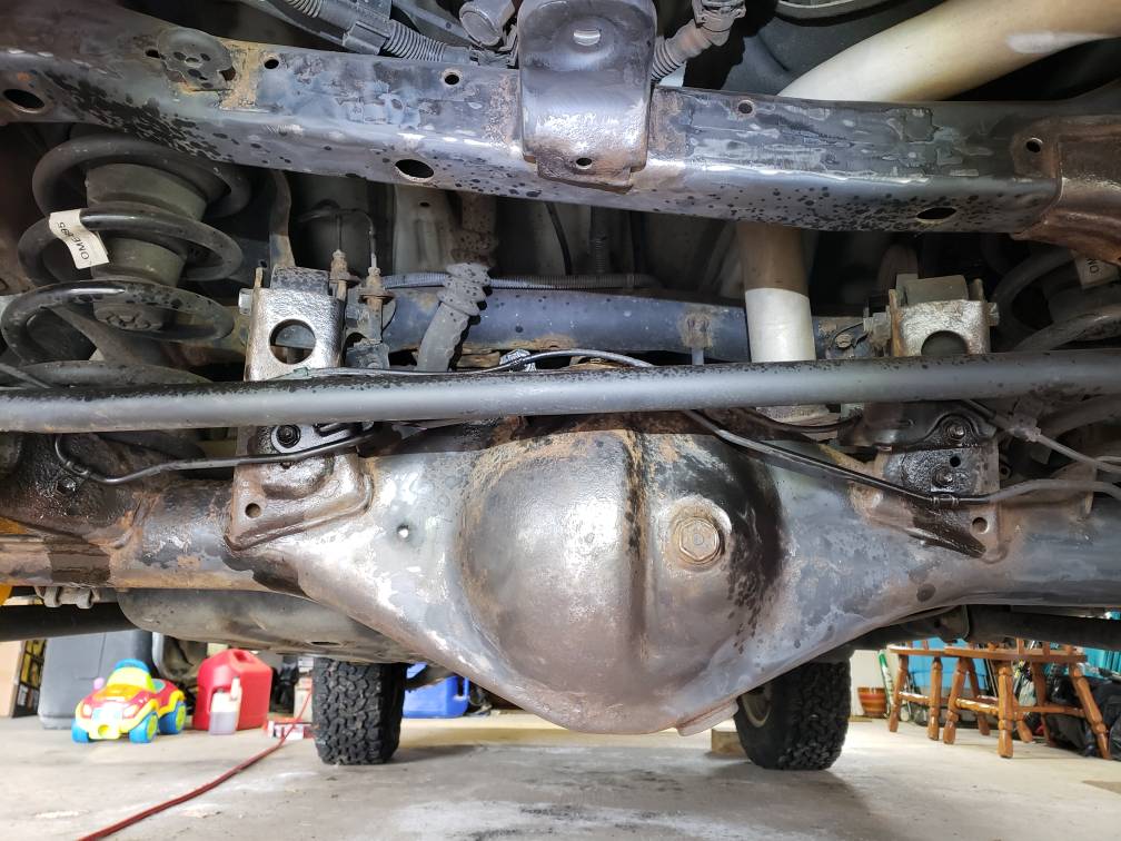

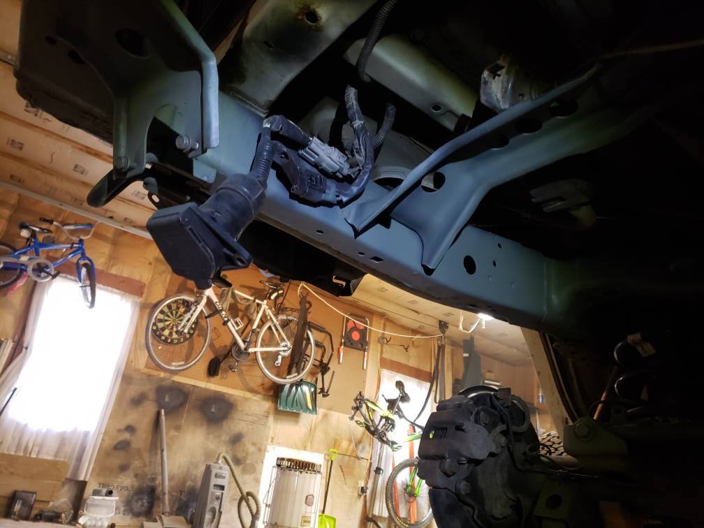

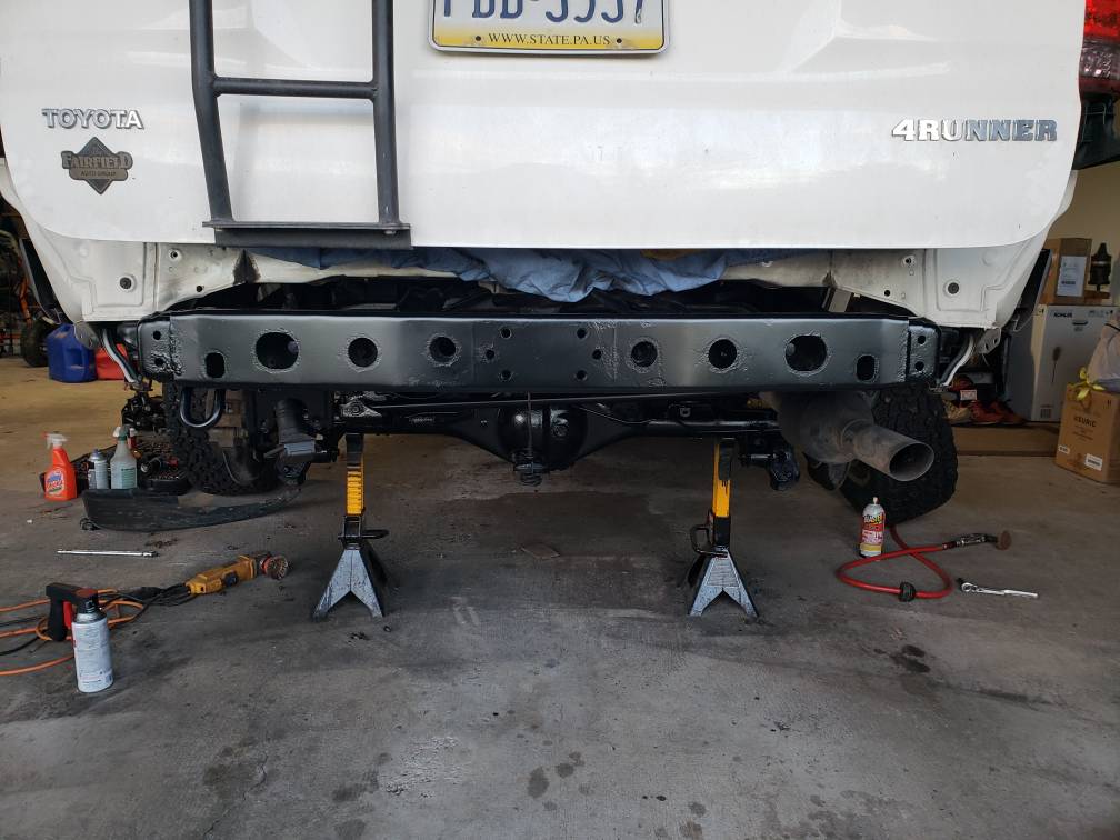

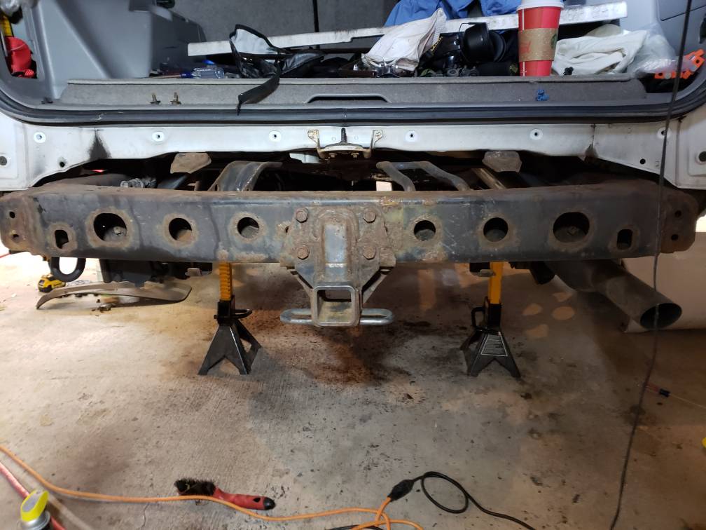

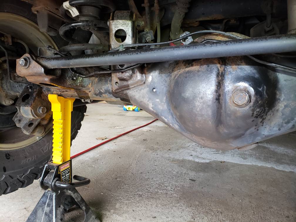

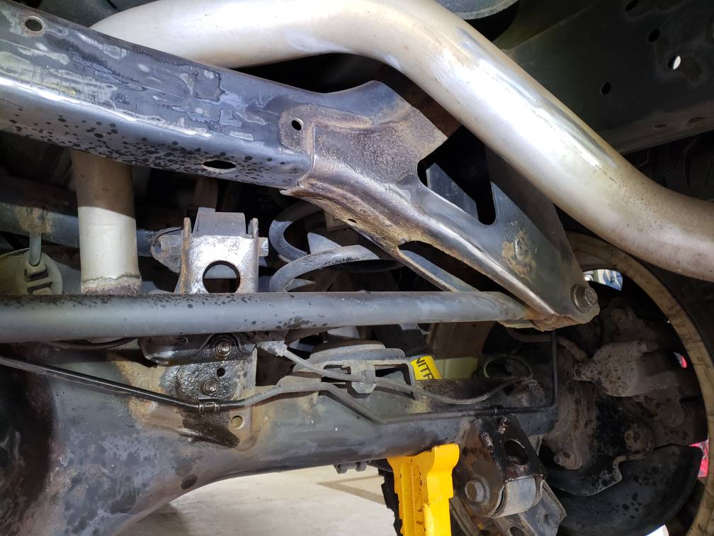

I've gotten lazy. Temps are dropping and I haven't had much time. I've started on the front half of the rear end and the passenger frame rail. I can't find a good way to get and the exhaust it gas tank. The side frame rails just have some surface rust on the welds. I want to fluid film The rear bumper but little too my knowledge that stuff thickens when cold and I need to get it to melt.

Looks way better now, that frame is in capable hands.

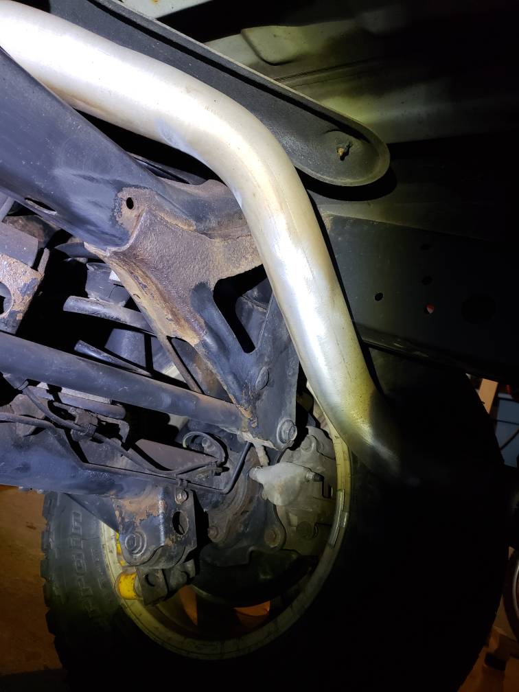

I've clean up rust before, just never to this extent. I would take it a few steps further but I don't have a lift and I need her back on the road asap. I just wish I could get into some of the tighter spots.
