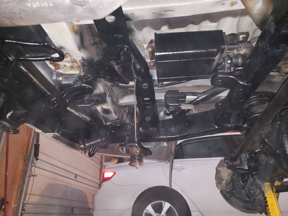

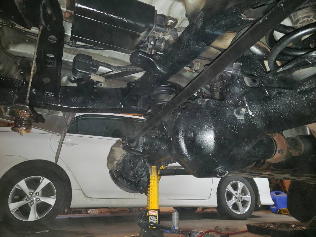

The rear is done. I'm working on passenger side but that's nearly done. Next 9s the driver's side then the front. I thourouhly coated the inside of the frame so far.

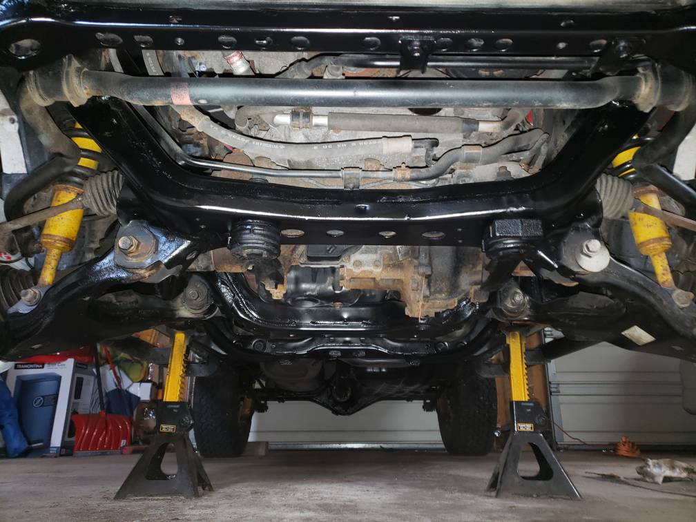

Just starting the drivers side frame rail. Grinded down and 2 light coats of primer. In only focusing on doing to the cross member right now. Then I'm going to put the rear wheels back on and focus on the front.

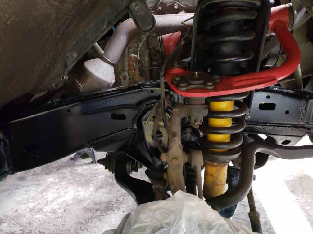

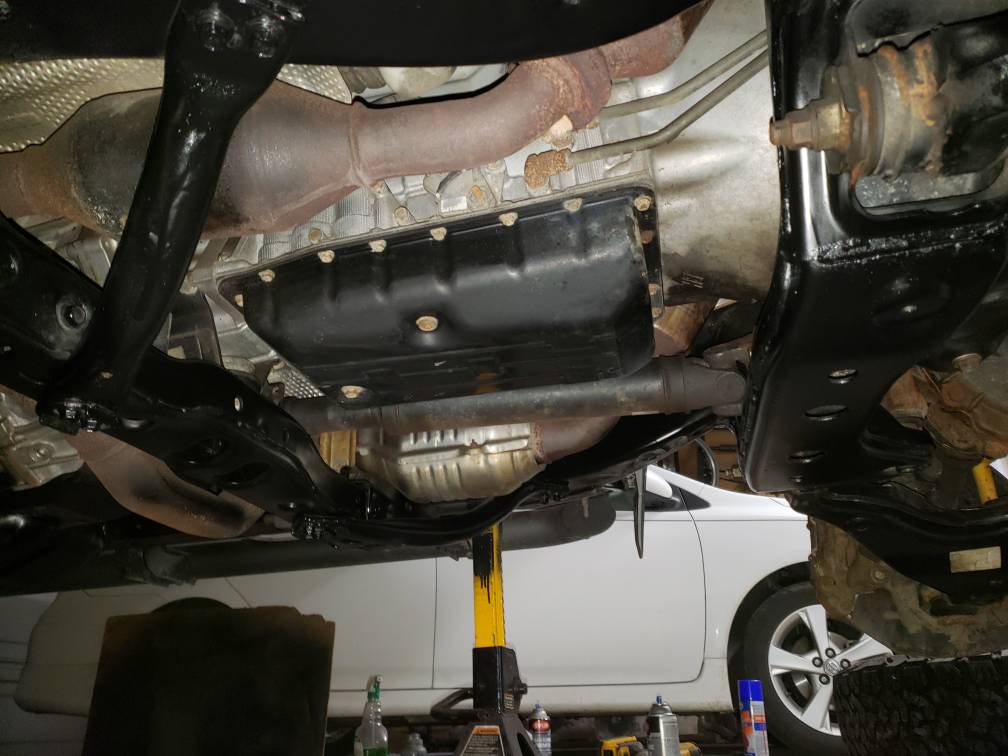

The sides and rear are done. I started on the front. Most of it looks good. The only areas with a decent amount 9r rush is the front support which I didn't start on. Some of my skid plate bolts are being a pain and I don't want to break them so I keep soaking them in penetrating lube. She was dirty. These pictures are after cleanup. My JBA arms were black. Can't remember when I last washed her, probably at the start of college football because I'd take her tailgating.

I finally quit. I cleaned and painted all I could reach. Then a thick coating of fluid film. I hope it helps, others say it's great. It was a lot of work but I'm glad I did it.
