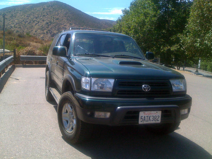

Wanted to change bulbs in my clear corners
kavalis
Would the Amber LED’s be the way to go? Looking on the Sylvania guide. Are they called the Parking light, Driving light or front Side Marker or Autolumination are they the Running Lights under the Headlight section? Would the LED’s be better than the Sylvania Blue tipped amber bulb thats in there now?

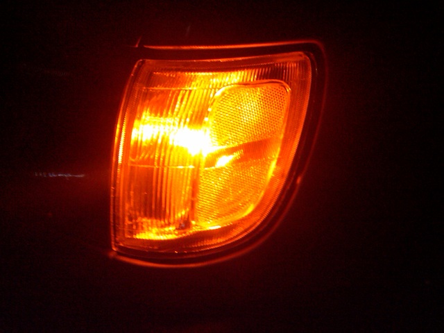

The Bulb is a 194 bulb check out my build thread below in my retrofit section to see them in action. If you plan on getting any HIDs or colored headlight then I would recommend getting a white LED bulb, the amber reflector still shows amber from the side while a nice white emmits from the front.
I'm looking for some switchbacks that will emit amber with the parking lights on, but a white when the headlights are on. Good luck!

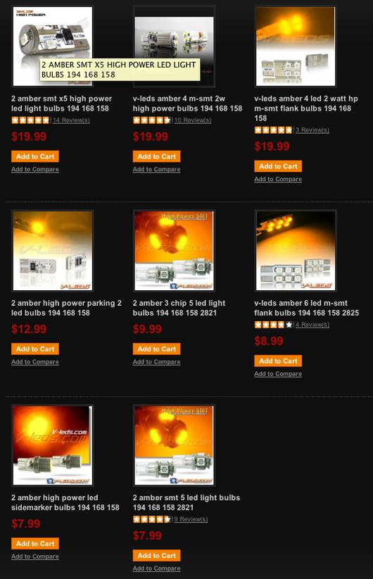

yeah i think the Sylvania guide uses different numbers, I hate that guide, it makes finding bulbs a little troublesome sometimes. but if you notice on your link they are the same bulb. (194 is listed under the 2825) And i cant even find the bulb that i got from VLEDs, they must be out of stock or something. Im glad i got an extra set haha! anyway, it's this one here

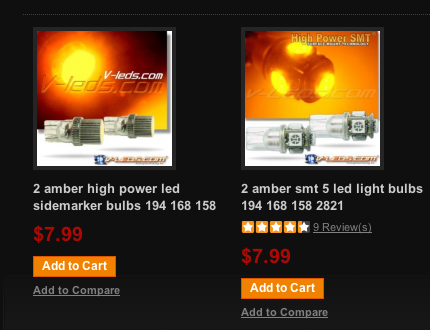

Which one would you pick? Maybe the middle one w/3 chips?

yeah, ive got the middle ones with the 5 or something bulbs in my licence plate lights and they are a perfect amount of light
003.jpg~original
as for your corners depending on what brightness you want like if you want a running light or something ive read good reviews on those $20 ones, but i think the 3 chip one would be fine too.
