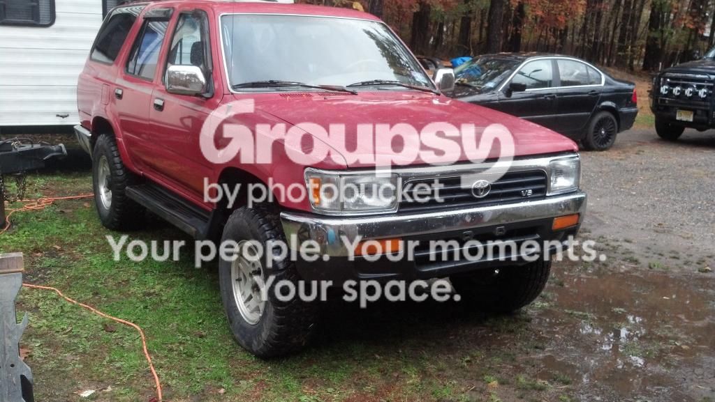

Hey guys, New 4Runner owner with a question. I picked up a 92 4runner 3.0 auto with 125k miles for 475 bucks. Busted T-Belt. Anyway, I have a question about manual hubs. Will this Warn kit work with my truck? also does anybody ever use them? My Dad has warns on his diesel and he likes em. Do I need a locknut conversion or anything?

Here is the Pig when I bought it
