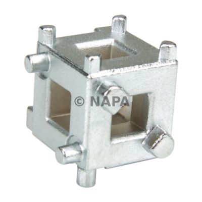

all you really need is this guy :)

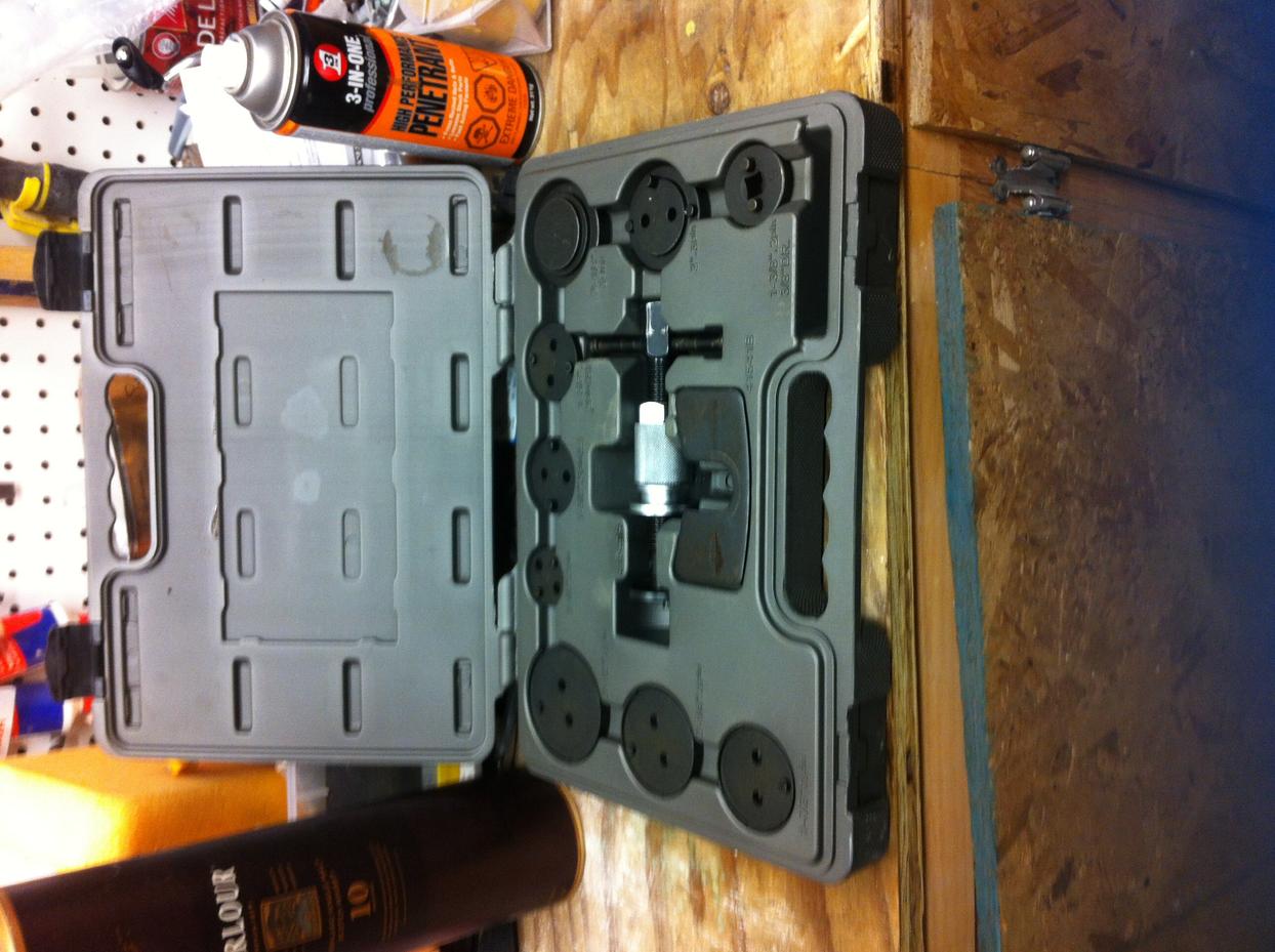

This is the tool I use for rear brakes.
Sorry for Cell pic...

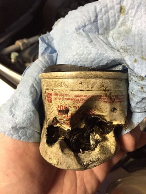

In other news here is a CRV filter I just destroyed getting off. ImageUploadedByTapatalk1440767809.739857.jpg
