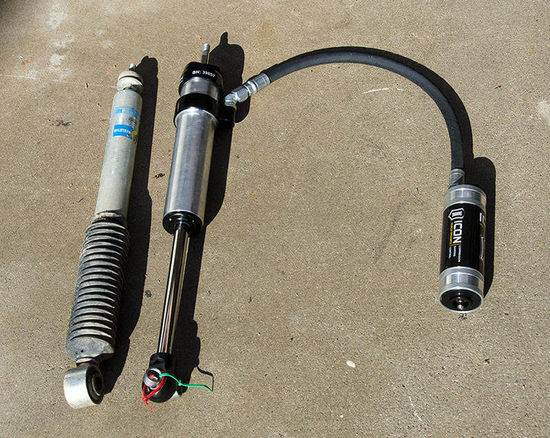

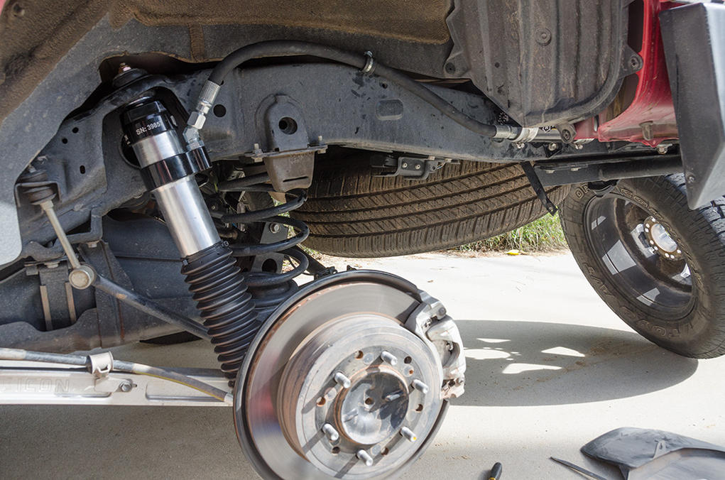

Finally got time to install the Icon 2.5 adjustable rear resi shocks. A job easy enough even I could do it! Or so I thought...
Install:
* Use floor jack to jack up rear corner to let axel droop
* Take off wheel
* Use bottle jack to push up on the bottom of the shock mount a bit to release pressure on the stem bushings.
* Unscrew the top nut on the shock.
* Lower bottle jack again.
Now how to get the shock out? The stem at the top is trapped in the shock mount, the bottom wont come off because of the angle of the shock putting a lot of pressure on the bushing at the bottom hmm...
* Use crowbar to wedge the bottom about half way off.
* Use a light weight ratchet strap around the top stem and using the exposed hole of the bottom bushing and ratchet compress it. Viola!
Here is the bilstein next to the icon:
So then putting the icon in is basically the exact opposite, also using the strap to compress it (Putting the adjuster on "S" (for soft) makes that really easy)

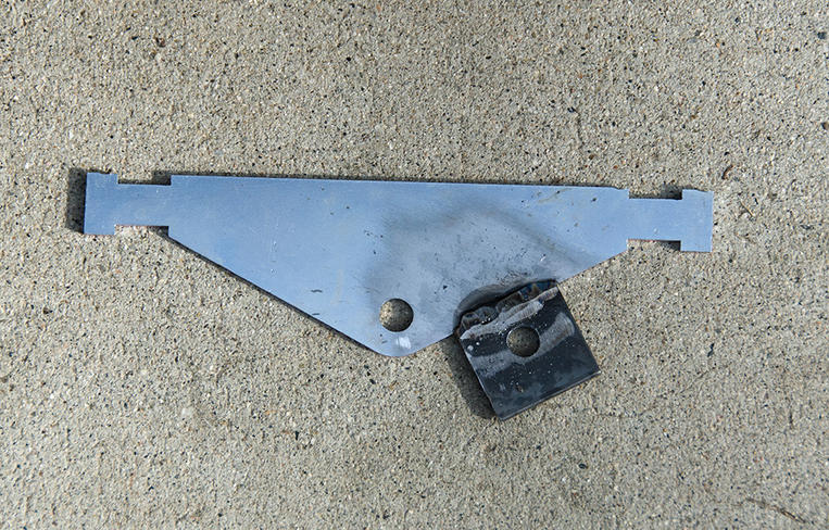

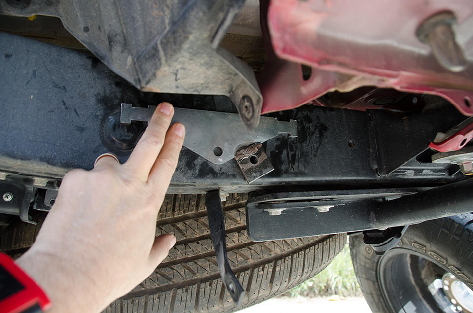

At that pint I now need to install the resi itself using the bracket that came with it. There is a hole almost in the right spot... Almost:
Love having the MIG around for this kind of thing. The bolts supplied didn't fit but I've removed so many stock items from the car I have a ton of stock bolts in a tin to use for things like this.
Painted up the bracket and got the drivers side one done! I bought the 2.5 boots for it from ORW on the way home from work one day.
So with tire reinstalled it was time to do the Passengers side. It went really fast except when it came time to mount the bracket again. I had already welded on the extension assuming that the left and right side of the frame would be identical. HAHAHAHA!
Turns out that the built into frame mounting holes on the Pass side have no nut! ?!?! Ugh. And they aren't in the same position either. But about 6 inches away is a small access port with a plastic cap (Can be seen just under the hose connection on the resi in the above picture)
So... I carefully welded a nut to a clothes hanger, removed the plastic cap and had a friend position the nut behind the empty hole while I threaded it. Worked like a charm, cut the hanger and stuffed it inside the hole, cap back on.
Pass side done! Just another case of a welder making things SO much easier when unexpected things come up on an install.
How do they work?
Well I haven't had them out in the desert yet to really try them out. I was up at Big Bear doing some rocky trails, mostly slow stuff, not a lot to test the shocks out. SO mainly just street testing so far.
With the adjuster all the way to H (Hard) they seem to dampen down force close to the same as the Bilsteins, though not really hit them hard yet. However the rebound is WAY better than the 5100s which made my back end really bounce when I went over something that compressed them a lot.
Honestly I was hoping that the hardest setting would be a bit harder than the Bisteins, but happy with the performance driving over big dips and humps transitioning from street to parking lot that you get sometimes.
All the way at the S (Soft) setting, it's almost like the shocks aren't there :D Well not quite, but super soft, the rear sway is very noticeable, but I really need to be out in the desert hauling ass over rough terrain to decide where I want to be between the two extremes. I'm keeping it on H on the street though!

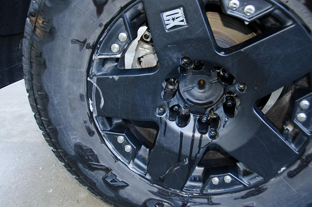

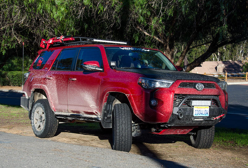

Kind of looks like I drove through a giant puddle of paint! Ok, no damage there, already washed it all off.

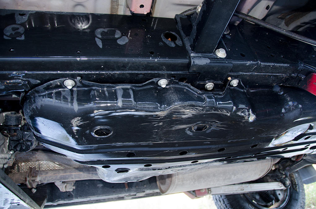

Gas tank skid... pretty well pushed in there. In the center it's pressing against the tank itself. This thing is useless. It may be the most important under armor needed so that's going next on my list of upgrades. Meanwhile I'll have to take it off and pound it out.
Yowch! I didn't even notice all the scrapes around the rim till I washed all the "paint" off. Ugh, I hate these wheels, not made for "wheeling" at all :(
You say it's useless. I say it did exactly what it was designed to do. But yes, that will also be the first of my heavier duty skid replacements simply because that part seems to be the lowest hanging and gets dragged more than any other part of my underside.
Ha, yes, I guess it did a valiant job for what it is :) I was at one point resting the entire back end on the skid there!
I also got a very small scrape on the ring around the diff drain plug. And some new scrapes on the front skids but nothing a little paint wont cure :)

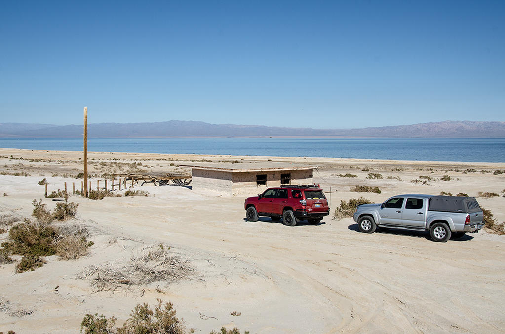

I took my 2wd friend out for some more sight seeing so nothing too tough. irst stop was the Salton Sea Test Base Salton Sea Test Base From Escondido to the SSTB is about 2 hours.
Next to one of the frequently flooded test buildings.
Part of the old PBY dock
Another test building further down the beach. Top mount was probably a radar of some kind. Had a lot of big power conduits going to it from the inside. Had a plague that said "Askania Pedestal"

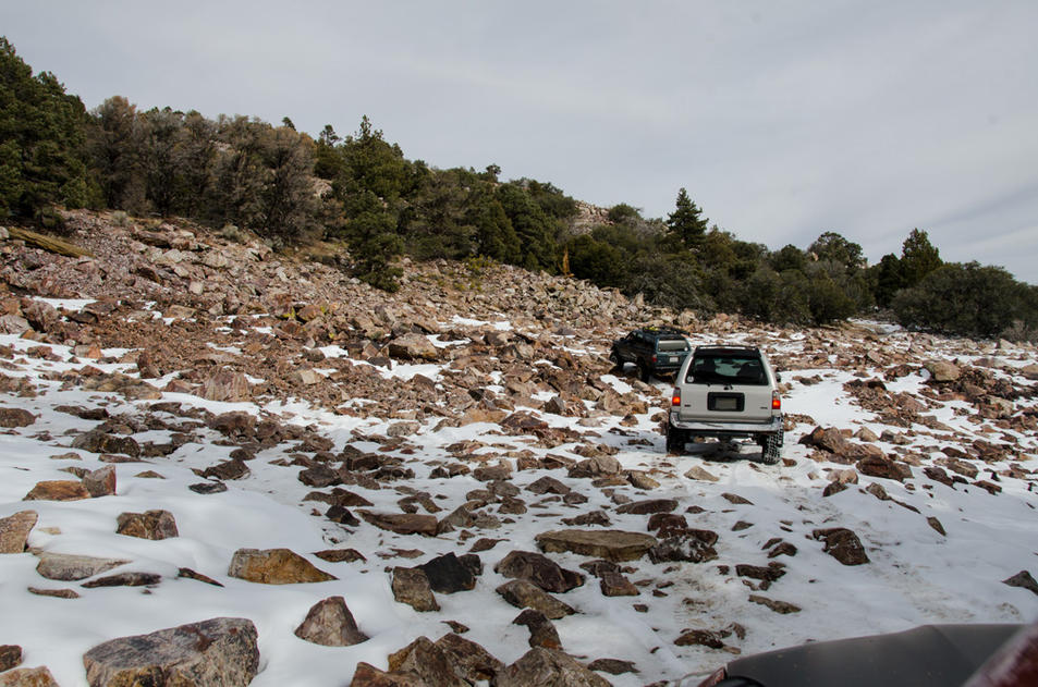

A major cold storm, rain and snow was heading in the day we left. I skirted around Julian taking the Ranchita way back to avoid driving through too much weather. Only sprinkled a little. I parked outside when I got home and the rain over the next two days washed a lot of the dust off :)
