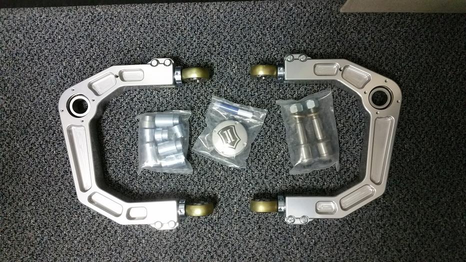

Woot! These showed up in the mail at work today :)
Going to have them installed and then aligned this Thursday.
This is the end of the suspension upgrades. Took and entire year piecemeal but is now a full Icon Stage 4 suspension. If I were to start over today I would get the Stage 5 off the bat, but this'll do :)

I got the billet UCAs installed up front and got it realigned. Cost 300 total with tax. Yeah I wussed out and paid to have it done. Since it needed the alignment afterwards anyway...
I'll try to get a picture at some point. They are tucked up under there pretty well and hard to get a good picture of :D
The caster is at 3.0 and in fact was before too! ORW did a great job of alignment even with the regular UCAs.

You should be able to get over 4 with those. I'm almost at 5 with TC and can't see those being dramatically different.
Yeah I didn't tell them to push it. I'm sure they didn't adjust the heims themselves. Was happy with the 3.0, no wander, though the steering was perhaps a tiny bit sensitive...
Thinking of getting some new 275 tires, depending on the fit, may try moving the ball joint forward a bit using the adjusters and see what it's like ;)

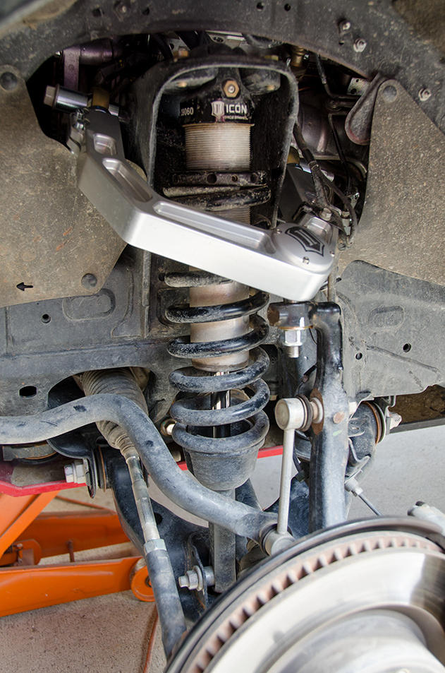

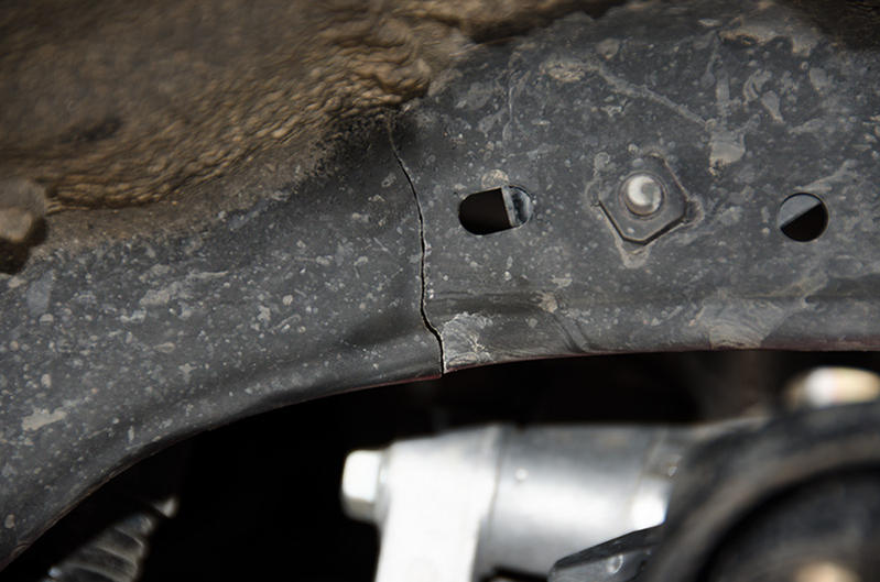

So the other day I was trying to get a picture of the installed Icon UCAs and I found a nice crack in the sheet metal in the inner fender.
Today I set up to fix it. Jacked up the front and removed the wheel. I finally got a decent pic of the installed UCA:
So this is the crack. I'm betting it happened when I took a little dirt nose dive on the dunes last year... Best not to let things like this go though, sho knows how bit it might get.

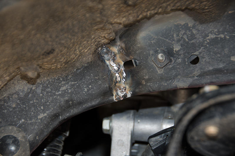

Normally I'm a passable welder under decent conditions, but under wheel well sheet metal... ugh. But at least I didn't blow any big holes!
Yes I sanded the paint off before welding, and yes I painted over it inside and out afterwards :)
While the wheel was off I did a little "clunk" inspection. Something I've had since the front icons were installed. I may have found the cause. Rather than repeating here, write up and pictures are in this thread:
http://www.toyota-4runner.org/5th-gen-t4rs/185200-trd-pro-clunk-4.html#post1899755
