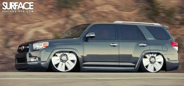

...so like Max's 4Runner height?
Pretty much.
Max has definitely started a 5th gen stance movement. Look what you started [MENTION=129593]MTN4RNR[/MENTION]!
So did u remove preload or added ? What is the lifted height?
