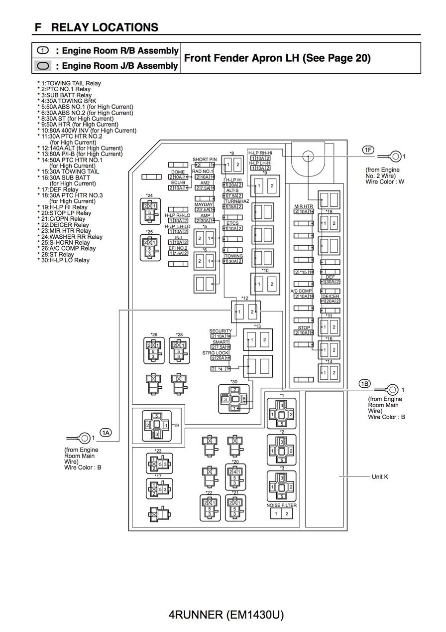

That's interesting. The short pin is installed during the Pre Delivery Service (PDS). Check out the attached file for more info, and have a look at the red "Note" box on page 2 where it says this:
• Removing the Short Pin cuts off power sources relating to the DOME, RADIO No. 1, and ECU-B fuses.
• The Short Pin does not function as a fuse, so install it only in the position shown.
It's not actually a fuse from what I can tell, just a jumper that disconnects certain circuits to minimize battery drain during transport and storage before sale. I wonder how yours "blew"?

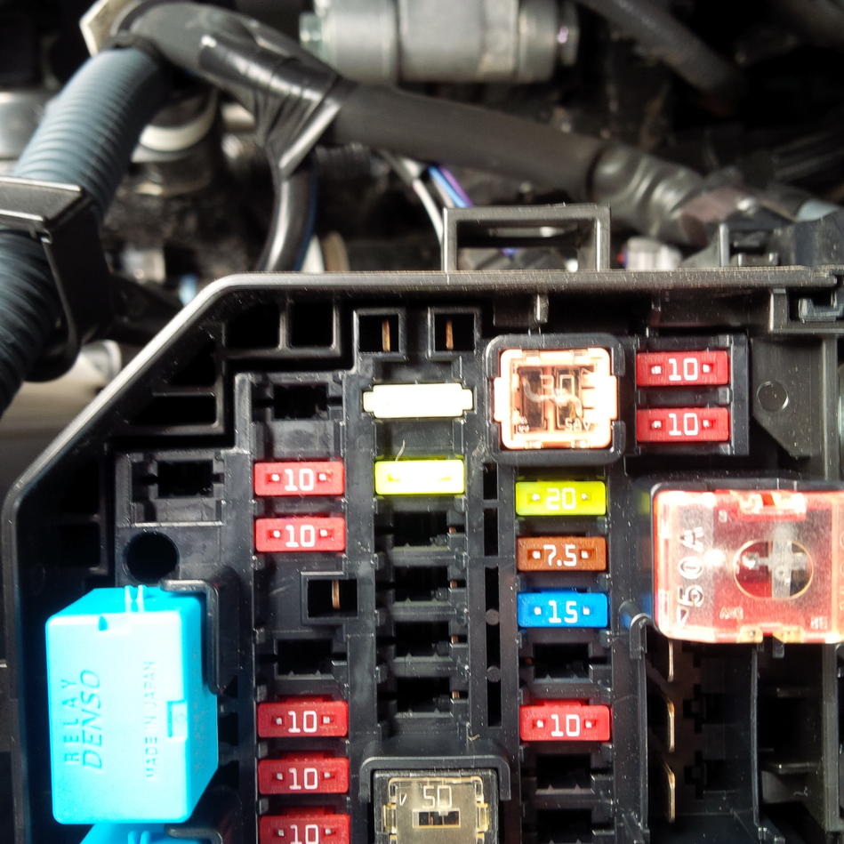

Edit: here's a bad photo of the Short Pin (the yellow one in the top of the photo). Note the little wings on each side that prevent it from being installed in a regular fuse slot.
If it is a true short pin (odd looking micro fuse) then it is nothing more than a metal bridge, it is not designed to blow at a certain amperage. I forget if the 5th Gens use that or a 30amp DCC fuse.
Needless to say, I'd be curious what the short pin looks like after it failed.
According to this diagram from the EWD the Short Pin supplies 12V to the DOME and ECU-B fuses. The owner's manual list those fuses as supplying power to the interior and vanity lights (DOME fuse) and the multiplex communication system, meter and gauge (ECU-B fuse). I'm guessing the BCM is included in the multiplex communication system but maybe [MENTION=66389]BlackWorksInc[/MENTION] can clarify? Given the symptoms listed in your first post I would think that this may have been the problem. I would verify that the Short Pin has good connections (check that the metal contacts it clips into are solidly held in place in the fuse box and that the connections to and from the Short Pin are solid).
If the problem does happen again you should be able to use a multimeter to narrow it down by checking for 12V on pin 1 of the Short Pin (end closest to the firewall). Then check pin 2 of the Short Pin (end closest to the grille) for 12V. Then check pin 1 on both the Dome and ECU-B fuses to see if they have 12V. Somewhere between the last good 12V reading and the 0V reading would be the issue.
  • RELAY LOCATIONS (Engine Room R_B Assembly and Engine Room J_B Assembly) (2010 4Runner)  copy.jpg

I finally got a chance to go take a look in the fuse box. Sure enough, the short pin is a specially shaped "fuse" with no number stamped on it.
Is it safe for me to remove the short pin and then start up the vehicle? I want to see if I can re-create the problematic symptoms I had before, in an easily reversible way. If it turns out the short pin is the cause and solution to everything, it will make me wonder why they were messing with the BCM at all.
The vehicle will run with the short pin removed I have only seen one go bad before; again its just basically a plastic encased metal bar for all intents and purposes, so it wouldn't surprise me if it got overlooked.

So I played around with the fuses today and made some interesting, if not obvious, discoveries:
The short pin was seated quite tightly (I needed needle nose pliers to grab it and pull it out.) It is most definitely just a piece of metal, and not a true fuse. Upon starting the vehicle with the short pin removed, ALL the symptoms of my earlier problems were back; inop door locks, lights, clock, blinking indicators on the dash, everything. Replacing the short pin and restarting the vehicle restored 100% functionality.
Removing just the ECU-B fuse and restarting the vehicle again gave me all the symptoms of the earlier problem, with the EXCEPTION of the dome lights, which still worked fine. Replacing this fuse again restored all functionality. As expected, when I then removed just the DOME fuse, the lights stopped working, but there were no other symptoms.
I called back my service writer to have him explain what exactly was wrong with the short pin. Turns out it wasn't "blown", but rather they found that it was not fully seated. He swears that they checked it on one of my earlier visits, and it was fine at that time, but one of his techs must have not replaced it properly. He also still swears that the BCM needed to be replaced...
My problem is this: If the BCM were truly dead/dying, the dome lights should have still worked fine, because as I proved above, pulling the ECU-B fuse and completely disabling the BCM had no effect on the lights at all.
The only possible explanation is perhaps the first few times the symptoms happened the lights were still working and I just didn't notice, and it was only after I brought it into the dealership the first time (and they messed up the short pin) that I started noticing the lights. It's honestly been so long that I can't really remember. However my service writer doesn't even support this hypothesis, because he said they checked the short pin on one of my later visits, when the FST was down from Denver.
What does any of this mean for me now? Should I go ahead and re-hookup my heated seats? Who knows!
