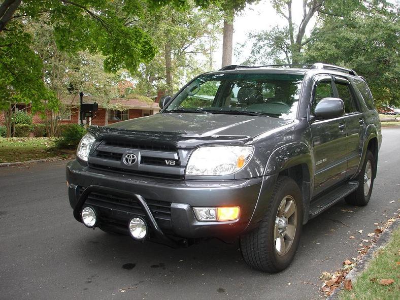

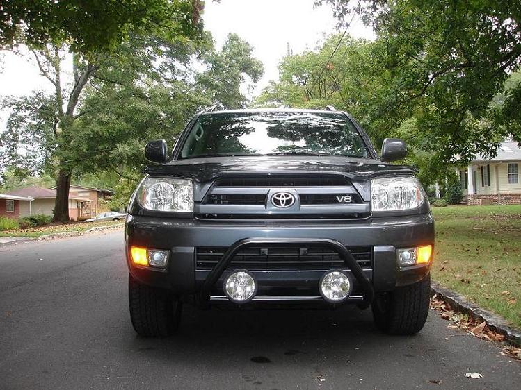

Well, since no one bothered to reply, I thought Id try it anyways. I looked at the dimensions again and looked at my bar and realized it would only take a little modification of the brackets on the light bar to fit the lights. I went ahead and bought them (they are really sweet by the way) and held them on the bar and I was right, it should only take a little work. I will work on them over the weekend and post some pictures as soon as they are on there.
Got the lights on and I like them. It only took a little filing of the light brackets on the bar. I just got a round file and extended the hole toward the tip of the bracket about a half inch or so until the back of the light cleared the bumper. Next, I primed the bracket and then painted it black to match the bar. I wasn't too concerned about the detail of this since there is now a light covering it anyways.
I really like the lights and would suggest them to anyone who is looking for something different than piaa's. Very high quality light that you can tell is built to last.

The lights did come with some white plastic covers with Hella printed on them. I'll be needing them soon since I seem to have tons of dead bugs all over the front of my car.
Ive been thinking about some kind of low profile mesh inserts, I may look into those, thanks.

Actually it was a birthday present. My dad had an offer for 20% off one item on performanceproducts, but went into 4wheel parts here in Atlanta and they matched the price. Not sure how much it was, but I think it was less than 160
They aren't as bright as the KC's I had on my old 4runner, but thats expected since those things were rediculous. The beam pattern is pretty nice, not as wide as the toyota headlights, but put out about as much light. I'll take some pics tonight and post them for you.
