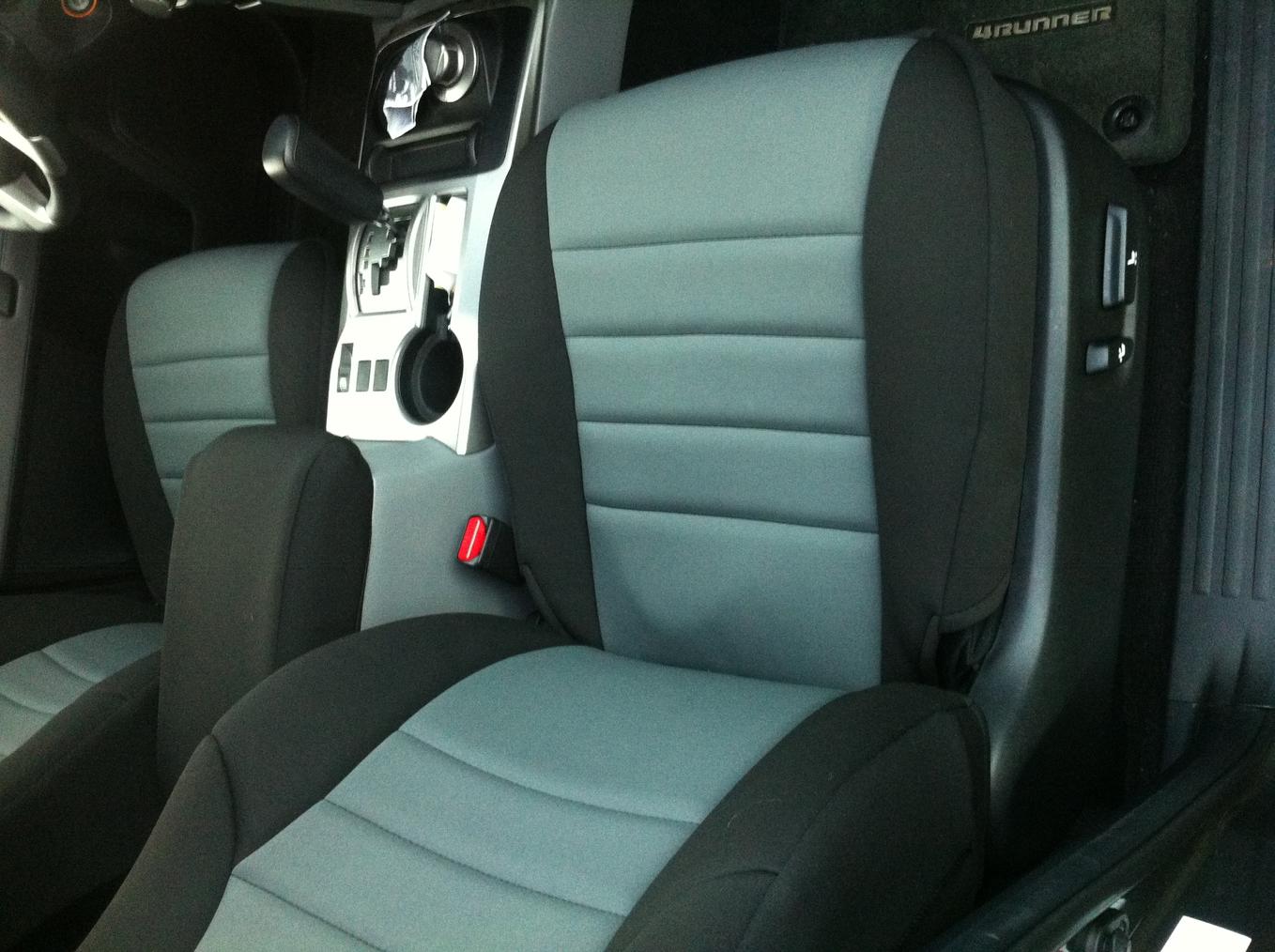

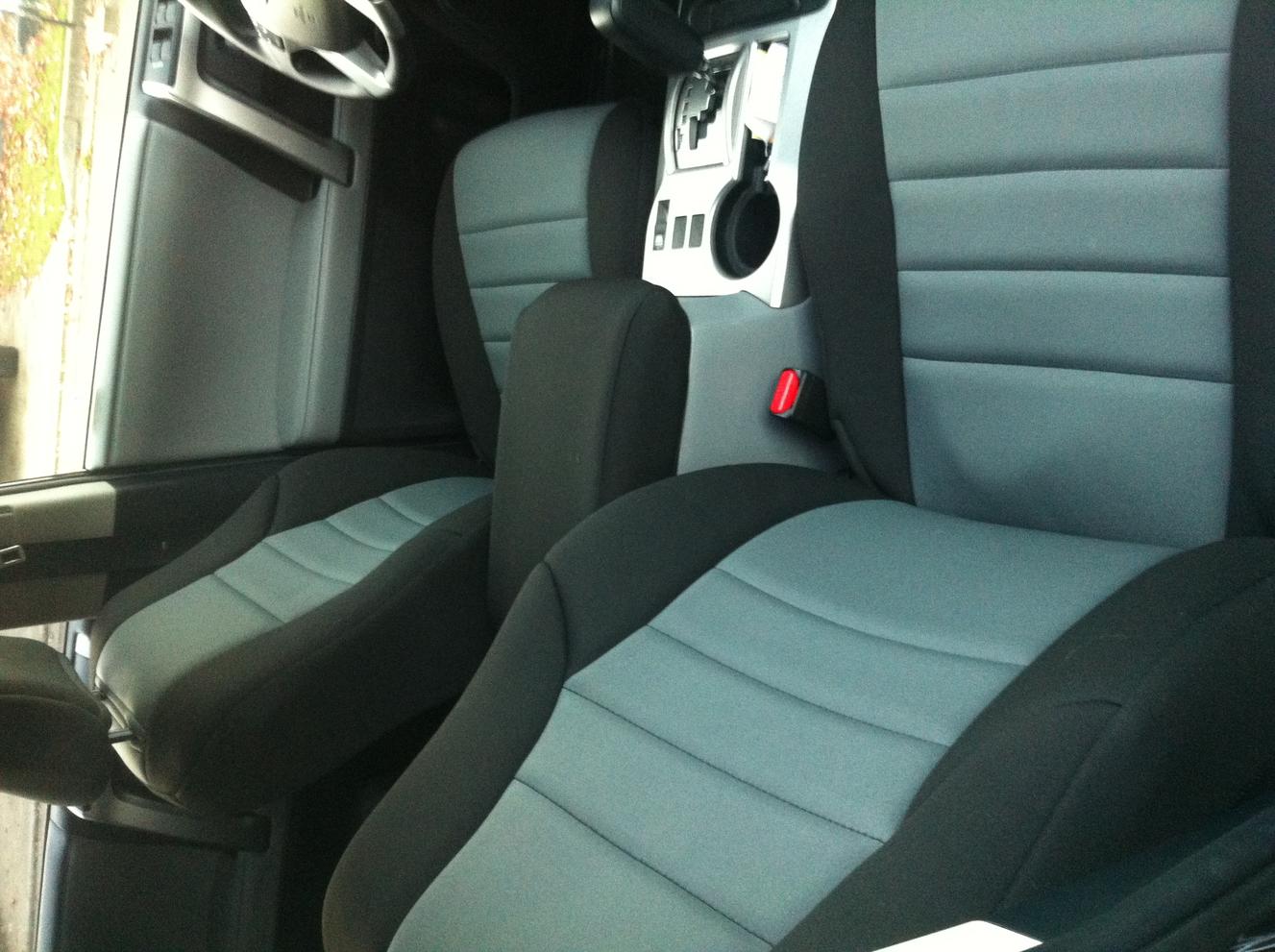

The spatula is key! Thanks for the insight everyone
Glad it worked for you! Pics? :)
Suppose I should have posted a pic, earlier:
Feels good to have them installed.. did you not get any headrest covers?
