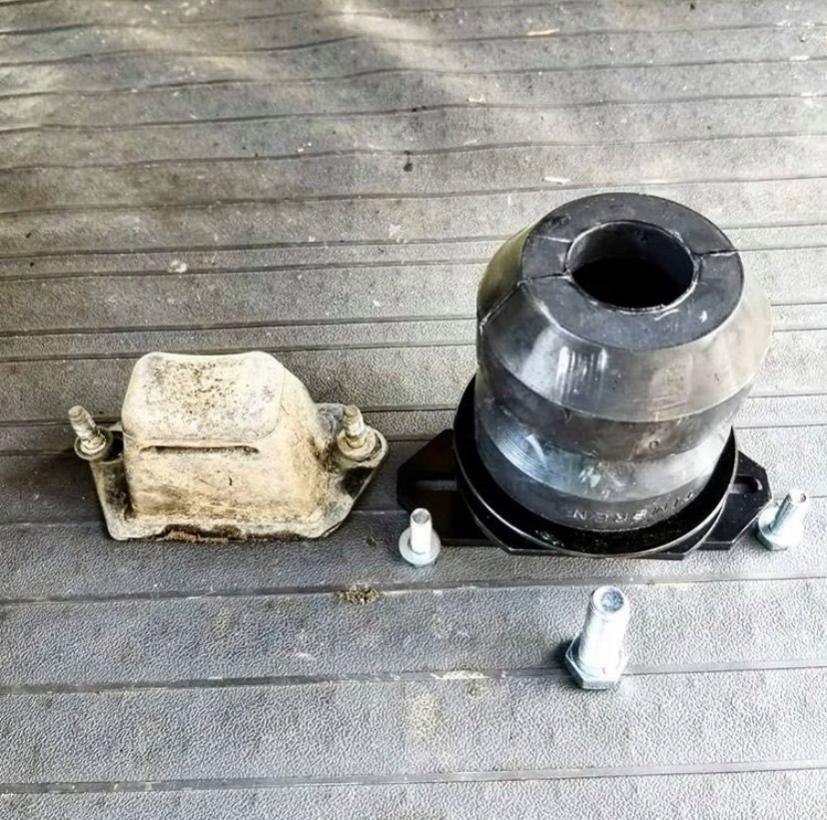

I bet some photos of your 4Runner products would be greatly appreciated. If you have a side by side with OEM I think that would give everyone some good perspective also
Here is a good side by side you were looking for!

These are great questions! Roughly there is 4-6 inches between the bottom of the stop to the top of the dif. Where the active comes in is when it begins to squish, taking strain off the springs and dampening the bump. Our bumps have enough flex in them to go almost flat. OEM bumps have no squish and are much higher putting more strain on your suspension and spring setup. Does this give you the answers to your questions?
Thanks for the picture and your replies. I think this will really help everyone make good decisions.

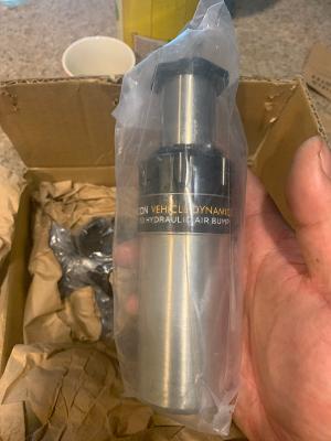

You sold me on dem hydrobumps...:guitar3:
going to run them in conjunction with the timbrens.
thanks for the advice broski.
Lol I got the email for the thread update (didn’t have the image) and I was like hyrdobumps, someone’s making a water filled bump stop, the fq is dat. :D
Could you image the wintertime calamity if you had frozen solid bumps stops
