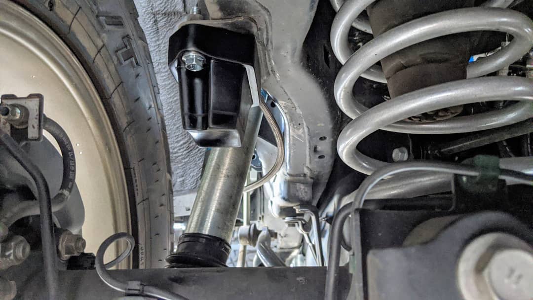

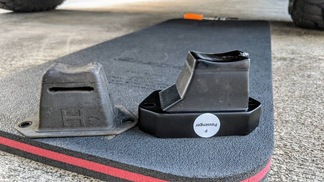

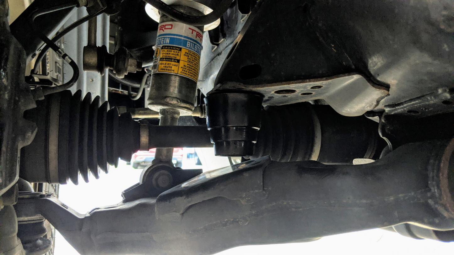

Installed Energy Suspension bump stops in front, and DuroBumps in the back. Didn't get to test it off road yet, just regular driving. Honestly, I'm not sure I notice anything different during regular driving. The front bump stops have about ¼inch to ¾inch of a gap between the stop and the lower control arm. Pretty sure I've hit it a few times already. I think I feel like the the ride in front is smoother when going over bumps. I have to try it off road, and see how it is when flexing, and on drop offs.
I just got the rears today, so haven't driven with the DuroBumps in the rear yet. I'm sure it'll be similar, and won't notice any difference in ride during regular driving. I can confirm that the DuroBumps DBR35 that are listed and described as 1.5inch are actually 3.5inch for 0 - 2inch rear lift which makes sense being that the stock rear stops are around 2.5inch. Wouldn't make any sense if they were shorter than stock. The DuroBumps being rubber are a lot softer than the Energy Suspension flex polyurathane stops. I'm hoping the Energy Suspension stops up front won't take away any up travel.
