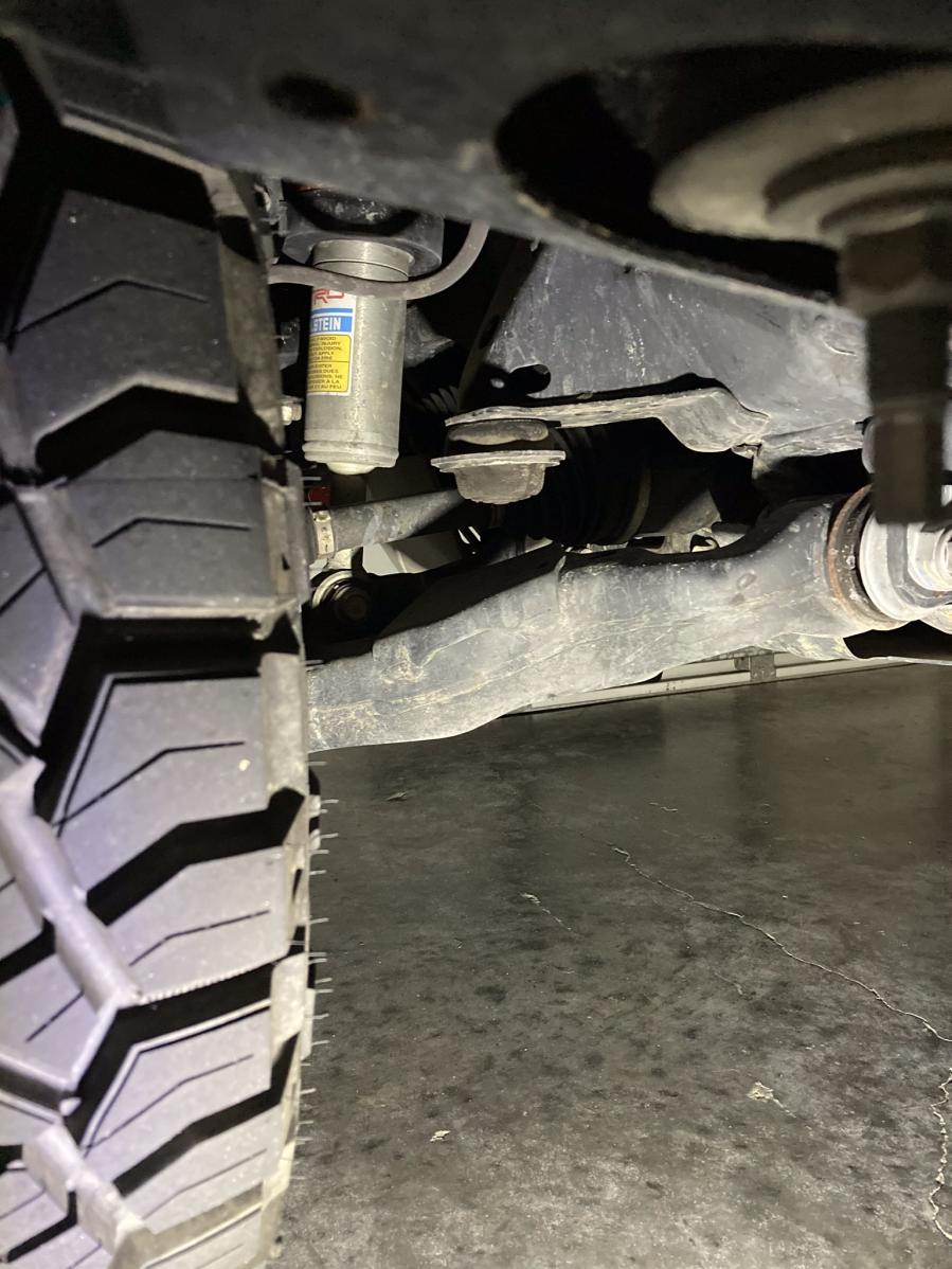

Yeah I didn't know if there was a nut I had to get to in there or if they just threaded in. Got lazy and didn't go back and do it. Might throw then on tomorrow if I have time. Thanks.

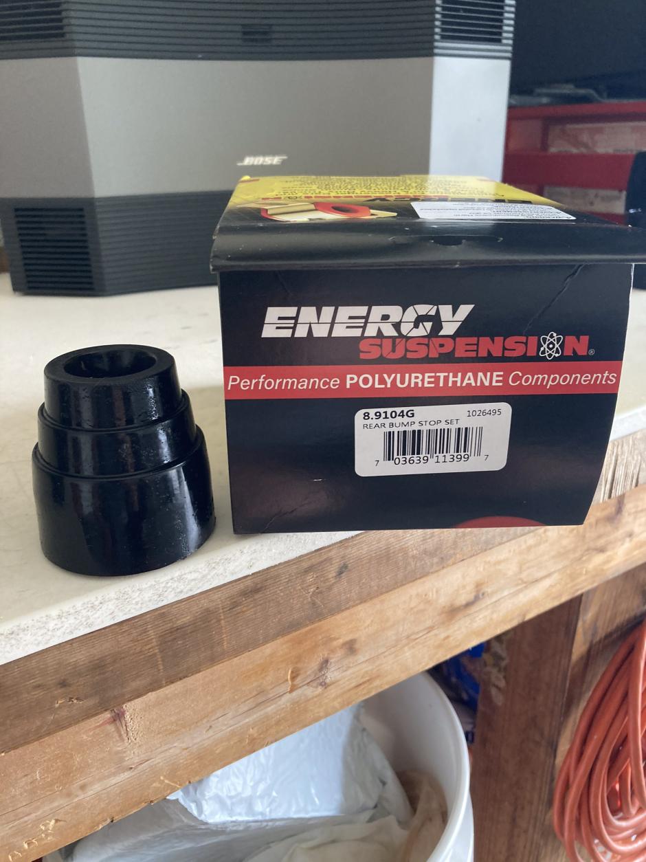

I pulled the trigger on the energy suspension bump stops for the front. I just wanted to be sure these are correct as they say rear, and see how they are holding up?
just installed these exact ones on my car over the weekend. i did not jack the car up and getting enough clearance to screw them in with an allen wrench was a huge PITA. ended up cutting down a wrench with a dremel to make it all work. definitely an upgrade over stock though
Ok thanks for the sanity check. It does look like I can get away with not busting out the jack. They managed to forget my mounting bolts even though the bag was sealed, I’ll pick some up tomorrow.

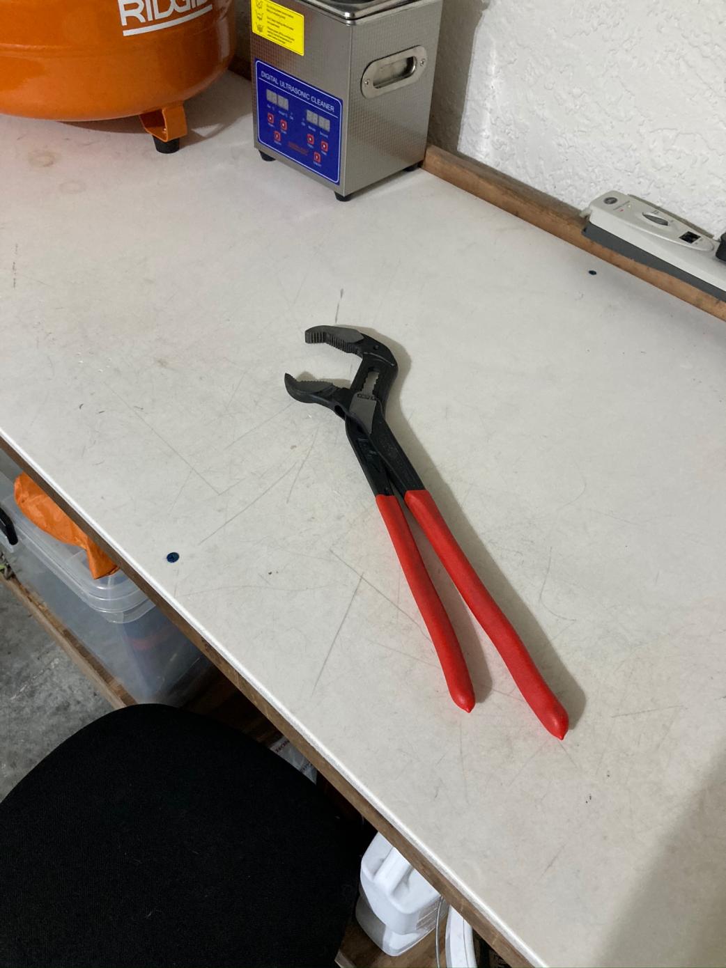

Have handy a pipe wrench or a channel lock wrench to take the stock BS off. Fyi the energy suspension screws used allen bolts, so a socket with matching allen head might be handy as well depending on the option of the bolt you choose. Just keep in mind your tool or socket used has to clear the ID of the bushing. A single L shaped allen key can be too short on one end to use and the long end can be too long, it might make contact with the LCA so that is why your T4R brothers lift theirs for the clearance to install these bump stops.
Have handy a pipe wrench or a channel lock wrench to take the stock BS off. Fyi the energy suspension screws used allen bolts, so a socket with matching allen head might be handy as well depending on the option of the bolt you choose. Just keep in mind your tool or socket used has to clear the ID of the bushing. A single L shaped allen key can be short on one end to use and the long end can be too long and will make contact with the LCA so that is why your T4R brothers lift theirs for installing these bump stops.
Thanks I appreciate the tips, I’ll bust out the jack if I can’t sneak an Allen socket in there. I’m thinking these channel locks will suffice.

Unless you have the perfect height wrench it will likely just be easier for you to jack it up. They also forgot my bolts as well.
