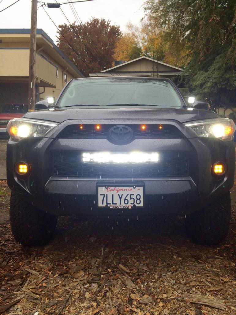

Installed a CaliRaised 30" bar behind the grille mounted with the Rago Fabrication brackets.
Installation was fairly straight forward although the video instructions on the CaliRaised site are atrocious as it related to the actual product. Great to remove the bumper and grille but it essentially ends without any info as to how to install the actual brackets/light bar. That said, it's not terribly difficult to figure out, but the provided screws that mount the light bar to the brackets were too long so I used the rubber spacers intended for the other light bar feet I didn't use. I watched their video for the 2016 tacoma and they used the rubber piece as a spacer too with a disclaimer about "not necessary for installation" which tells me they had the same problem. Why they are shipping these with the wrong hardware I do not know but just a heads up.
It worked fine using the rubber spacers (see below), but just felt silly and I will probably replace the screws due to the OCD in me. Additionally, the brackets push on the grille - I saw in another thread others have had this issue. I remounted about 5 times to make sure everything was mounted as far back as possible, but it's simply a design flaw.
In the end, I'm pretty happy, the light is super bright and install wasn't too bad beyond trying to understand the silly design issues - the switch it comes with feels super AUTOZONE, but will have to do until I have time to figure out how to make the AOB switch I have compatible... I know there's a million threads on here and I can tie it into the wiper heater switch, but I'm not sure if I can splice it into the wiring for the existing switch thereby using the current relay or if it needs its own relay? I'm an electrical noob.
I saw another user state that they had to cut the grill so that it wouldn't make contact with the bracket. Melissa Rago commented that they can walk people through installation so that contact with the grill does not happen. Did you try to contact them at all?
I'm about to attempt this and have my wife be the second set of hands. Since it is her 4R, I don't want any rubbing the grill issues. I may call Rago Fab before attempting to make sure that I get it right the first time.
I did not although I do recall seeing that thread as well. I would say it's worth doing. Mine rubs enough to certainly apply pressure to the grill and it appears to be digging in a little bit - when I have a few daylight hours in the coming weeks I will open it all back up and see if i can't figure it out, but I spent a good 30 minutes mounting and remounting (remounted probably 3 times on each side) to try and get everything set as far back as possible to no avail.

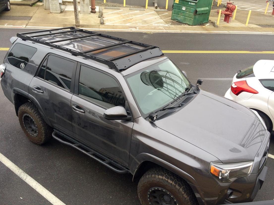

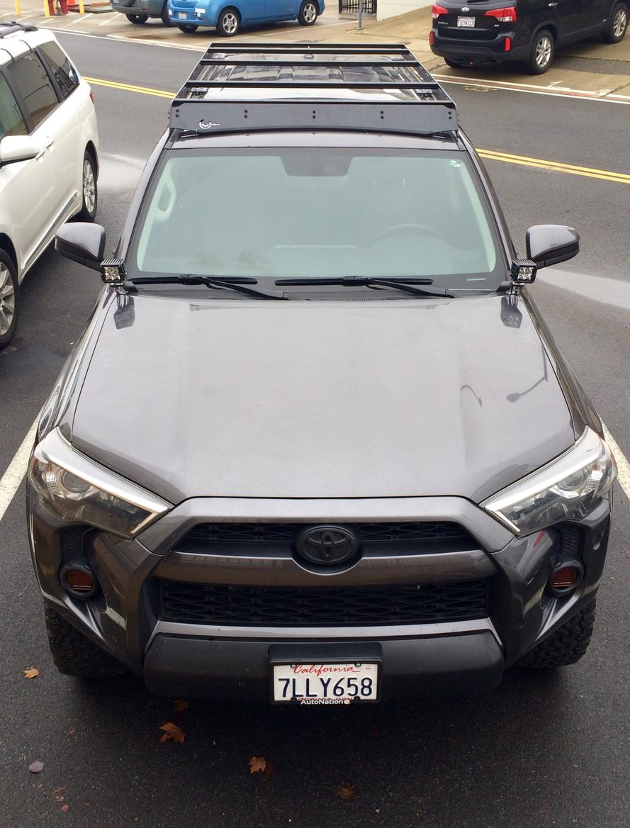

Prinsu Rack & CBI Ditch Light Brackets
Had a few hour break in the rain this weekend so I was able to install my CBI ditch light brackets and also semi-install my Prinsu Rack.
Still need to drill holes in the roof for the front foot mounts :cry2:... I did not want to do that since there was still rain in the forecast.
I'm hoping to finish up the final roof drilling and install the rest of cross bars this week sometime.
Here's some progress photos so far:
