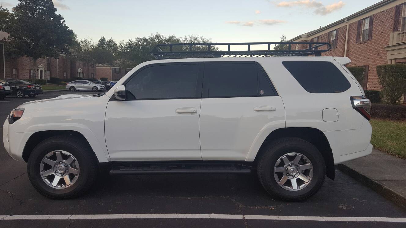

Thanks [MENTION=142749]Mariner[/MENTION], I already received mine about 3 years ago for my first Runner. It still is in its box, brand new. Debating if I install it or sell it, do you feel it protrudes too much???
Not at all. I wanted the original cargo basket because mesh just allows for more rust points, and I wanted the basket walls. It's very well made for a Mexico product and I was standing on it today, no problems. The specs say it adds 8 inches to the top of the vehicle but I think it looks just fine.
Not to mention I waited less than 2 weeks between ordering to installation.

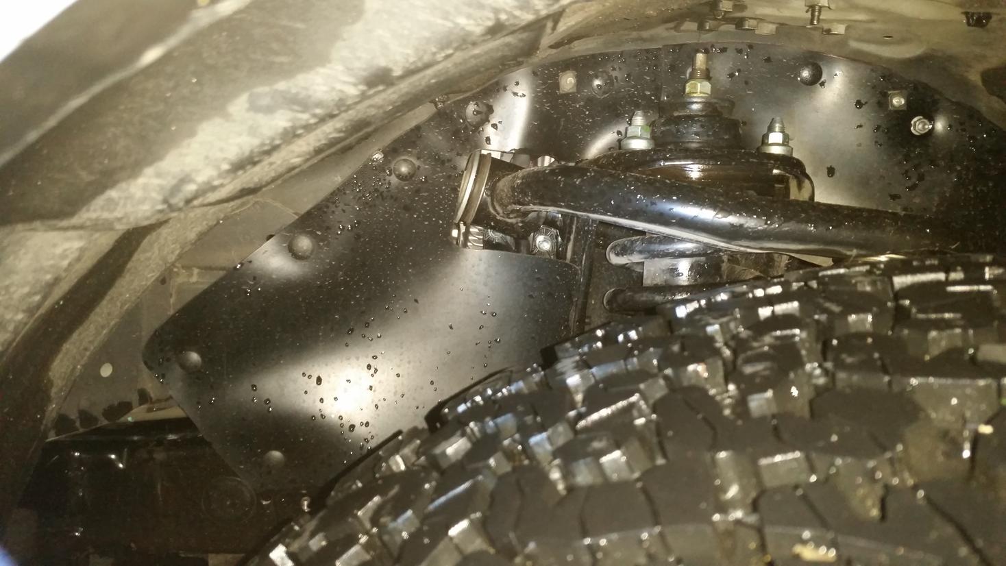

I made some better splash shields for the inner fender. I first did this on my 2015 Tacoma when it was new and after 1.5 years of Oregon rain/snow the engine bay is still clean like the day I bought it.
that sh!t is money yo! :pimp::thumb::pizza:
Great idea. The whole 5th gen fender liner (or lack there of) really bugs me to be honest. Particularly the rears in front of the wheel, that nice dirt/grime/salt catch that you spend five minutes hosing crap out of.
They are made out of 1/16" rubber. I made templates then cut them out of rubber. I used some plastic xmas tree push pins to attach them. Been doing this on all my trucks for years.
Yes they would. Pm me if you want to make a set.
I think this might deserve its own thread. Whered you get the material? Cost? Howd you cut it? Any install issues? Hell, you could probably sell these if you were interested.
