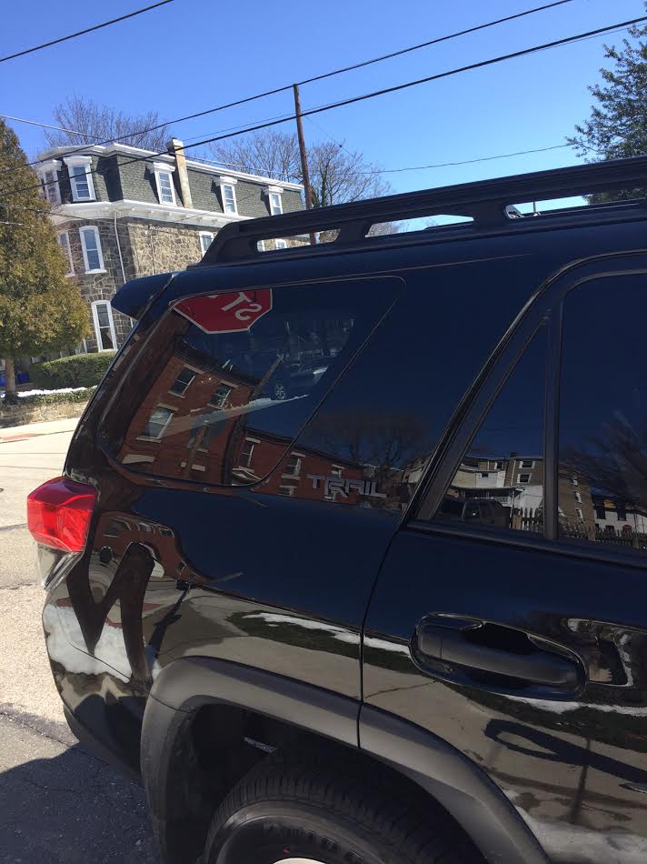

Chrome Tone Down
Took advantage of the beautiful weather to tone down the chrome! Still not sure how I want to finish the tailgate garnishment.

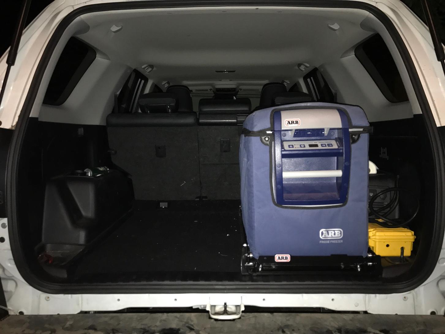

Wrapped up the fridge slide this evening. I used these 2" steel spacers that I found at ACE hardware as supports underneath the floor carpet, along with a series of large washers to spread the surface area out.

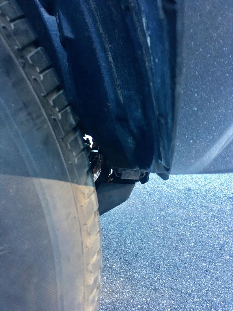

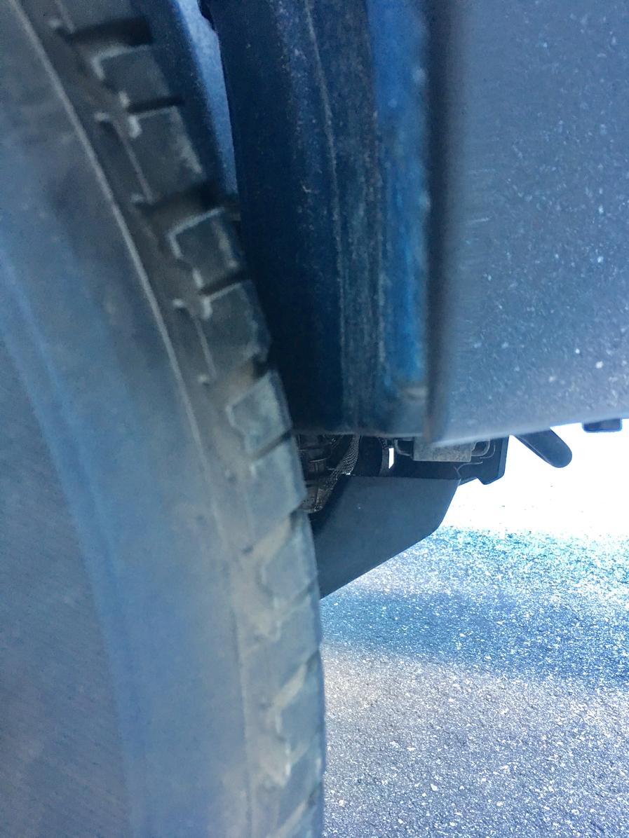

Lifted 3", and clearanced bumper/wheel well liner in prep for higher offset, wider rims, and hopefully this summer new MEATS (HELL YEAH BROTHER).
Super super easy, Just undo the two bolts, screw those into new holes drilled, then tape off and score the bumper with an exacto, and you dont even need to cut all the way through at first. Just bend it after maybe 2-3 passes and then when you bend the piece being removed up, a white bit of plastic will appear (white because its being stretched) and just cut along that.
Sand it even and smooth and you're all done! Way easier than I was expecting, got it done in maybe an hour and a half. Managed to gain 1.5 inches of clearance at the widest point.
NOTE: These pictures were taken with the wheel at full lock in the inward direction (in the right wheel well this would be full left lock etc.)
Before:
After:
and the left:
