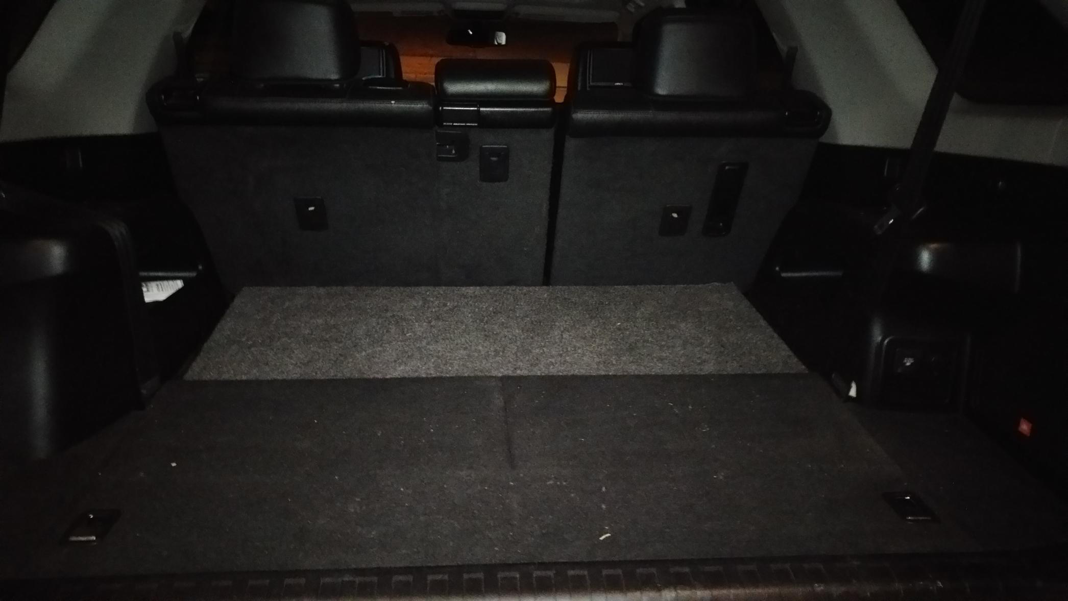

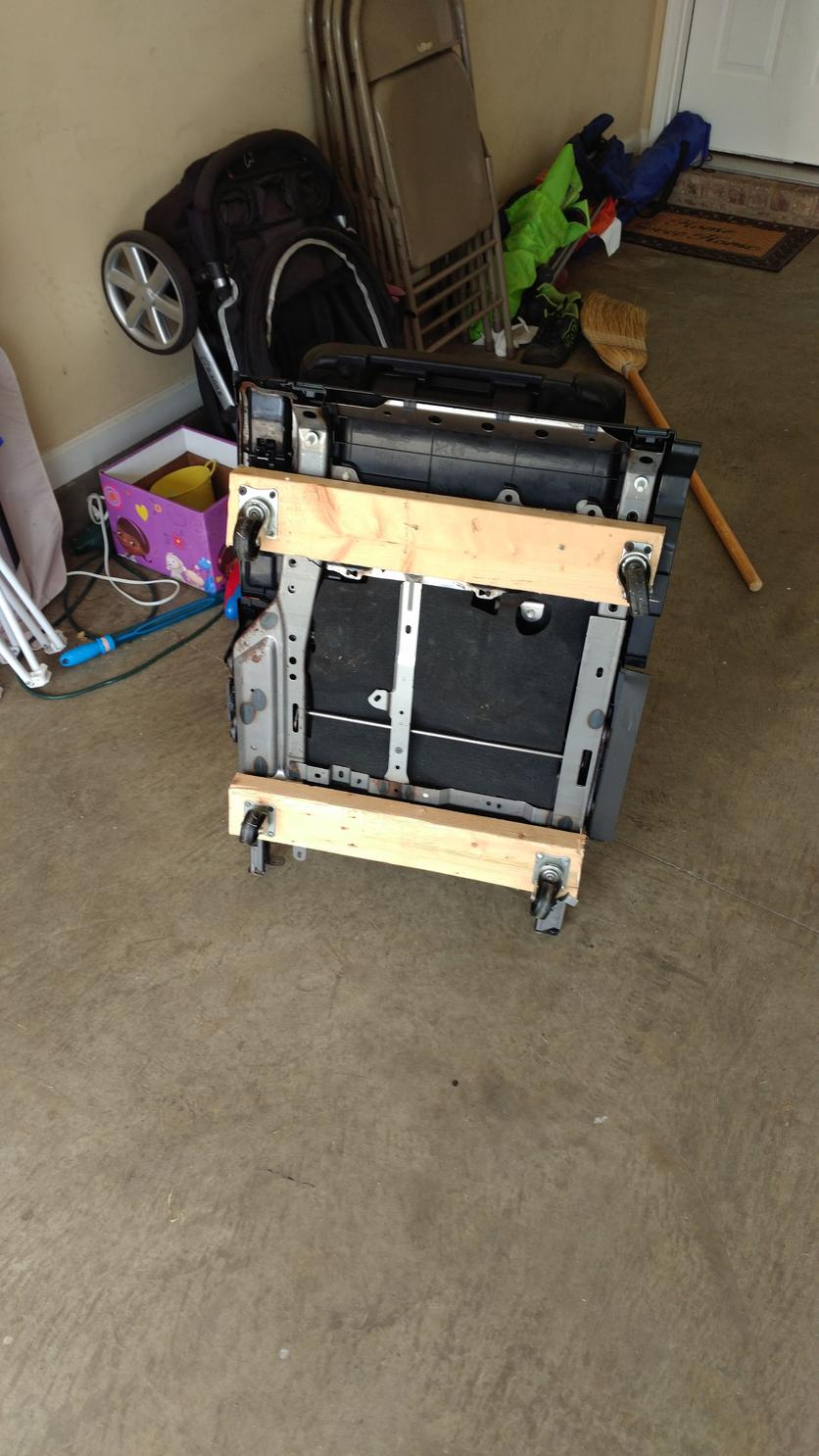

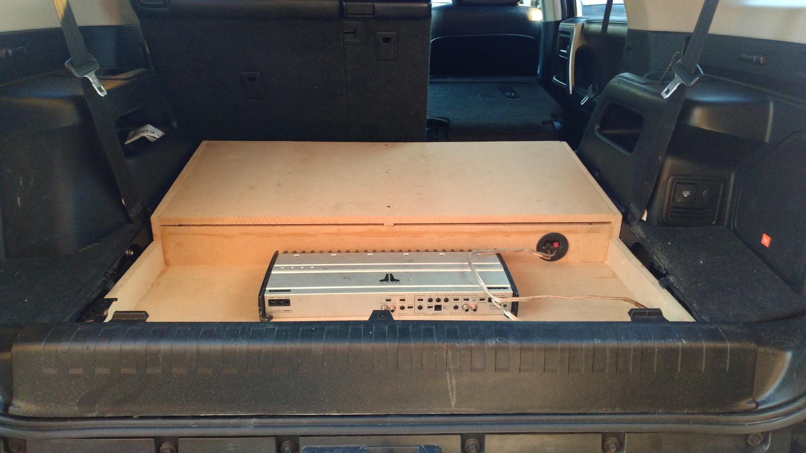

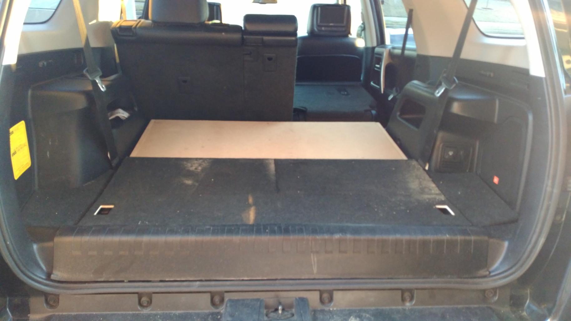

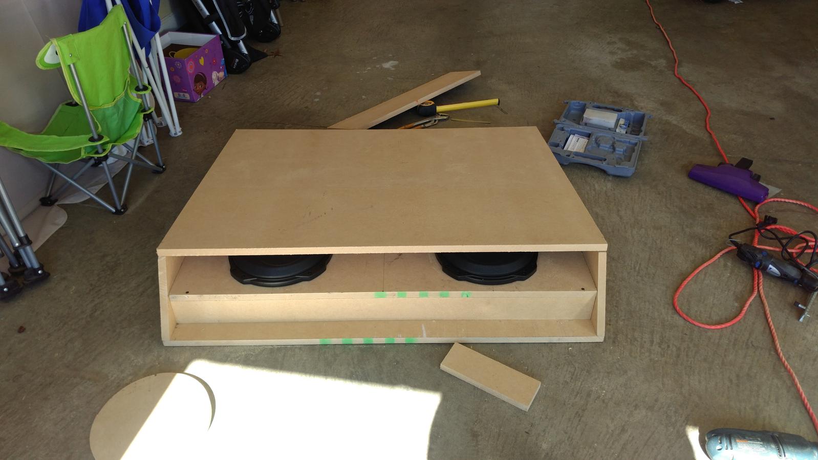

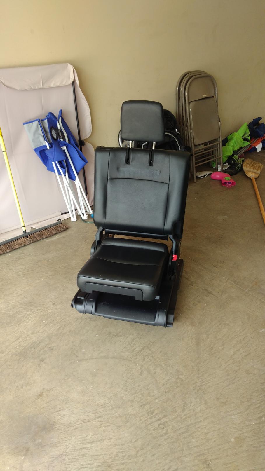

3rd row mod
removed 3rd row and turned them into shop chairs.

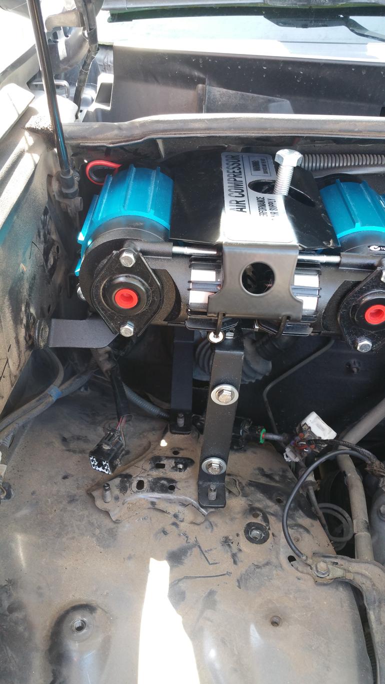

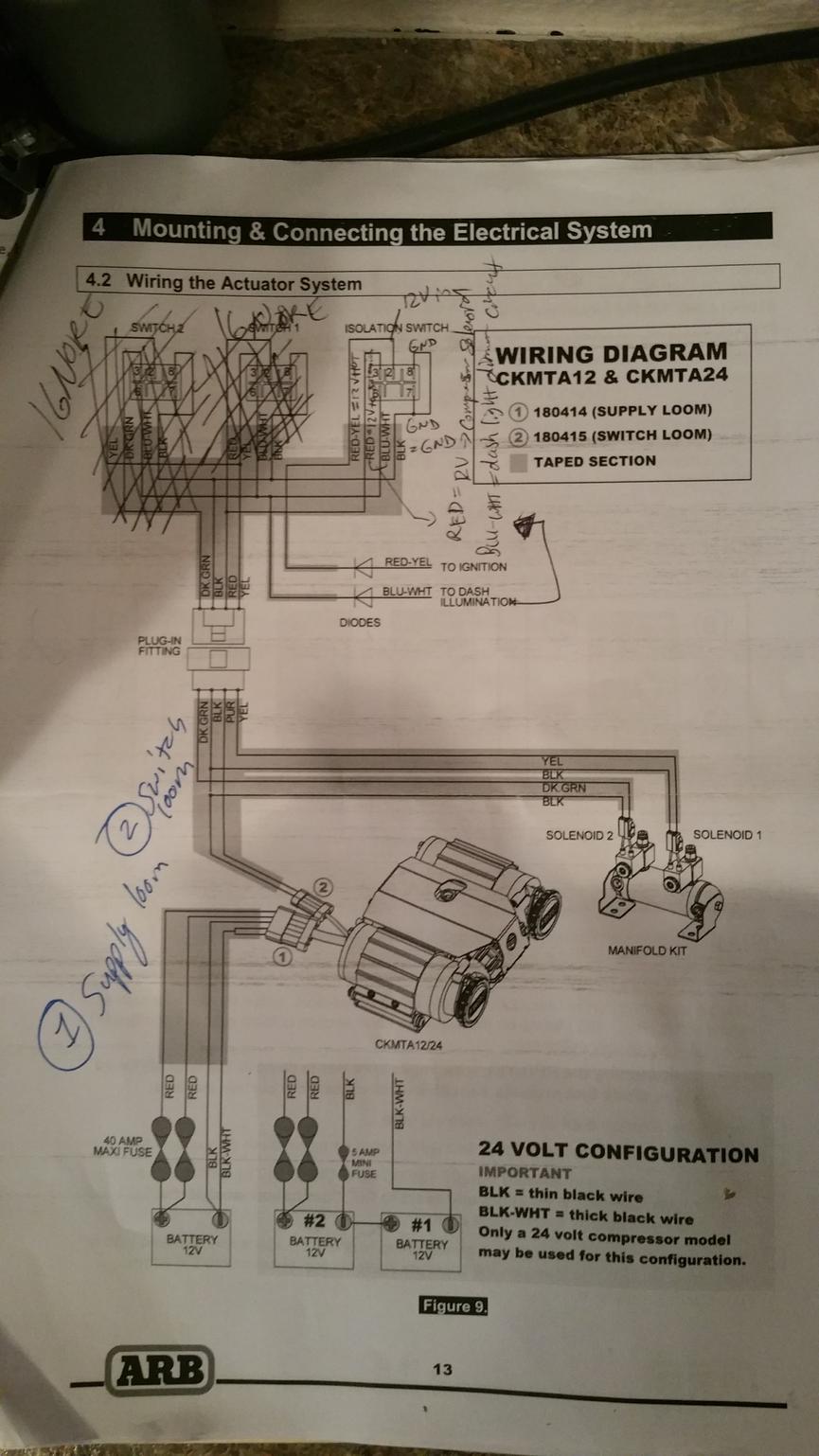

recently got around to installing my twin ARB compressor, bandimount, and viair air tank. Still havent wired it up... but its coming when i can get some help from the wiring gurus in the crowd (@rigtec [MENTION=65614]Antman[/MENTION] others?)
WIRING HELP NEEDED: I am trying to wire up my compressor switch harness to an NSA trail toys box INSTEAD of the ARB compressor switch that was provided. See wiring diagram. Need to determine what input to send to the appropriate wire, NSA box is capable of sending 3 types of signals to an accessory: Toggle, Momentary, and Latched. And based on the diagram and and ARB switch wiring diagram I think i need to use the red wire which should be to the "compressor solenoid". But what signal should I send it and or have I selected the wrong wire? please PM me about this though so as not to cloud up this thread. TIA.
ARB Switch:
Picture is halfway through the install, sorry, by the time projects are completed its time to put things up, not take pics. Though I wanted to note some things in this post and in this pic:
1. Only two bolts are required and they go into the passenger fender wall, they are size M6-1.0. I used countersunk ones from the hardware store since i believe i misplaced the fasteners [MENTION=125603]bandi[/MENTION] sent me initially.
2. Only two nuts are required to fasten the bandimount feet to the fender, they are size M8-1.25. I was missing one of these bolts, the joys of owning a used car :tongue1:. So i bought some nyloc nuts in this size and reused the one i tool off earlier.
3. [MENTION=125603]bandi[/MENTION] recommends this order of operations to install the compressor and mount when installing the 1gal air tank too:
I would recommend the below sequence...
0. Remove Air-box...
1. Connect front and rear leg to top plate...
2. Connect compressor to the top plate...
3. Install compressor/mount into truck...
4. Insert tank and mount to front leg...
5. Reinstall air-box...
I did it a little bit differently to streamline the process to do as much as i possibly could off critical path:
0. Connect front and rear leg to top plate
1. Connect Air Compressor to top plate (with all 4 bolts provided with the ARB compressor kit)
2. Remove Airbox
3. Install Compressor/mount into truck (with all wires connected to the back of the compressor because access is extremely tight after you fasten the compressor into place)
4. Insert tank (with all necessary fittings/plugs/hoses INSTALLED) and mount to front leg with provided fasteners
5. Tighten everything down
6. Reinstall Airbox
Big shoutout to [MENTION=125603]bandi[/MENTION] for making such an awesome piece of equipment. This thing is SOLID! and it is purpose built and simple too. Also his customer service is second to none. dont hesitate to buy a bandimount to make your compressor install clean and solid. :hug:
