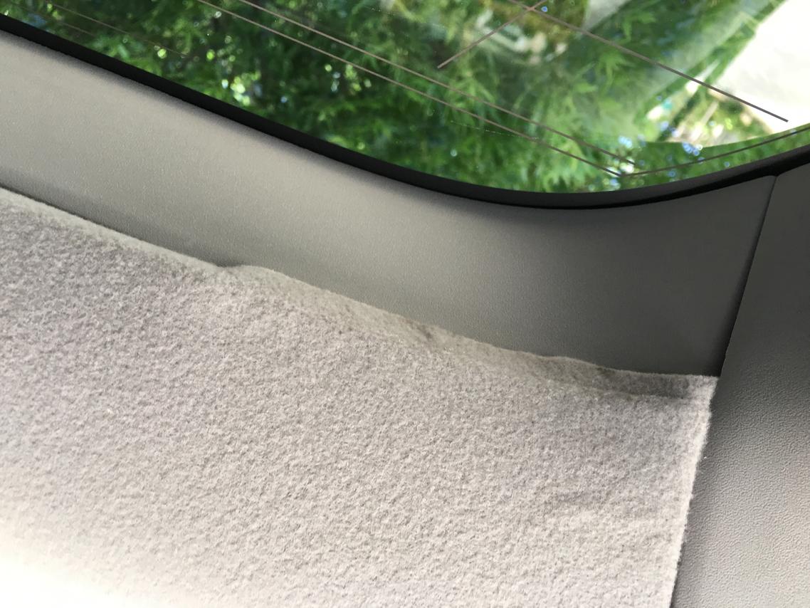

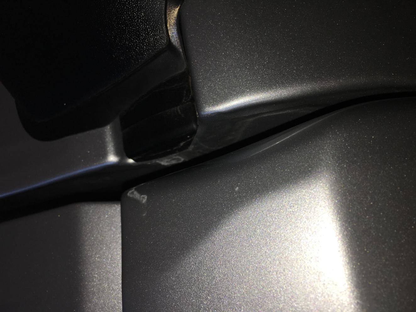

Well I picked up the truck yesterday after 2.5 weeks and a redo I described earlier. I still wasn't happy with the hinge alignment so I stopped at the dealer and had my service advisor look at it. He agreed it wasn't right and to call the body shop's manager, which I did and he's agreed to make it right. However after I got home and really looked at it, I found it was still completely unacceptable and I'm pissed I even picked it up. Here's the list of shit we found wrong...it's looong:
1. Spoiler is hitting the body on the right passenger side when tailgate is open (creating new paint damage)
2. Dent in upper left tailgate under window
3. Paint lines clearly visible down the sides of tailgate (especially on right passenger side)
4. Paint overspray on edges of tailgate (finish feels rough)
5. Damage to both sides of tailgate garnish where garnish was pried off
6. Right passenger appliqué chipped at bottom
7. Chrome 4Runner emblem on garnish is nicked and scratched
8. Foam gaskets for the garnish bolts were not installed after specifically leaving a message with the adjuster that they were a one time use item because they compress and will cause paint rubbing issues over time
9. Something rolling/rattling inside of tailgate
10. Left and right side headliner was not properly installed (headliner not tucked back behind plastic, looks pinched and creased)
11. Mark in paint to the right of the license plate and a couple small places where paint is not smooth (not sanded/chip painted over?)
12. Left side of spoiler has some play.
I'm in utter disbelief that any reputable shop could allow this.

Sounds like a total POS body shop. I would call my insurance company a demand it be done by another shop. Sounds like this shop is completely incompetent and I wouldn't trust them to air in my tires let alone fix everything they screwed up. You need to tell us the name and location of this shop so it can be completely avoided by others in the area.

It's AutoNation Collision Center in Las Vegas. We are planning to go in there tomorrow and rip into them and then take it elsewhere. I'd maybe consider letting them fix just the right hinge, but this is totally ridiculous. Here's the worst issues...

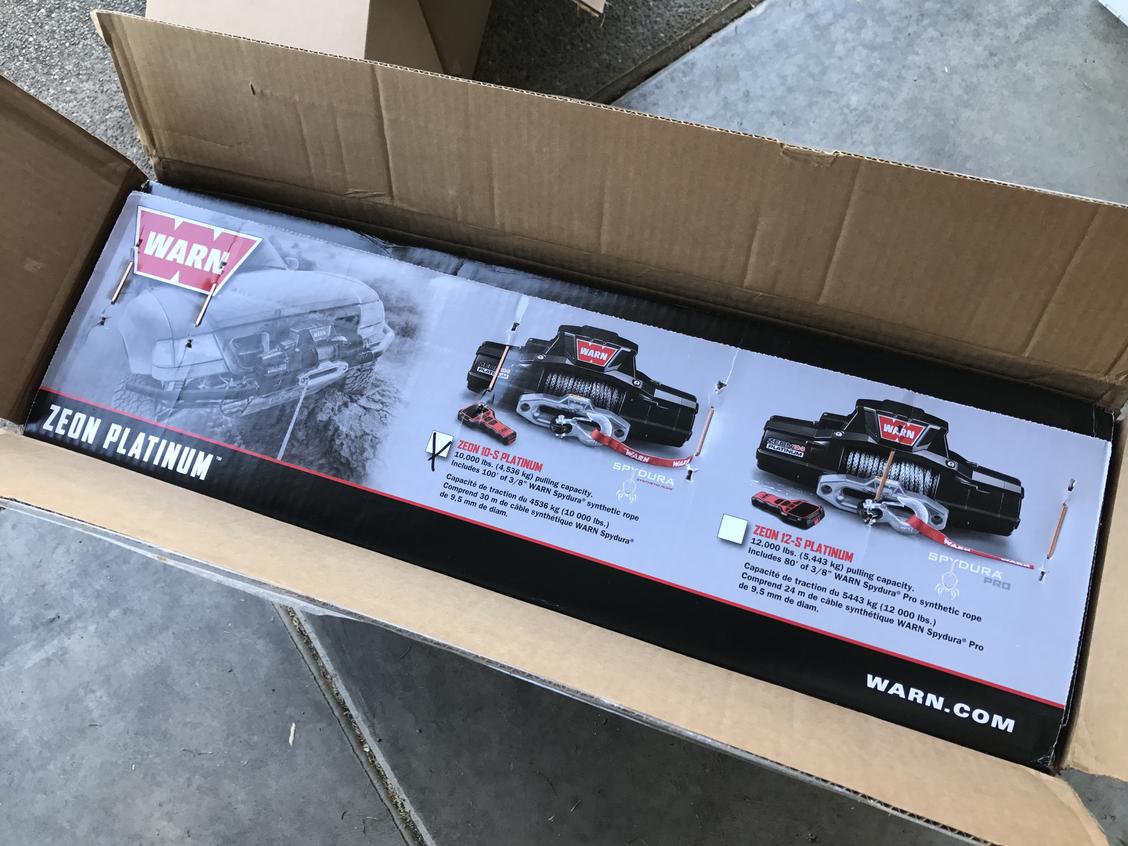

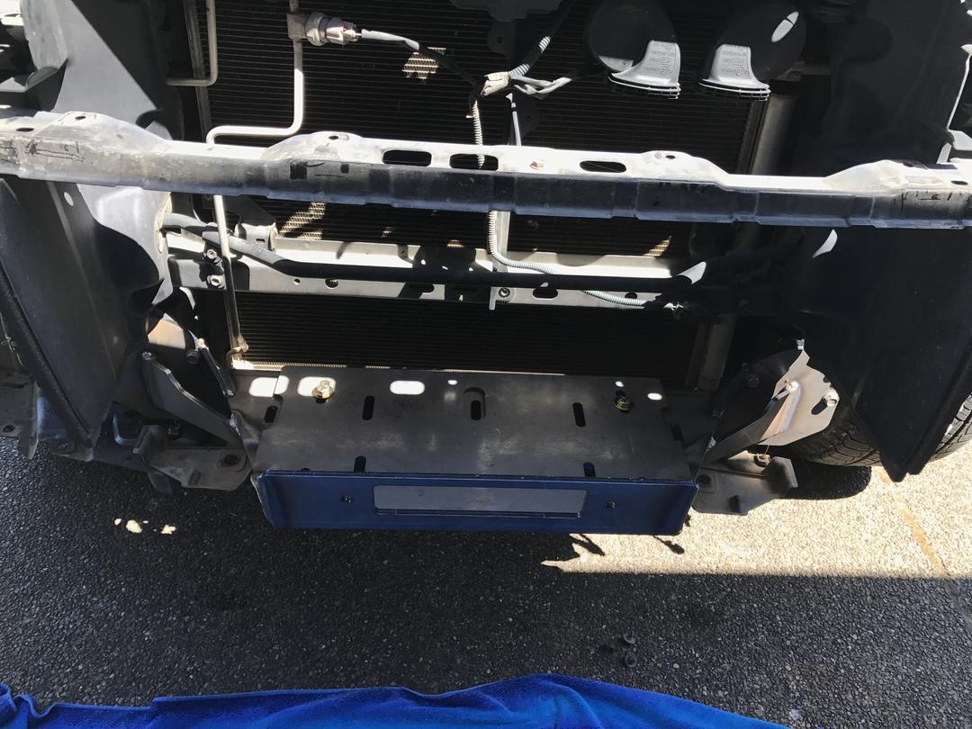

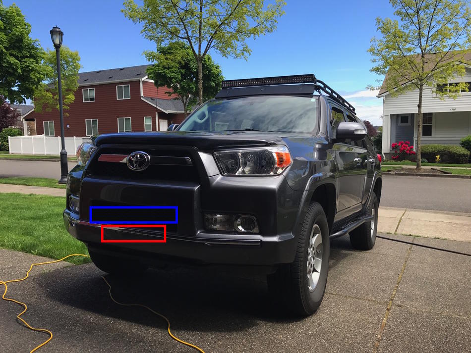

Attempted to install the PELFREYBILT Hidden Winch Mount (HWM) on my 5th GEN SR5 with WARN Zeon Platinum 10-S Winch. The body style of my 4Runner is slightly different from the Trail version. The front is larger, giving it a sporty look vs being blunt like the trail to accommodate approach angles.
While the HWM installed perfectly when attempting to fit the fairlead it was in a less than ideal location (see red). I'll reach back to Pelfreybilt and ask specifically if 1/4-1/2 spacers could be used to raise the height, centering the winch properly in the open lattice of the front end (see blue). Overall the construction of the HWM is STOUT and includes a bracket to attach the divorced solenoid (which I'll need to purchase the relocation kit from WARN).
Either way, beautiful day in Washington and fun to problem solve.

Beautiful day in WA indeed. Nice ride with quality mods. However, I hear your rig screaming for beefier shoes, haha.

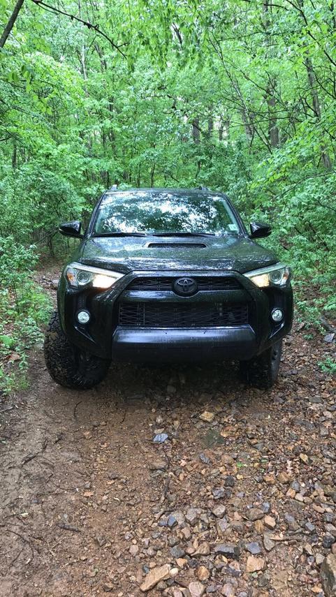

First post and first run through some new trails since moving back to NJ
