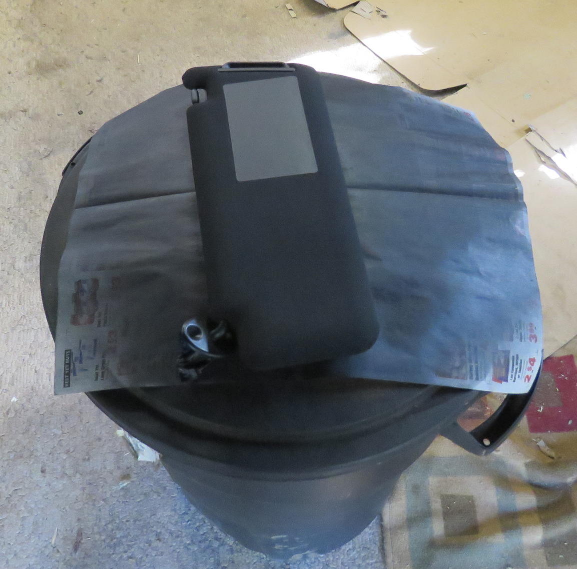

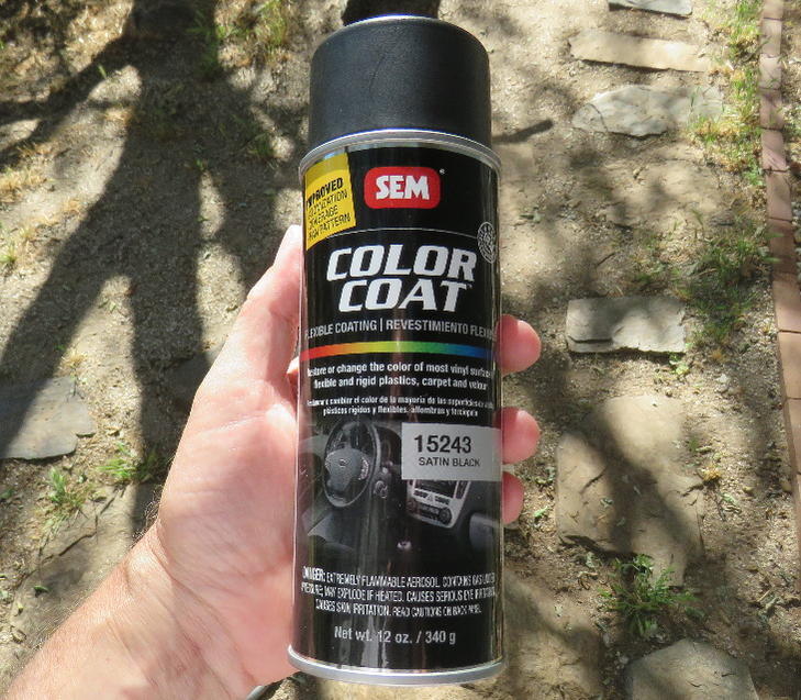

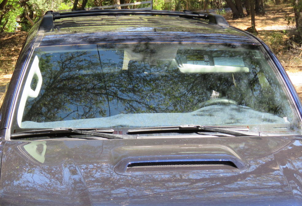

Painted my visors
I really didn't like seeing all the safety stickers when my visors were down, so as a continuing effort to black out most of my 4runner I did my visors yesterday/today.
I did the passenger side first, to compare before/after. I asked the paint store for something that would work on automotive plastic and fabric, and this is what they recommended, SEM Color Coat.
Tomorrow I'm getting my moonroof and back windows tinted. I've already done the front, at the time not realizing the difference between tint and privacy glass....

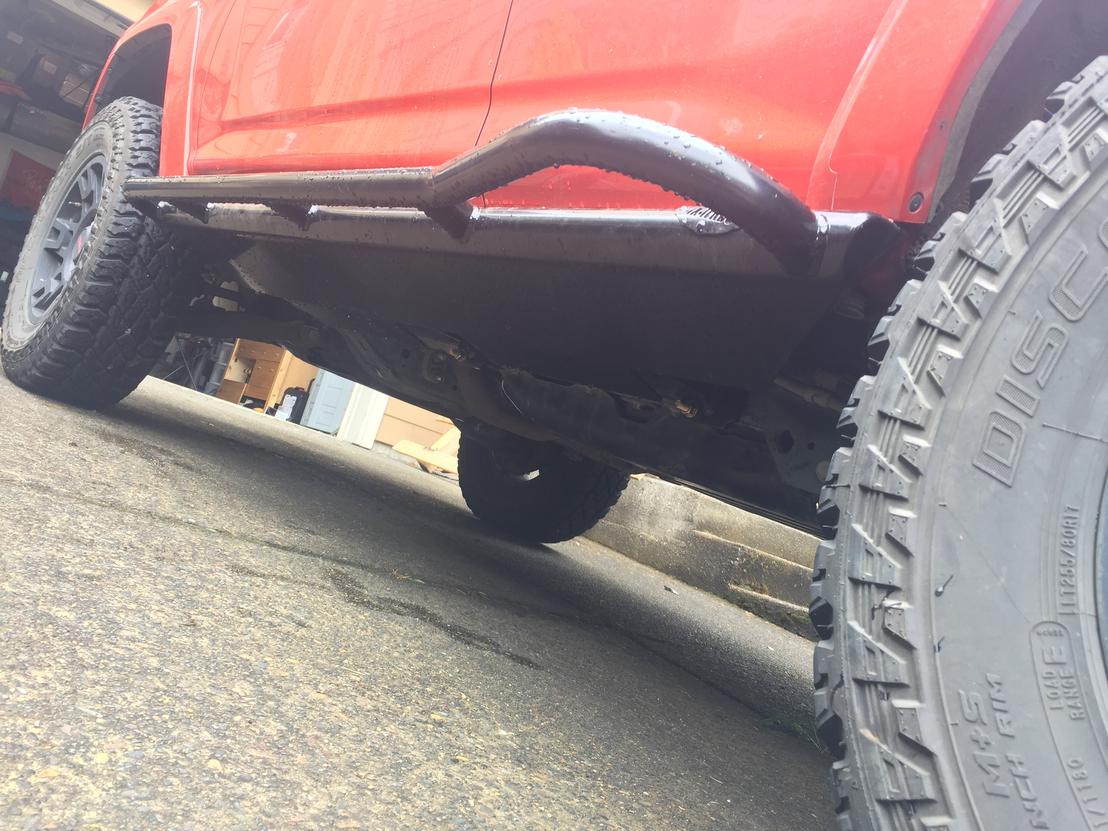

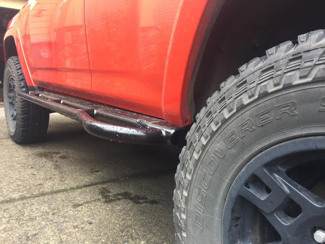

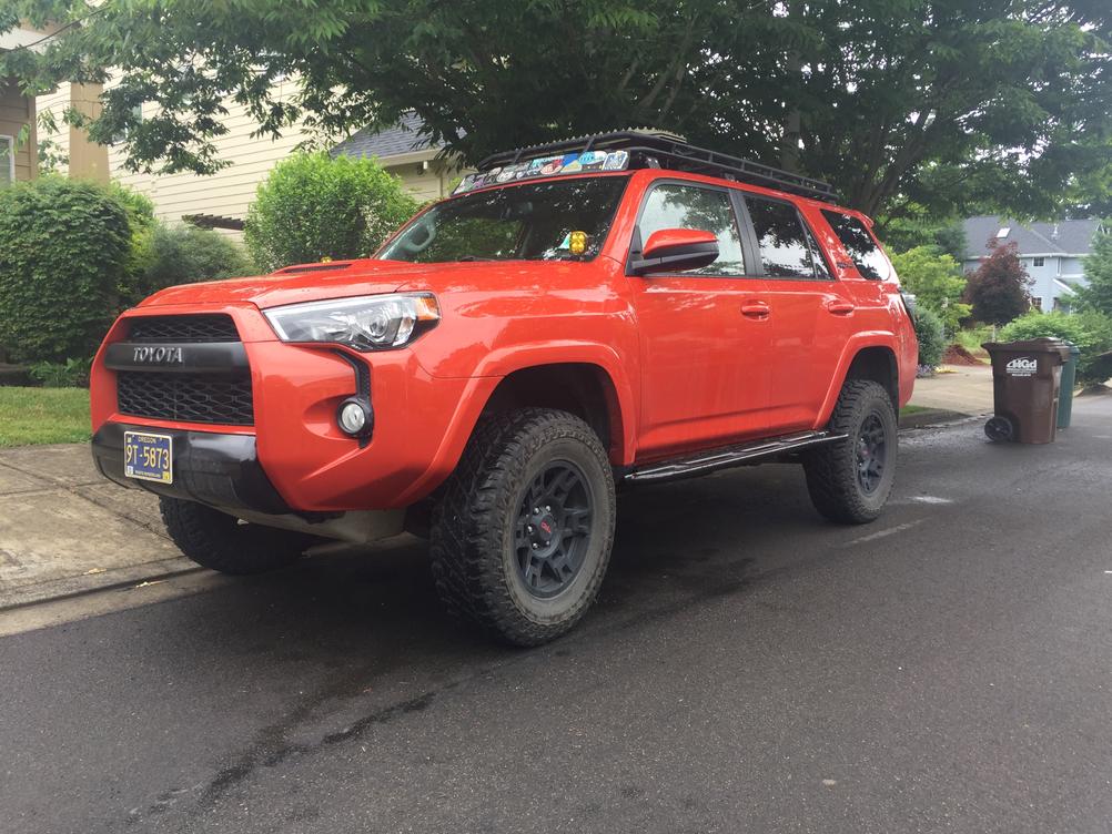

Mostly* installed 4x4 labs sliders
The other night I got my sliders mounted up, with the exception of the front U-bolts on each side. Seeking some advice from others who might have installed them themselves or watched the process closely enough to know what I'm talking about. [MENTION=89562]bimrunner[/MENTION] [MENTION=129593]MTN4RNR[/MENTION] [MENTION=113049]rochmpr[/MENTION]
The issue I had with the fronts was that the massive nuts they provide don't fit in the very tight space between the frame and the cab (I couldn't get a good picture, but if you've done this install you will probably know what I mean). My plan now is to get a shallower nut, but even then it's going to be a real pain in the ass to get it threaded. If that fails I'll try giving the guys at 4x4 labs a call on Monday and see what the trick is. Am I missing something?
Other impressions and pros/ cons of the sliders just based on what I've observed so far:
Cons: $$$$, heavy (67lbs each), PITA to install, had to be proactive with communication to get them shipped when complete but the guys are awesome to work with... that's about it.
Pros: Full protection underneath, huge surface area to stand on to access rack, quality and fitment is amazing, heavy (pro and con), 5 week lead time, as high clearance as sliders can get.
Here are some crap pics:

Take the front wheel off, my front... I can get after it from the front... jack it up a little. I do have an LE so when my whole rocker came off it has a little easier access. Looks like you still have a small part in there. I can take a pic of what mine looks like if you need it.
You basically have to have the unbolt go directly into the nut as soon as it goes around the frame. It's not fun or easy but once mounted, it is super strong!
Thanks, I think I see what you're saying! I did take all the rocker trim off but was able to fit the end cap on the bottom of the fender back on. You're right, the nut will have to be ready to go as soon as the threads on the bolt go through as there's just no room to do it any other way. Should be a real treat. And yeah, even with just the back two bolted on I can hardly get these suckers to move, awesome design!
