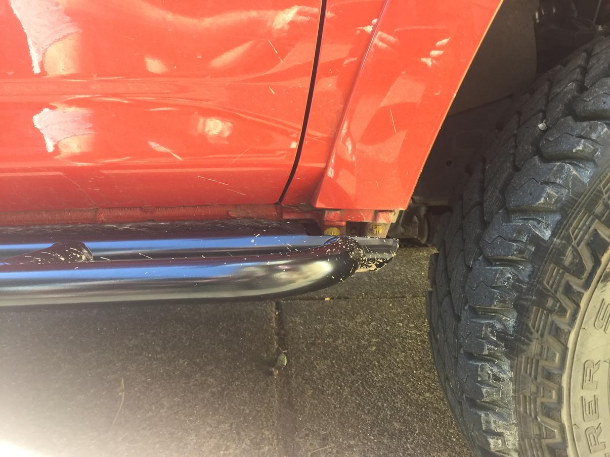

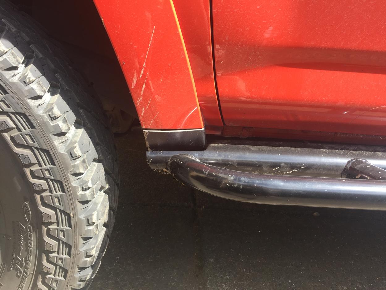

The issue I had with the fronts was that the massive nuts they provide don't fit in the very tight space between the frame and the cab (I couldn't get a good picture, but if you've done this install you will probably know what I mean). My plan now is to get a shallower nut, but even then it's going to be a real pain in the ass to get it threaded. If that fails I'll try giving the guys at 4x4 labs a call on Monday and see what the trick is. Am I missing something?
Hey, apologies for the delayed reply. After talking with the above mentioned guys before purchasing my set of sliders from 4x4 Labs, I had Luke and his crew install them at their shop, I am fortunate to be close by. I didn't want to deal with trying to wrestle them, by myself, in my driveway on my back haha. When they installed them, they removed the rocker including that front plastic end cap that your photos show still being attached. As [MENTION=89562]bimrunner[/MENTION] mentioned, the trick as I remember is to get the nut lined up with the u-bolt as you slide it through, then use an open ended wrench to tighten. It's a tight fit, but strong as hell in design. I have used them extensively to make up for my lack of lift on trails that I probably shouldn't have been on. If you have any other questions, PM me and I'll help as best I can :thumb3:
Hey no worries, thanks man. I did have to take both plastic end caps off to remove the rocker trim, then when I got the first slider bolted up I looked at that spot and realized that I could probably fit it back on and it would look cleaner, so I did that before mounting the second one. Going to loosen everything up today and try to get those front bolts on and put the other end cap on. Not looking forward to it haha.
