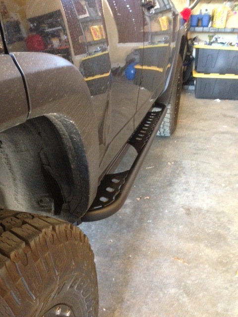

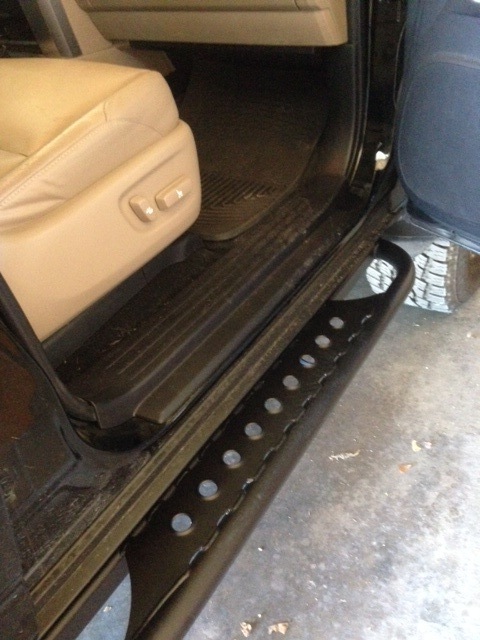

I got one Shrockworks slider-step installed this weekend. Then, my wife (who's very pregnant at the moment), found something "more important" for me to do....so I guess I'll be driving around lop-sided for a couple days. :shrug:
Looks good so far though!

Looks great KC!
Was it a fairly simple instal?
You have any pics of the back with the door open?
If you are not too busy taking care of the most important thing to happens in ones life :D ...When you ordered those up, what did you specify for get the style/step/ect? Was there a template stashed away somewhere? I really would like to get something similar, my dog has a hard time jumping in without running boards (like I had on my last t4r) and most sliders look like he could slip a paw through and hurt himself.
Yes, I basically described what I had in mind and they showed me a couple options based on some FJ slider steps they had done previously. PM Shrockworks or [MENTION=63082]TxBxSx[/MENTION] and they'll help you out. They're very nice and easy to work with. And, of course, fit-and-finish is superb.

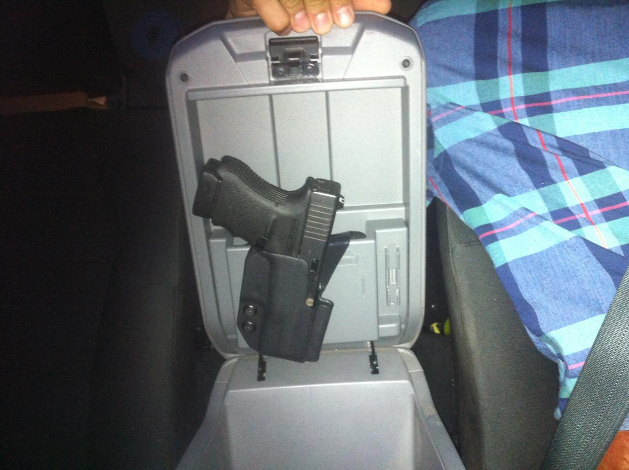

Paddle Holster with Glock 30

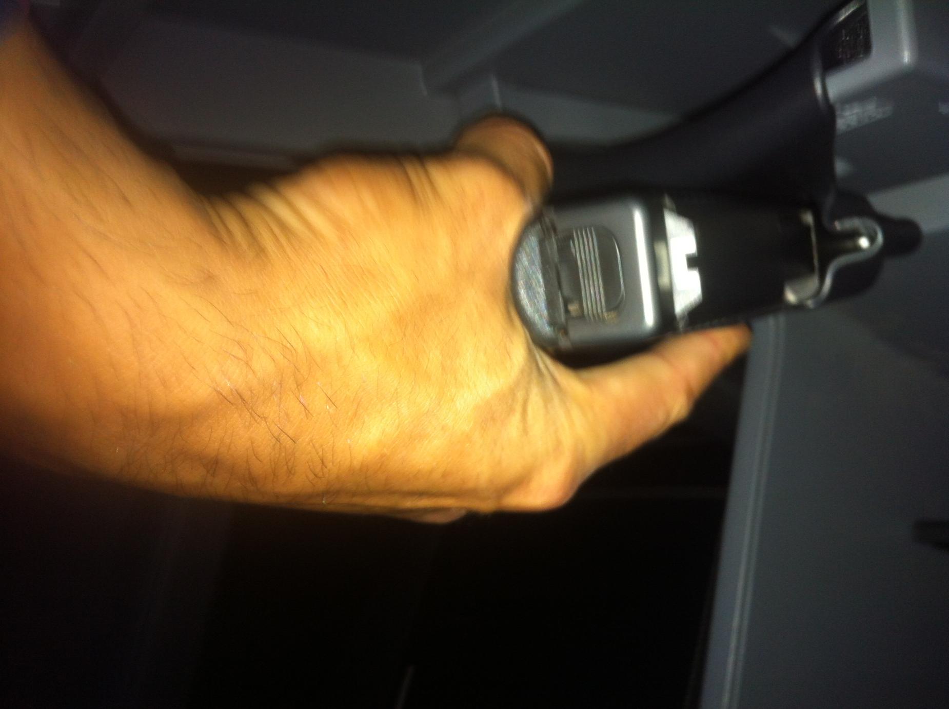

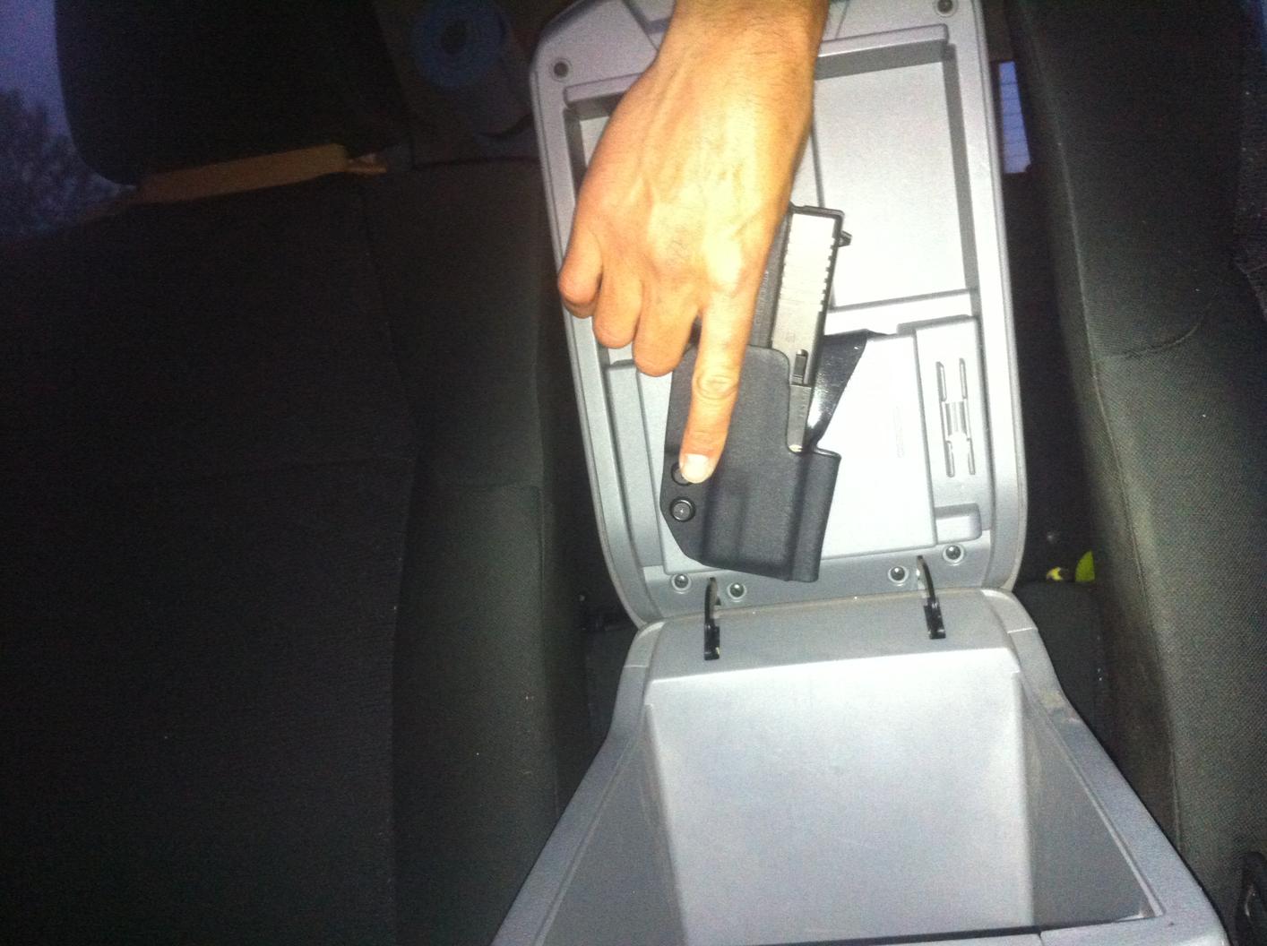

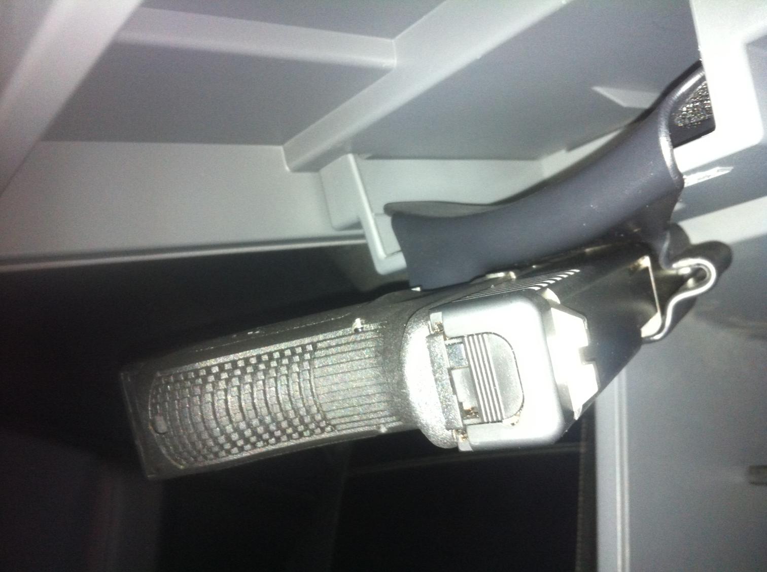

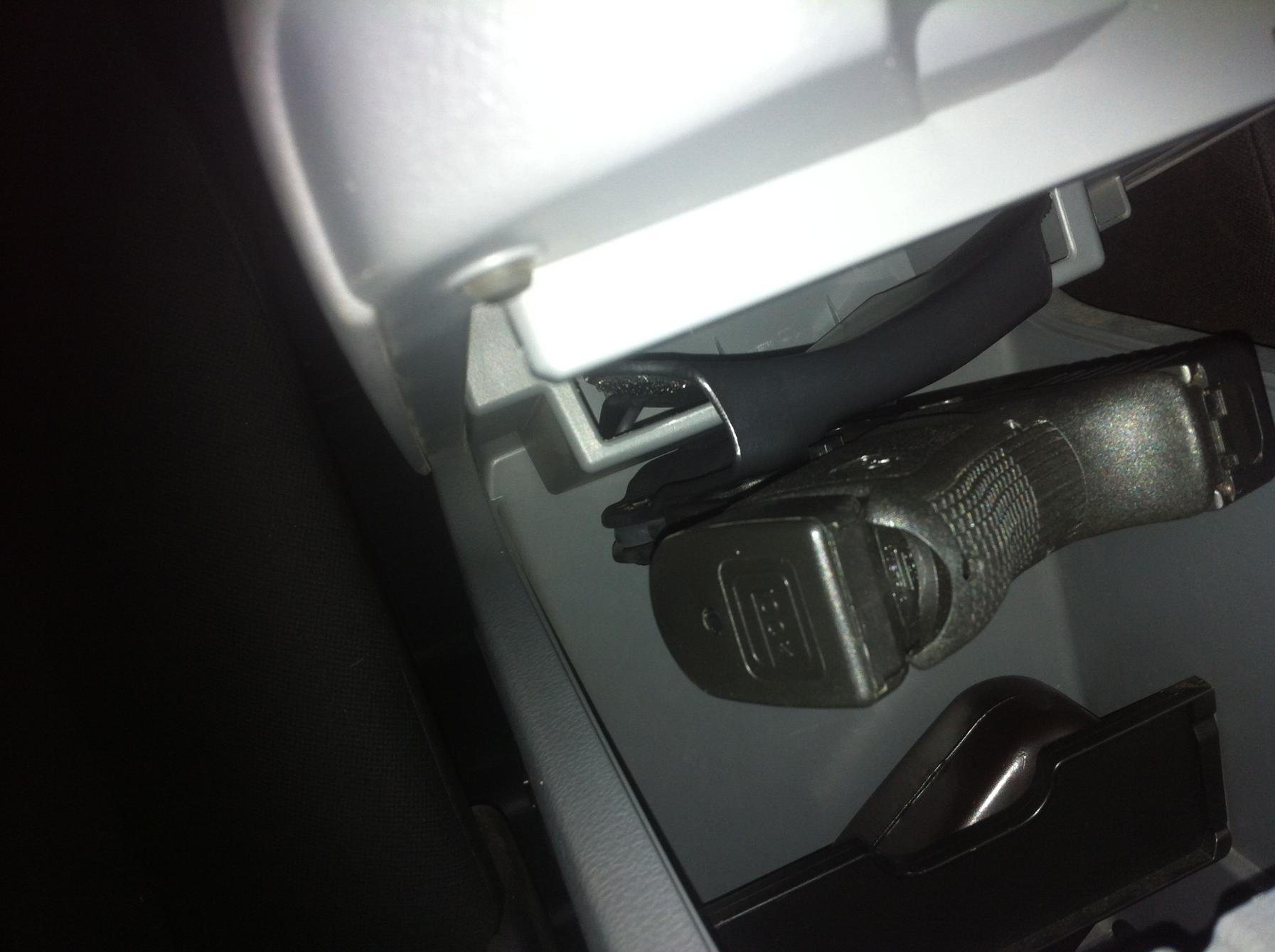

So I travel primarily on my own and after a recent encounter with three idiots in a single cab GMC, I thought it was time to mount my .45 in my center console. I used my paddle holster (which happened to be on my body at the time) and it fits like a glove. As you can see the subcompact Glock 30 fits unbelievably well and can still be drawn extremely quickly. I'm not going to get into the overall details of the encounter, other than it was midnight, I was in the middle of nowhere camping, and the conversation ended very quickly when one of them said "I want those lights"...referring to my light bar. I do believe that the best way to avoid confrontation is to avoid confrontation...(if that makes sense) I never look for a fight, but when one presents itself...BE READY for anything. I will say this...I spent 12 years as a Recon Marine and they were lucky I was a good mood. :lol:
