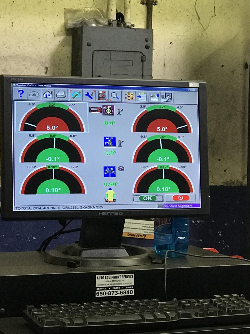

Installed Total Chaos UCA over the weekend and went in to get an alignment with my trusty mechanic. Was able to get 5 degrees of caster and even toe and camber. Steering feels heavier and tighter (which I prefer) and the ride is feels much better. It did push the front wheels forward more due to caster and I had to trim my bumper and push the fender liner forward more.

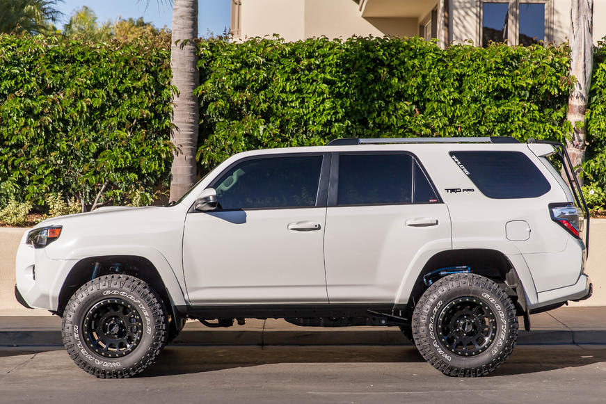

Busy week last week and this week! My buddy installed my whole suspension setup in his driveway between last week and this week. We managed to adjust the King Coilovers in front with the help of the T-Handle Punch that King sells for about $35. When we were installing the new UCA, we took the stock UCA off, had the Kings bolted in at the bottom of the shock mount where it bolts up to the LCA, and before putting the top of the coilover in the top bucket, we cranked the coilers up 7 full turns. Without any threads showing, King claims that the coilovers give the 4Runner about 1.5" of lift, so with 5 full turns King says it increases the ride height by 1" or so. So overall, I have about a little over 2.5" of lift in front if what Kings measurements say is true. Hope this helps anyone out that is wondering. Got it aligned today so now everything is all smooth sailing!
Mods:
King 2.5 Extended Travel Front Coilovers w/ Compression Adjusters
King 2.5 Extended Travel Rear Shocks w/ Compression Adjusters
Light Racing SPC Ball Joint Upper Control Arms
Dobinsons 1.25" Rear Lift Coils
285/70R17 Goodyear Duratracs w/ Whitewall Out
17" Method NV Matte Black
Gobi Ladder
Tinted Windows (About 15%)
