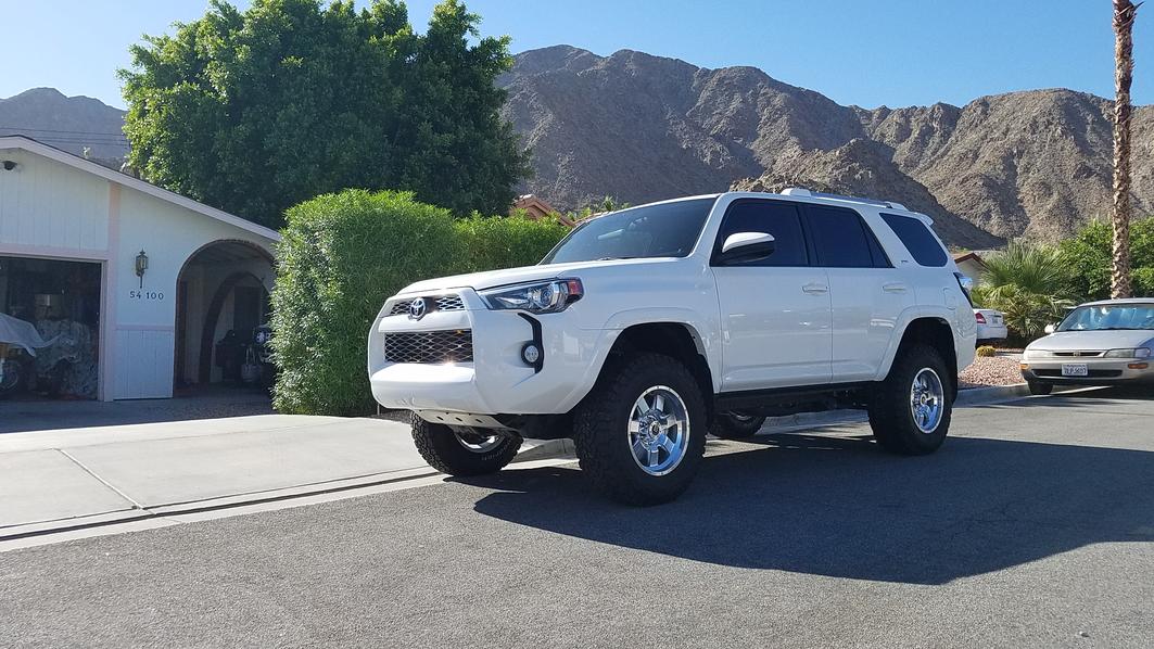

Finished the install yesterday, JBA’s, 5100’s all around set at 0 with Wheelers T1 and T12. Caster for days.
Forgot the grease zerks on the bushings:fish:
They don't get greased guys. They use OEM Toyota bushings, no grease. Those holes are there to allow air to escape when bushings are compressed.
With that said, don't forget to tighten up that sway bar bracket bolt on the frame!
+1
This was taken mid install, she’s all tight and torqued down now!

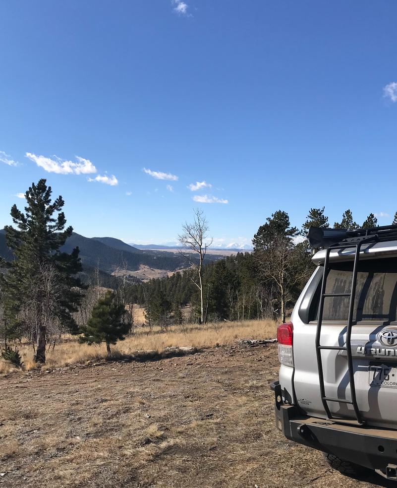

Got out on some easy trails and camped in the cold.

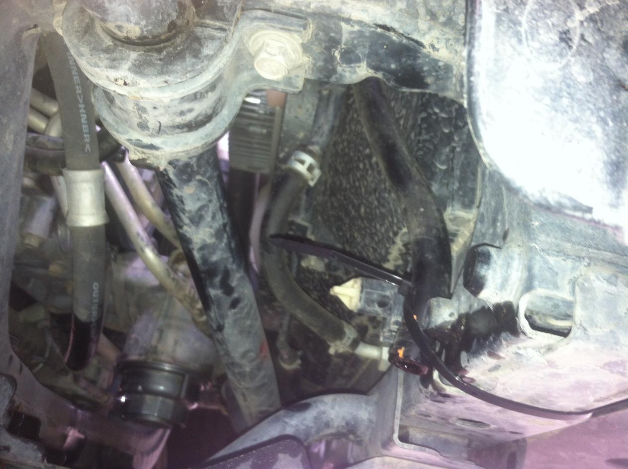

Tranny fun
https://www.tacomaworld.com/threads/diy-full-flush-for-automatic-transmission.68462/
Followed this thread to do a full 13qt fluid swap. The only thing different on mine(2010 rwd) was the ATF cooler lines to/at the cooler, I was able to use the factory rubber hose off of the metal line, to dump into the catch bucket.(the hose that's zip tied to the rad support)
It's not my DD but I can already tell it shifts smoother, old fluid was brown, I wouldn't say burnt smelling but didn't smell fresh, didn't taste it(sorry Greg)

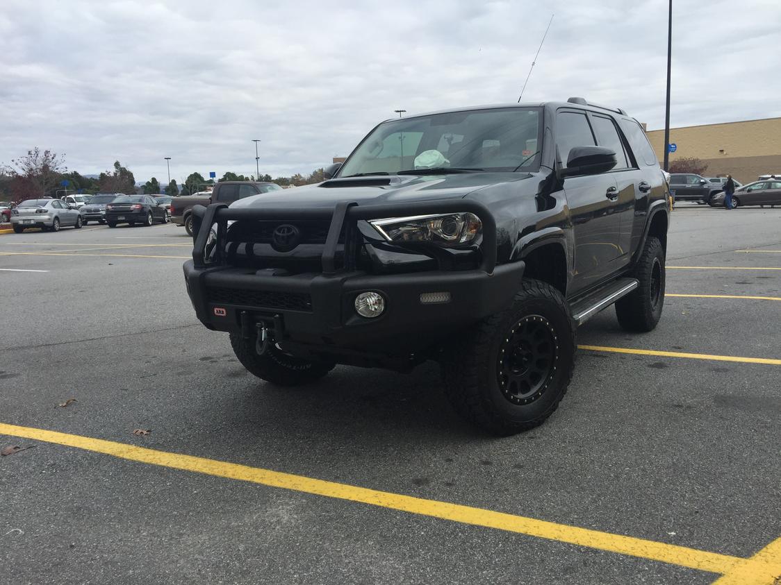

ARB Front Bumper and Wench
the ARB Sahara Front Bumper, Smittbuilt 12k X20 Wench and I buffeted out the pinstripes (hated them from day one).
