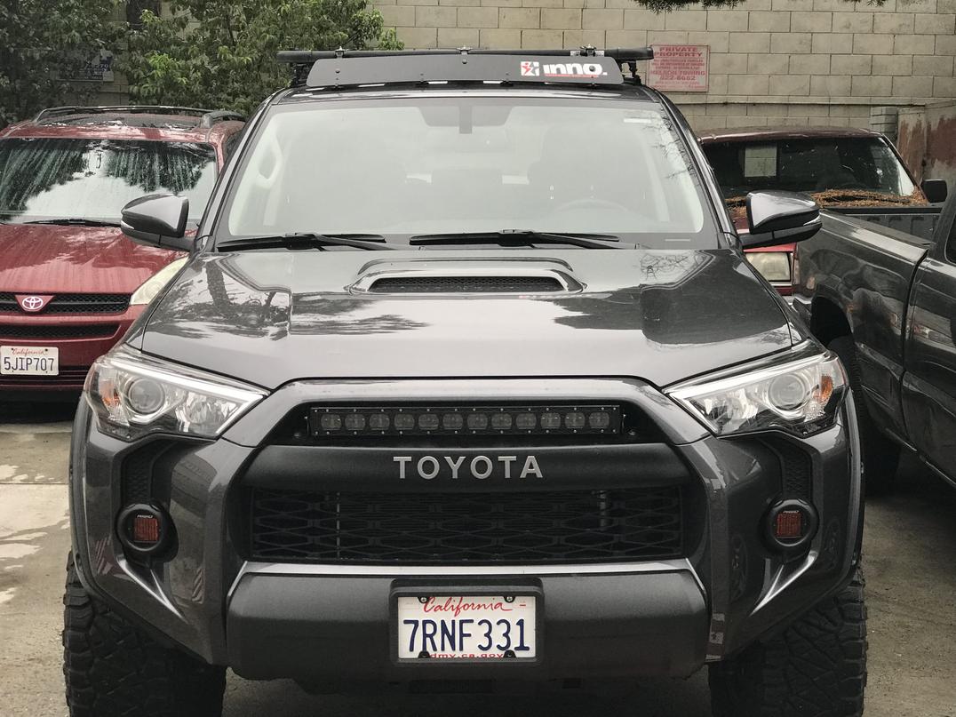

Added a wind fairing to my k9 rack to cut down on noise when the sunroof is open. This is the 40”. I may try the 48” to see if i like it better. I’ll probably remove the logo sticker as well.
As for the noise, it really works to cut it down.

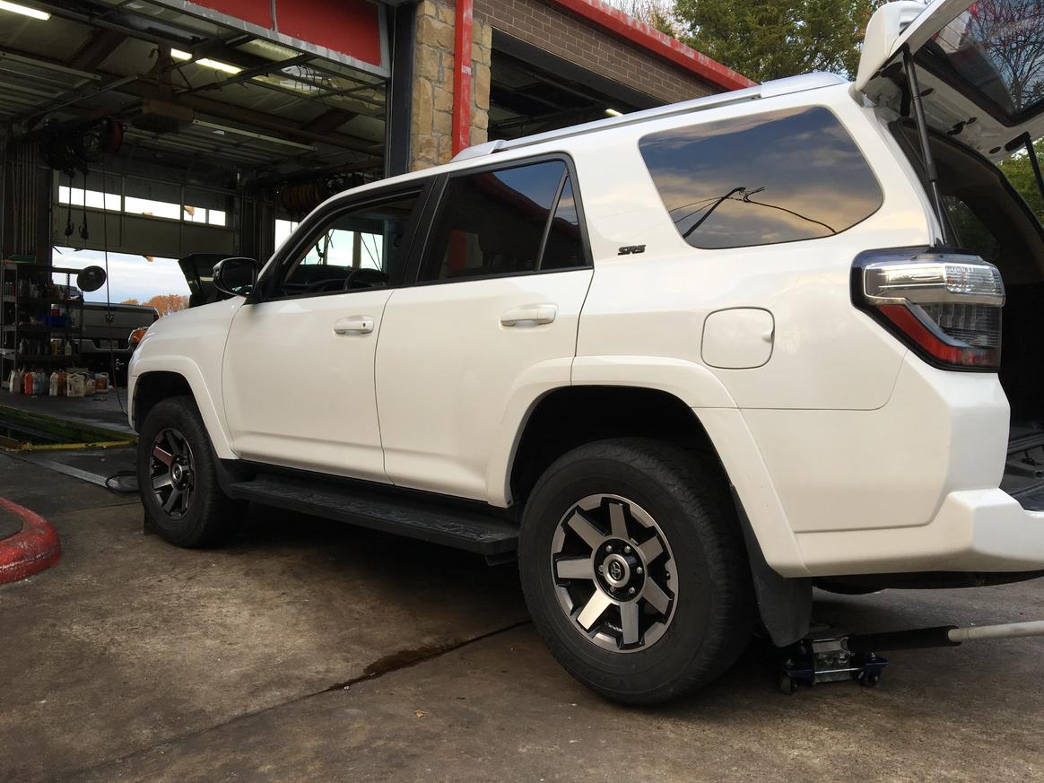

Thanks to T4R.ORG member RetroRod...who sold me his 2017 TRD OR take-off Rims...love the Trail/OR styling.

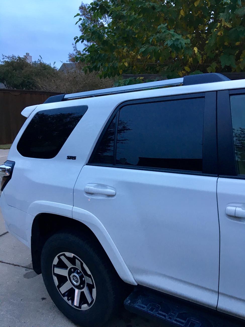

Also, Plasti-Dipped the end caps of the roof rack....super easy to pop off with an inner-tube/bike wrench

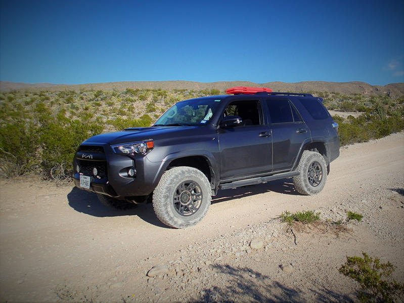

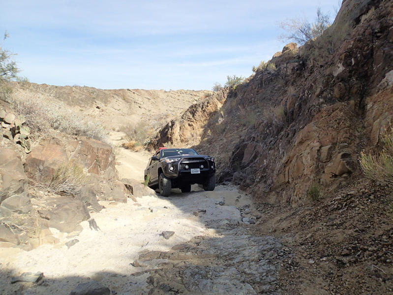

Spent the last few days in Big Bend National Park. Drove Old Ore Road (south to north) and Glenn Springs to Pine Canyon to Black Gap to River Road (north to south). Tons of fun and my 4Runner handled it all like a champ.

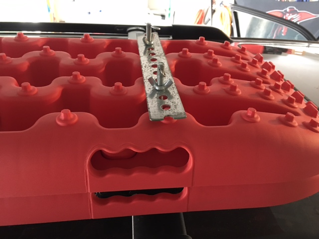

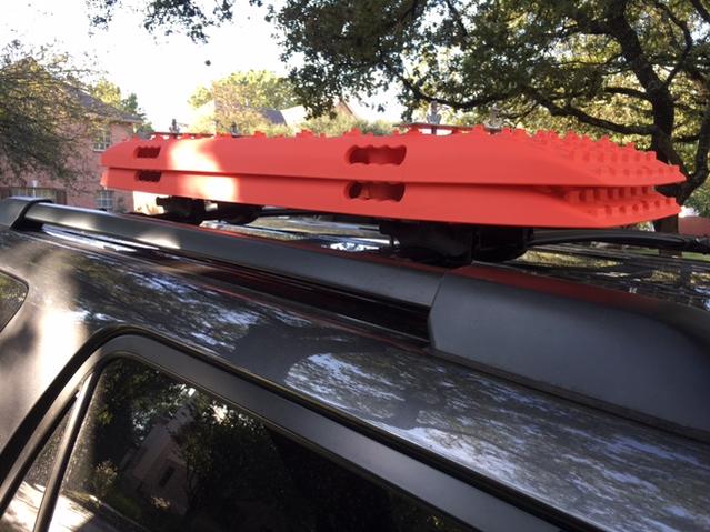

Looks like you mounted your recovery pads to the stock crossbars. Is that correct.

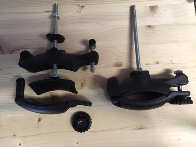

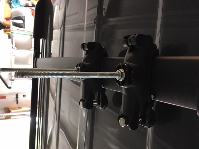

Yes. And here's how:
I used four Yakima Universal Mighty Mounts to clamp to the factory "aero" crossbars. I replaced the short bolts that come with the Mighty Mount with longer lag bolts from Home Depot. The bolts go through the mounting holes in the traction boards. I secured the boards using a metal strap and wing nut also found at Home Depot. Finally, I put a pin through the bolt just for added insurance against the wing nut vibrating loose (it didn't budge the entire trip, so the pin is probably over-kill). The traction boards are X-Bull boards bought on eBay for about $80.
