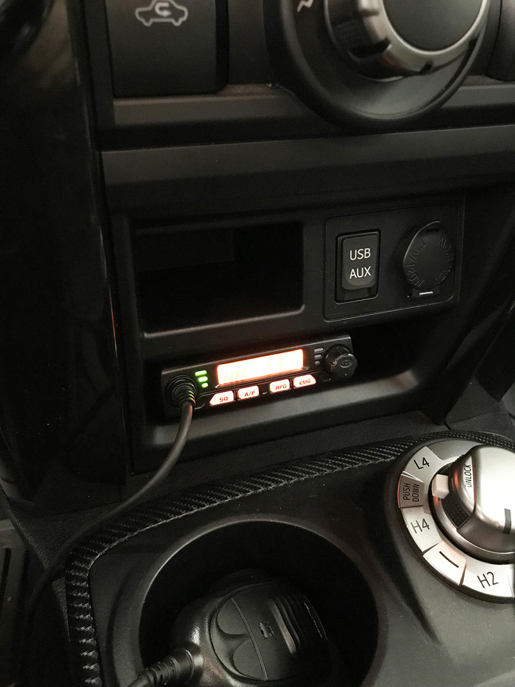

AnyTone Smart radio I modded it to run on 11 meter mode for dedicated CB.
Out of the box this comes only in 10 meter mode which is not CB, with a bit of soldering you can make it function as a normal 11 meter CB with AM and FM.
Love the size and power output of this little thing, you can mount it just about anywhere.

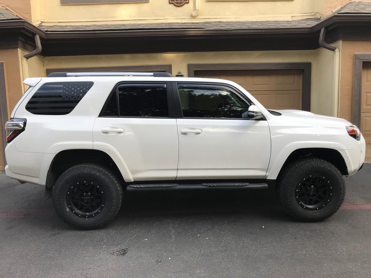

3" Old Man Emu lift with 285/70/17 Pro Comp AT Sport tires, Pro Comp Series 41 wheels and Pro Comp upper control arms.

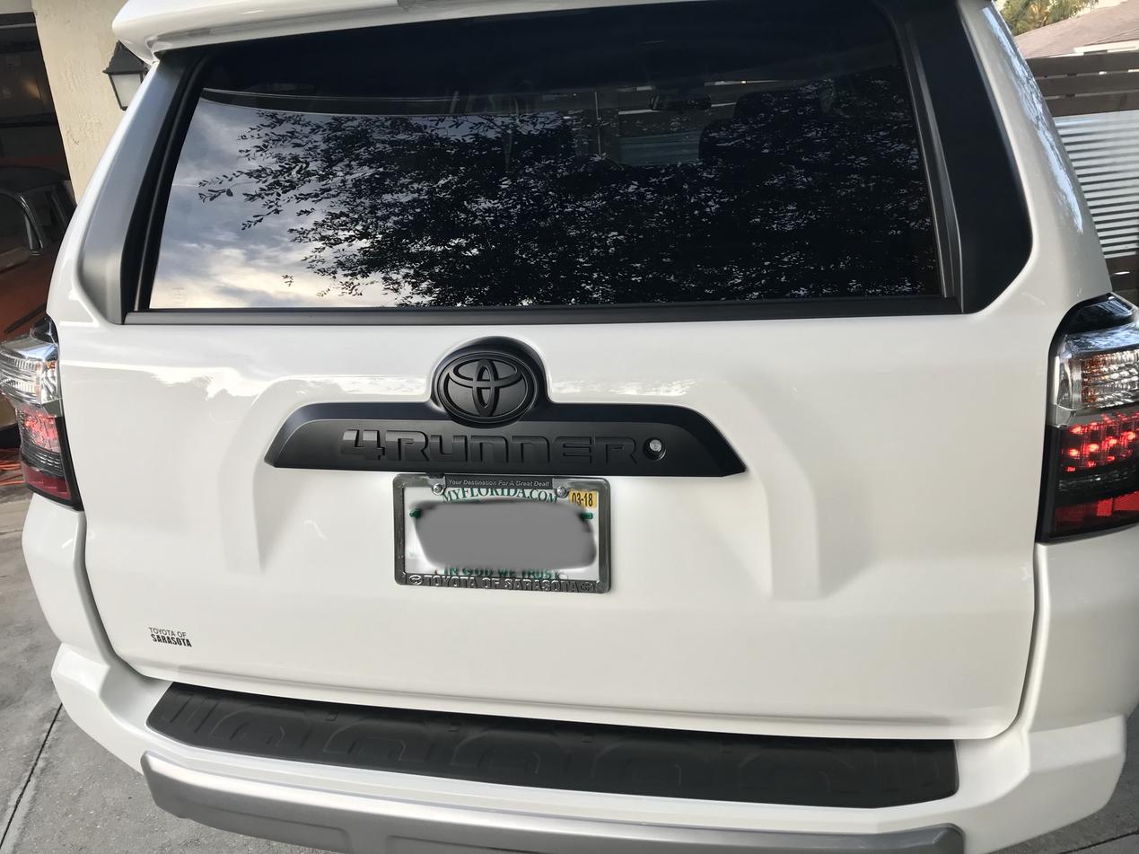

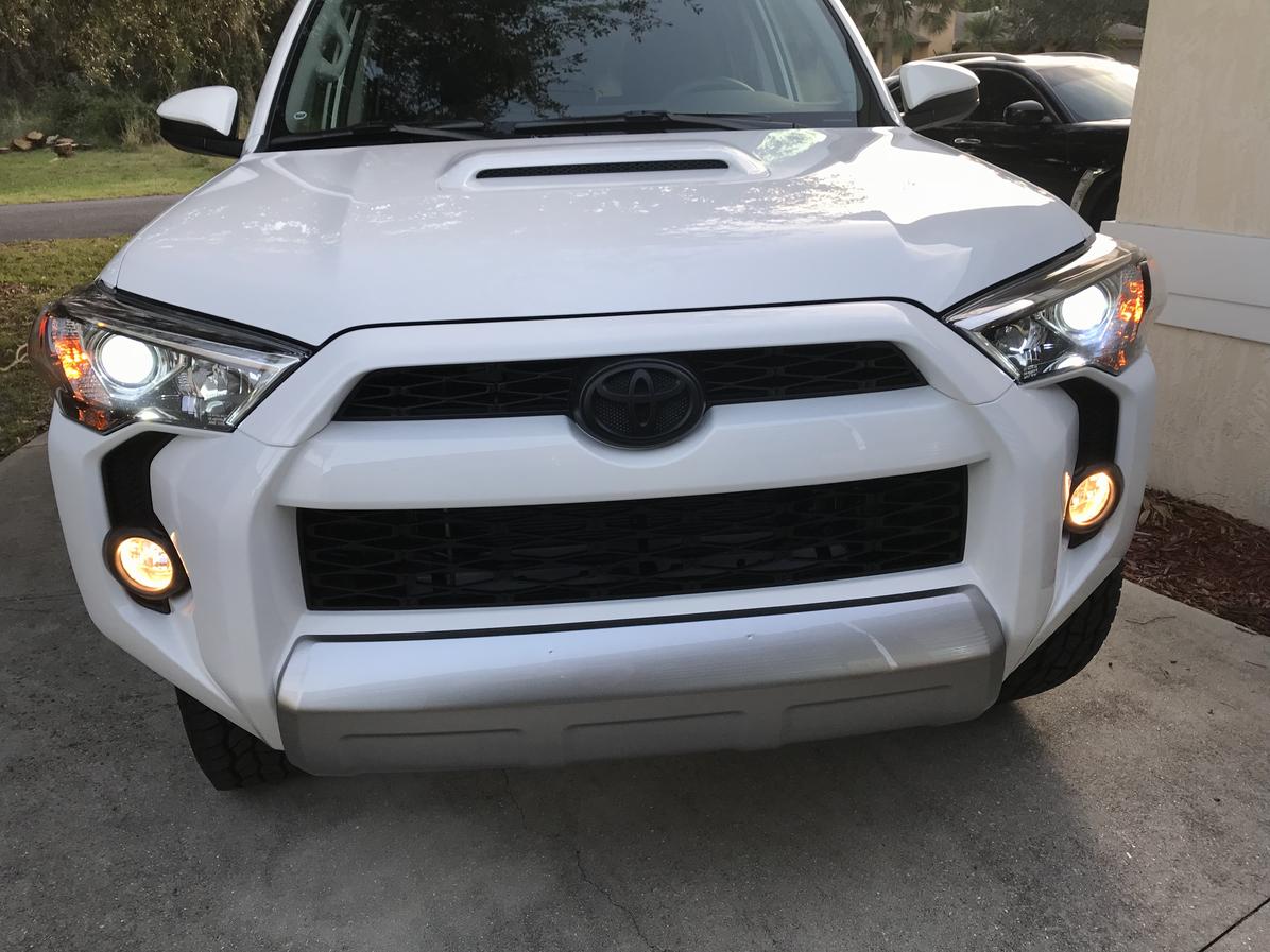

Taped off and dipped my front and rear emblems. It was colder than usual today so the dip dried a little crater-like, I didn’t think to warm up the cans in warm water till I finished them both. I then un-dipped the front and re-did it. Probably just going to buy the black out kit for the back. Then I installed my HID’s. I will install the fog LED’s later, miss placed my zip tie set.

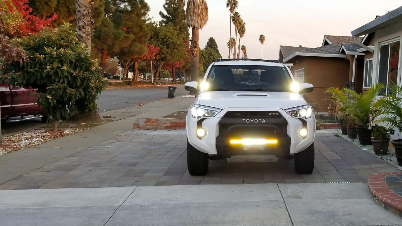

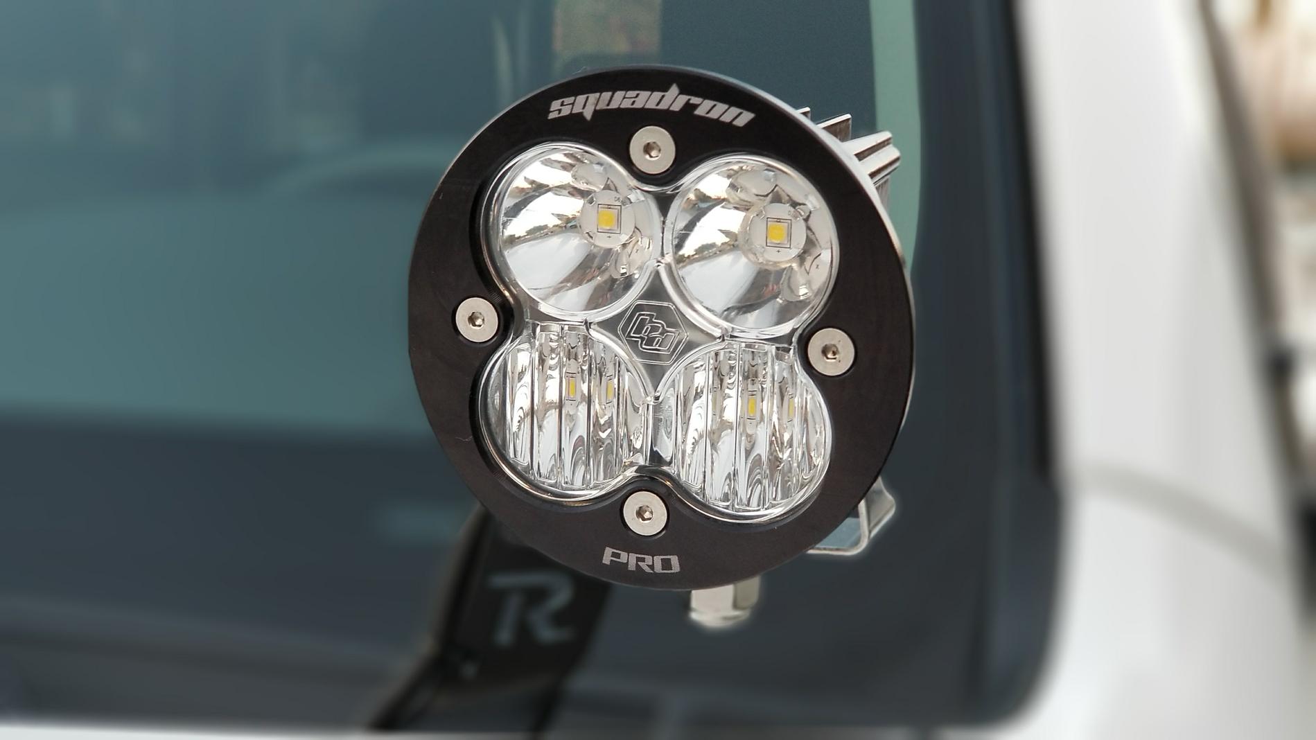

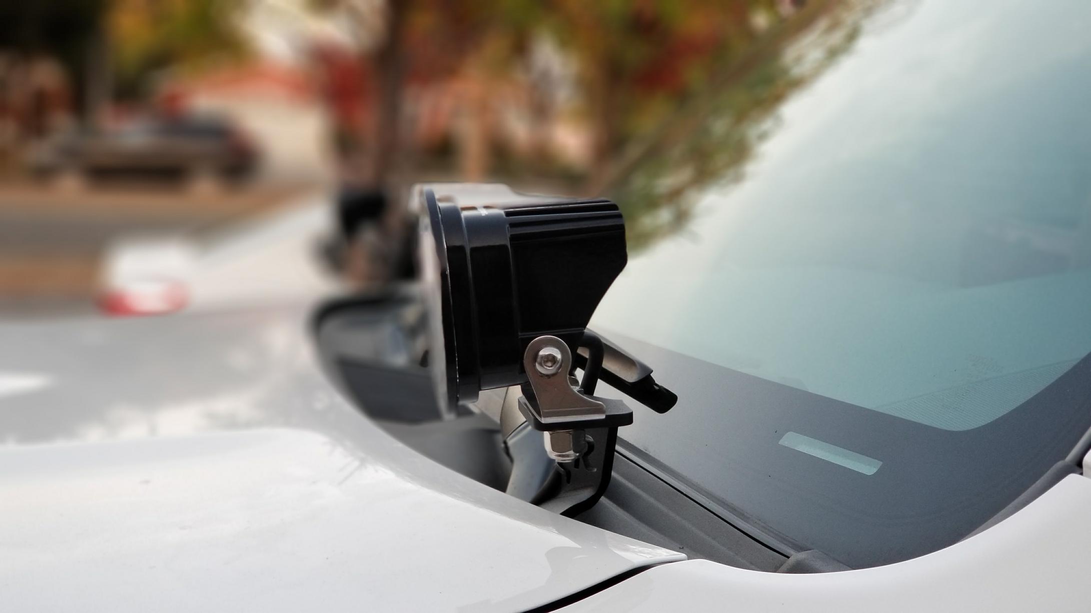

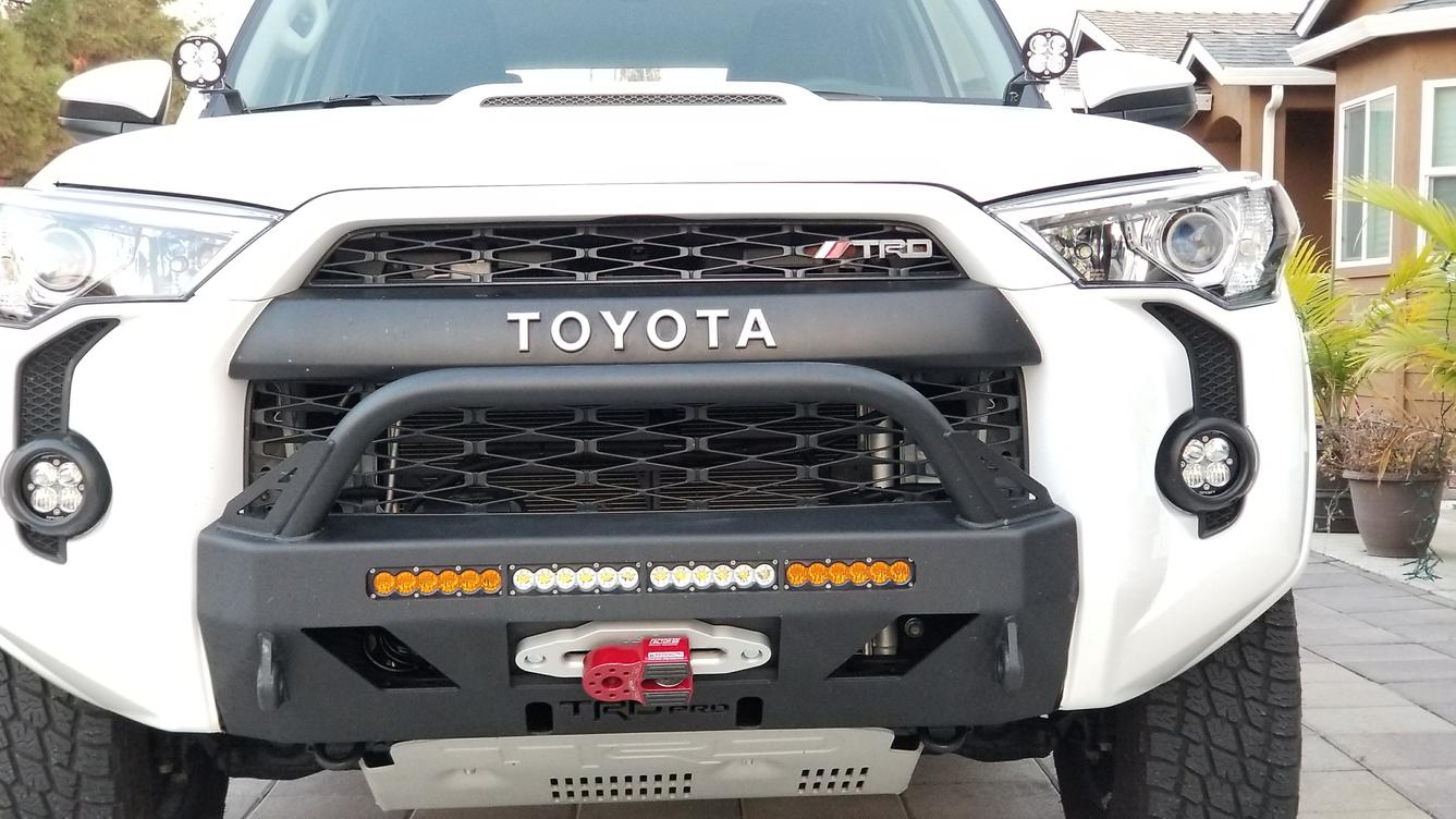

Rago Fab Ditch Brakets and Baja Design Squadron-R Pro LED.

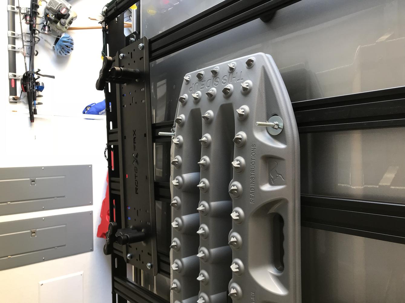

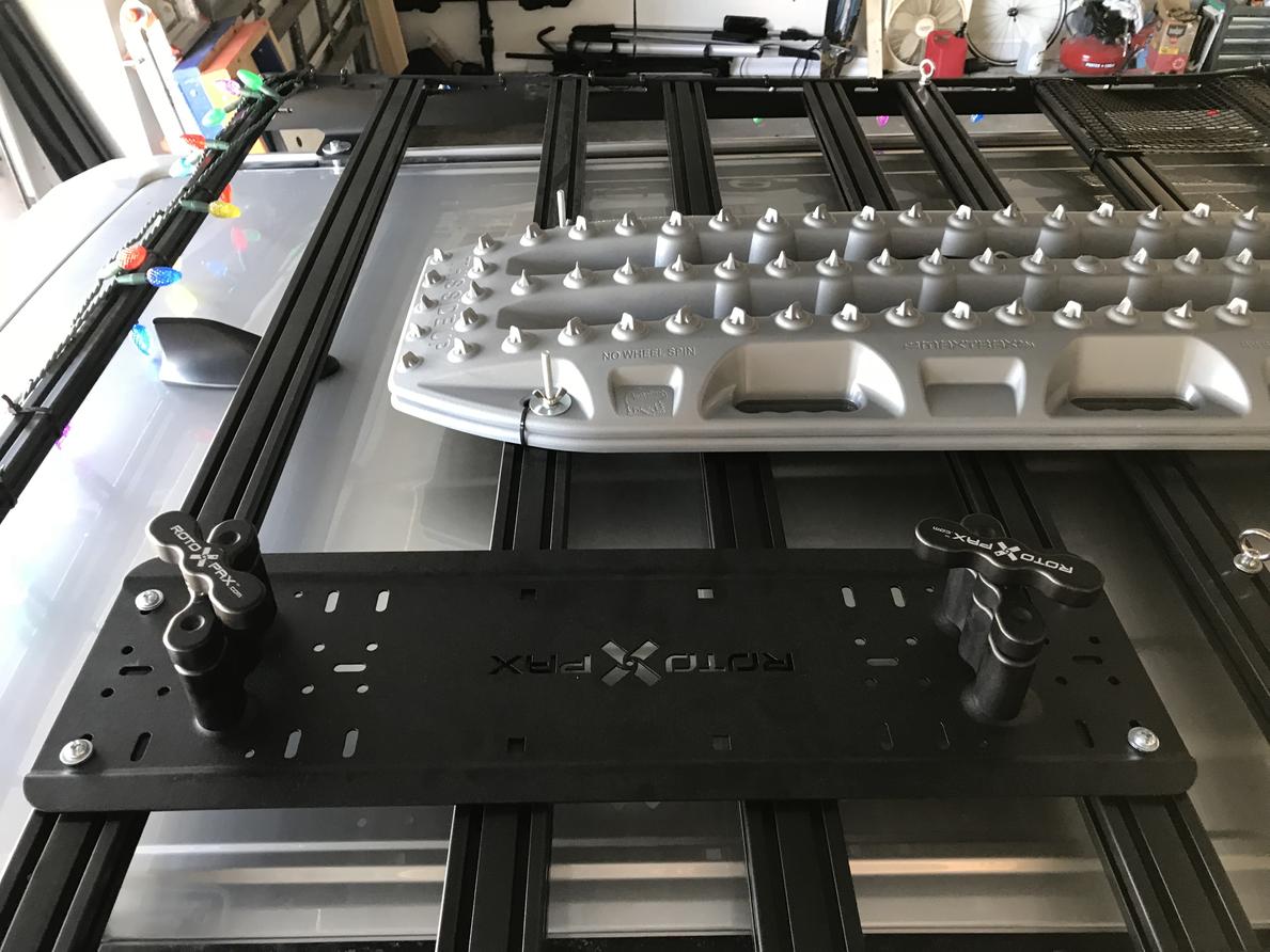

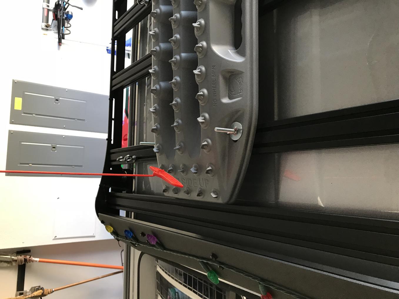

Where and how do you attach them?
Pics please...
Agreed.
1/4 carriage bolts, fender washers and wing nuts. When not in use they slide to the side and out of the way. Found a company to drill some drop ins. Waiting on the price.
