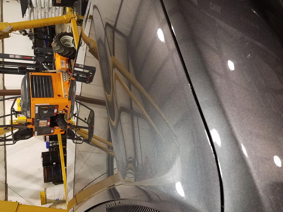

I waited about 6 months which was way too long. Started to wax and could feel the grit on the paint. Had to do a clay bar treatment on the whole truck before waxing. It was well worth the extra work though.

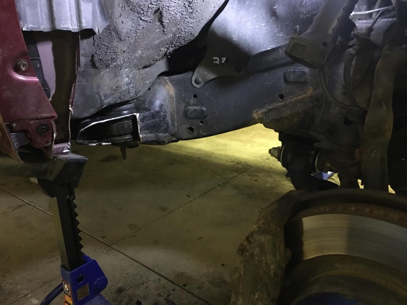

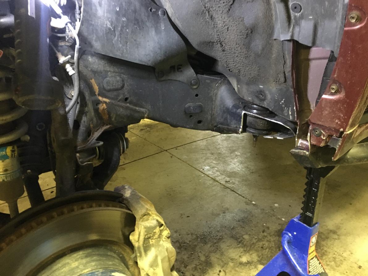

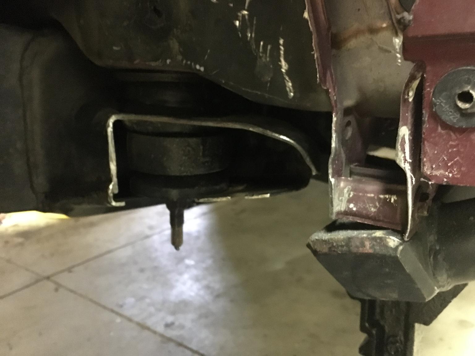

Yesterday I finally got around to doing my body mount chop. With my 305/70’s and Spidertrax spacers I no longer have any rubbing at full lock in reverse. Still have to check if it clears once things get flexing, but I’m fairly certain that I’m good and will be able to get it welded up soon. My passenger side rock slider was installed a little too far forward, so I do still rub that a little. Easy fix though.
I also finally greased my Camburg UCA bushings and replaced my rear sway bar bushings. The ride is much quieter and smoother now.

It looks like your slider contacts the body structure when you jack the Runner up?

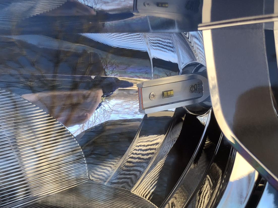

Drl disable and led high beams
Got my Xenon Depot LED Pros installed this morning. Easy install and look great. Gonna test them out tonight.
