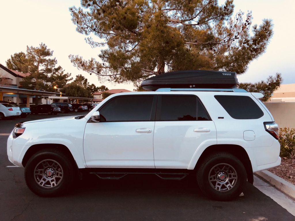

Bought a thule box and it clears my hatch perfectly... took a lot of research to find the right fit..
Thanks to some members for some input..
Curious - which model Is that? I have a Thule that’s 7 years old and it fit great on my last vehicle but not quite as well on the 4R.
Thanks

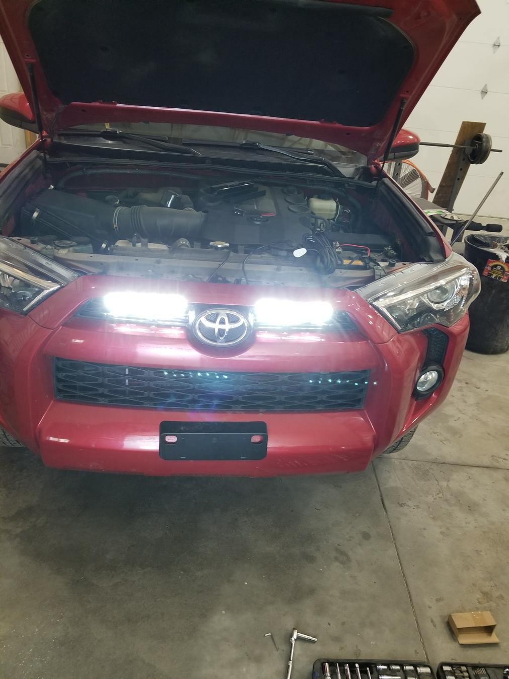

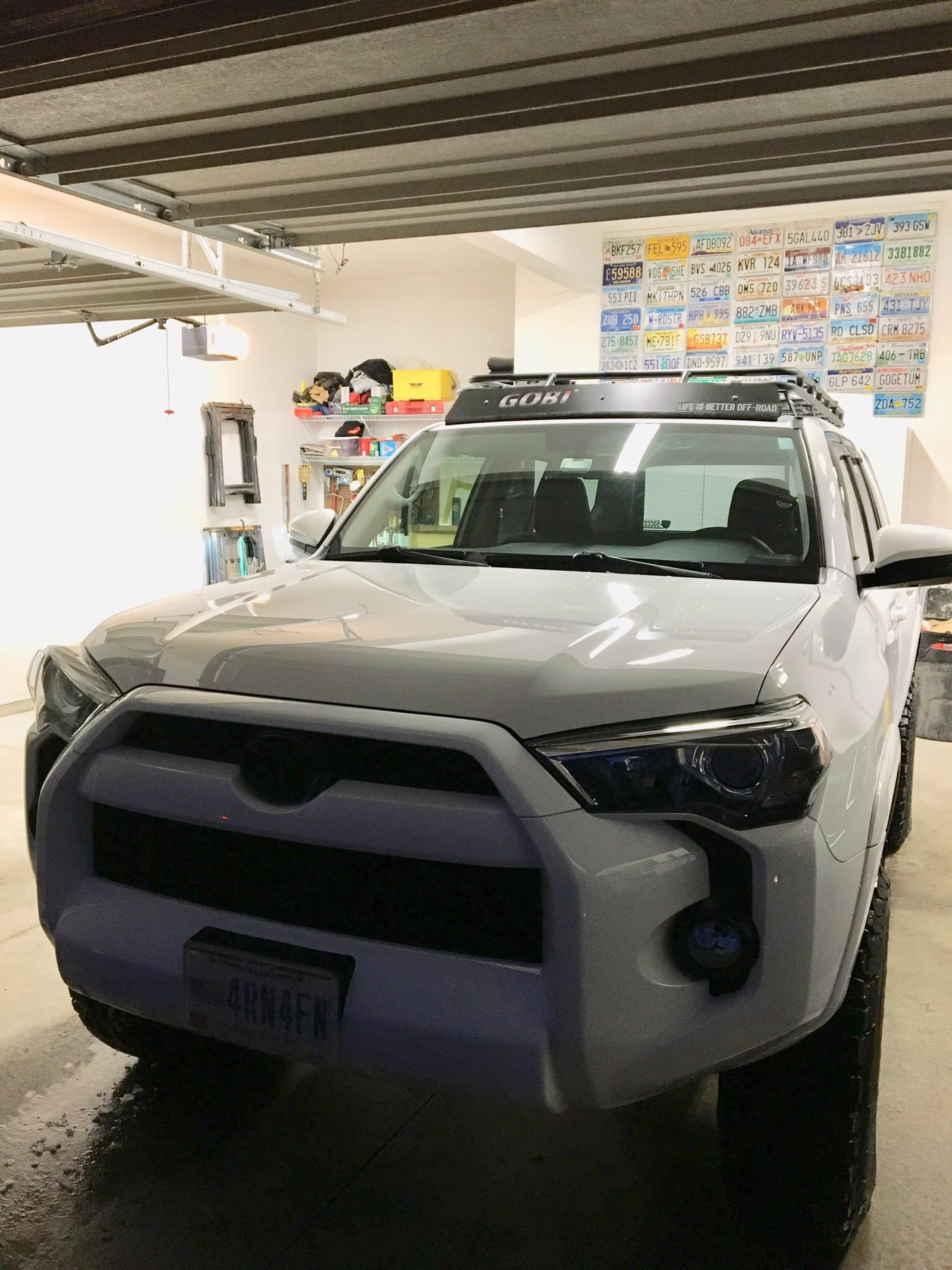

Put 2 lights inside the grill on either side of the toyota emblum. Took some custom brackets but it turned out great.

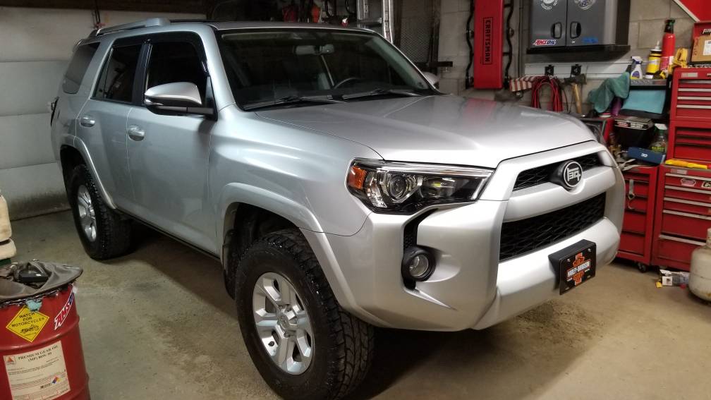

Lift done.
Tires on
Life’s good.
Edits: except for the fact this picture is massive and I cannot for the life of me rfigure our how to resize here or on Imgur. Sorry.
I think I got it now.

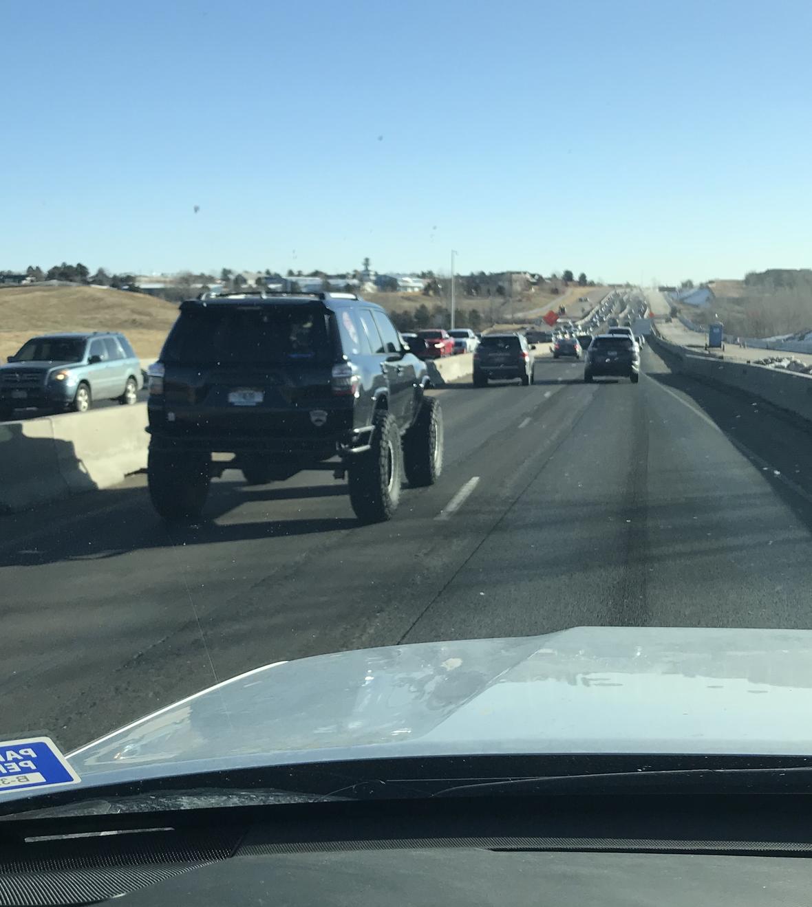

I had the pleasure of being passed by the RSG beast of a 4Runner this morning. The pictures do NOT do it justice, amazing on the road.

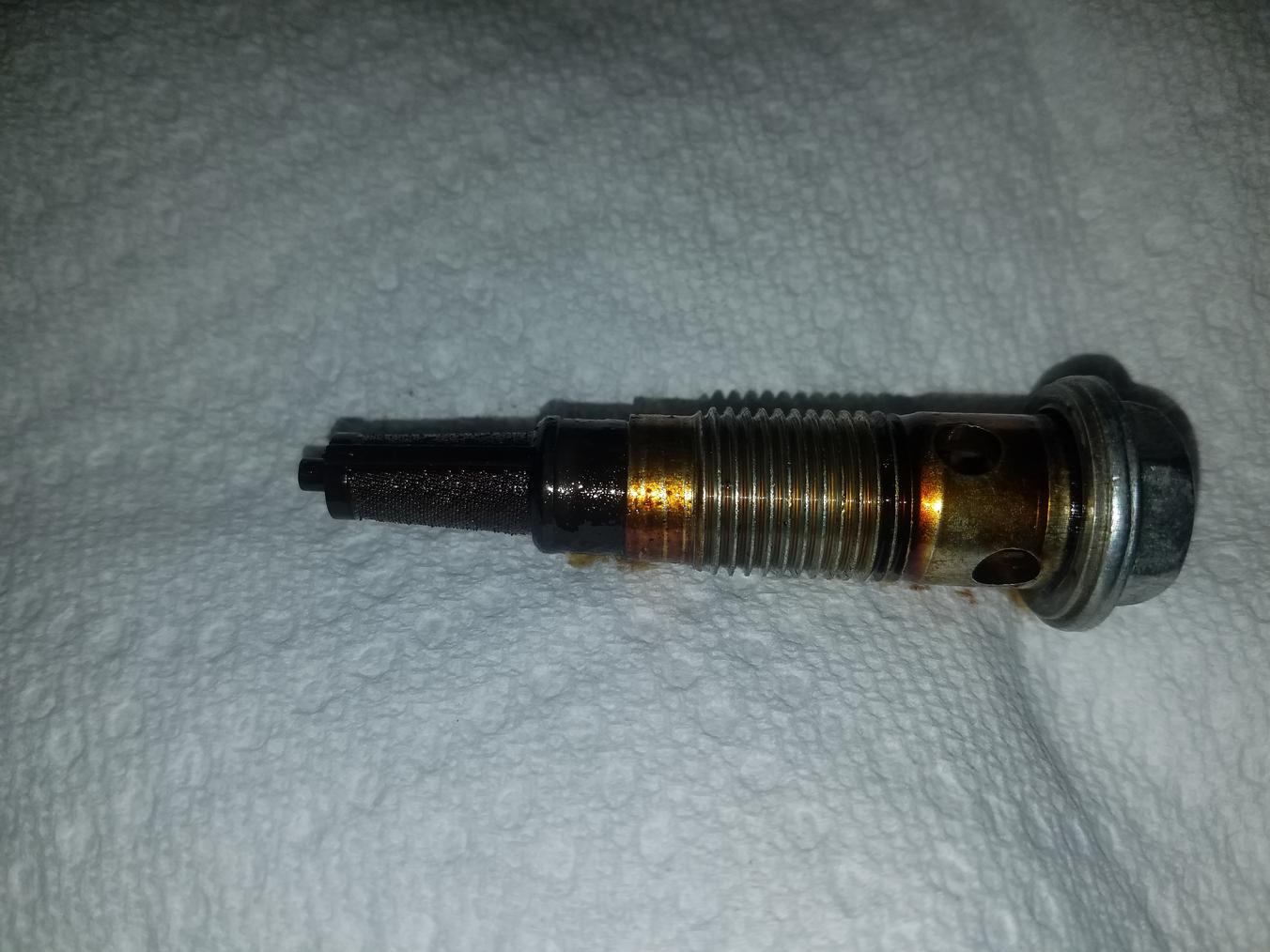

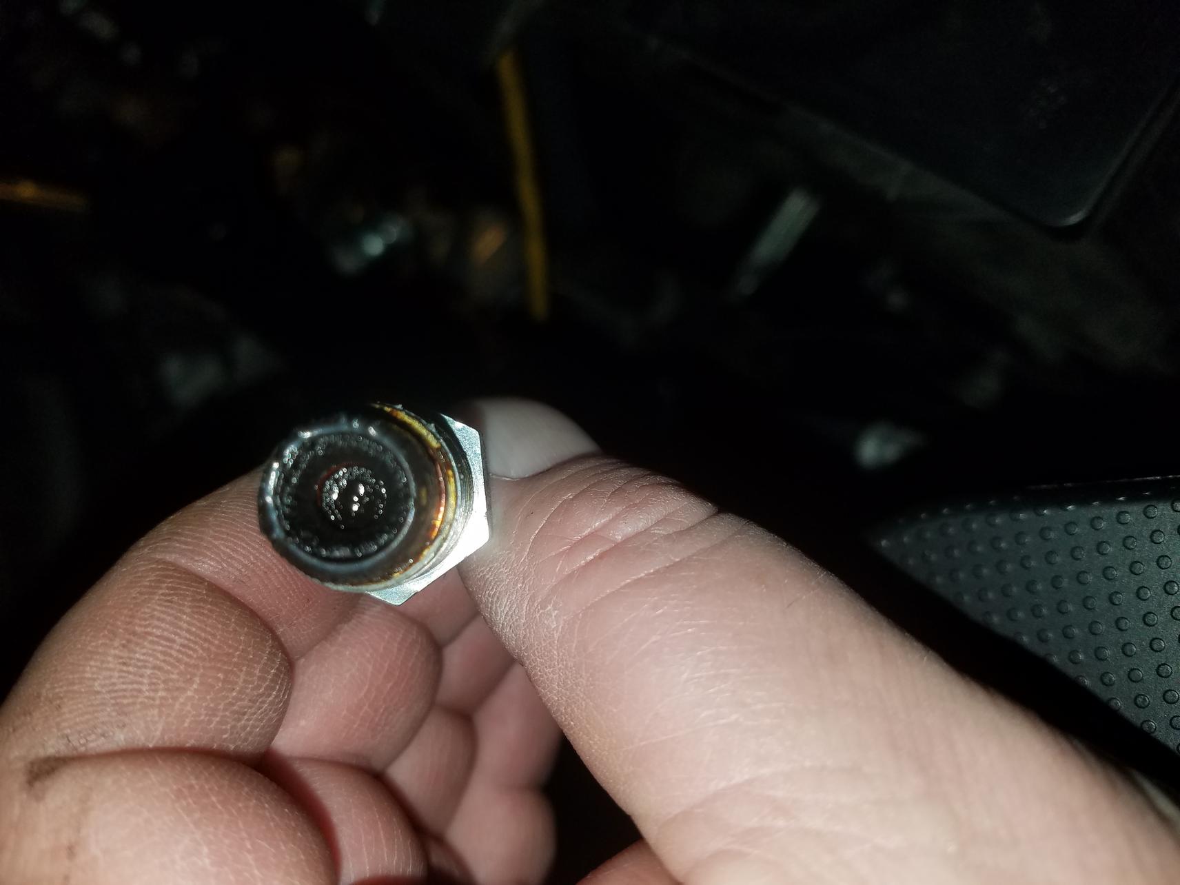

Cleaned the PCV valve, until I get a new one...
and both OCV filter/screens..
What did you clean them with?
I cleaned them with gumout and q-tips. Probably something better out there, but that is what I had handy. The screens are metal with a plastic housing. I will inspect them again in 100 miles or so and replace if needed. Cheap and easy if you have the parts.

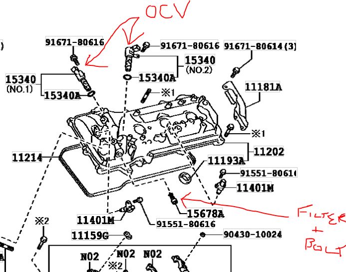

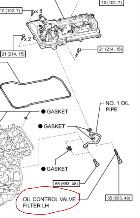

good god that's a filthy pcv.. But what in the world is an ocv and where can i remove mine for cleaning
There are two filters, one LH and one RH. I didnt pull the OCV's, just the filters. See below.
