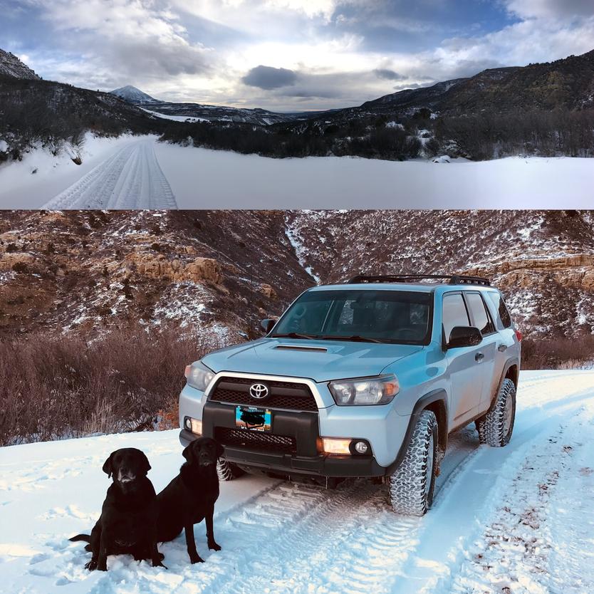

Went for a quick drive up on e of the local gultches. Great view up there. Considering the only tracks before us was a snow cat we got back in a good ways before things got too steep.

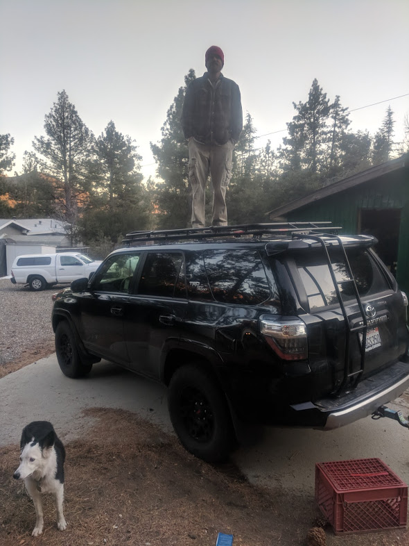

On Sunday we installed our Gobi Rack! This thing is awesome and can't wait to use it for our adventures. Installation was straight forward and pretty easy. Just need some help to lift it on top but is pretty easily a 1 man job outside of that.

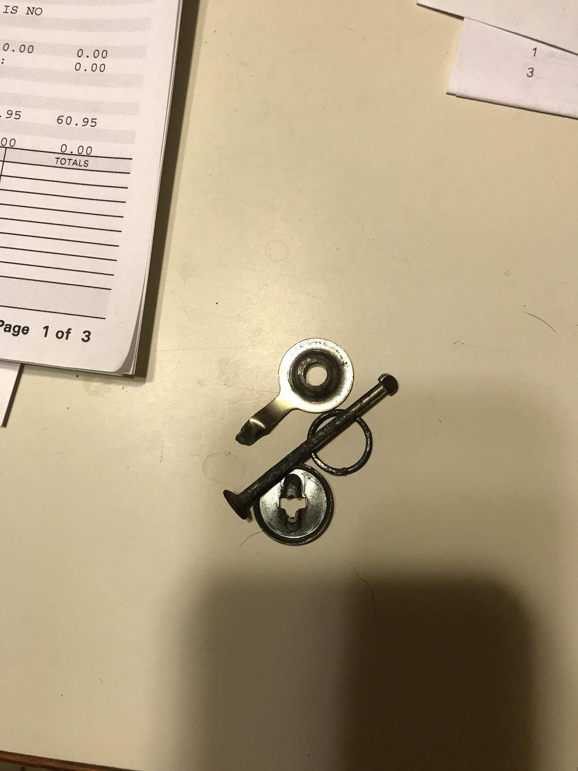

I got my parking brake fixed after I had some new brakes installed at the dealer (would have done it myself but this salt up here is brutal on hardware and I didn't feel like putting the effort in on the caliper bolts and pad retaining pins after I pulled the first wheel). Heard some scraping yesterday, sounded like drivers rear, jacked it up in neutral and parking brake off and couldn't turn that wheel by hand. Had to loosen the parking brake to pull the rotor off and these parts fell out of the shoe. Looks like the remnants of a spring that holds the shoe back from the inside face of the rotor...
Not sure if they had adjusted it too tight or what happened...:rockthrow:

Uh, looks they messed up bad. They didnt spin the "lock" washer around enough to set it. What else was loose in there when you took the rotor off? There should be a spring the goes over that pin. The washer in the bottom of the picture locks everything in place. I wouldn't drive too much if there is anything floating around. It cpuld fall apart while your drivwing and cause a whole mess of problems. Best bet would be to take all the parts out if you are going to drive it and not use the ebrake till you can get it fixed. I know some truck engage the e-brake pads when stopping in reverse.

Yea they took care of it today...luckily I only live 2 miles from the dealer and have a 3 mile commute :trophy:
Funny thing is I wouldn't have noticed any of this if it weren't 50 deg in Feb. Had the window down and could hear the sound reflecting off things as I drove by. Nothing with windows up...
