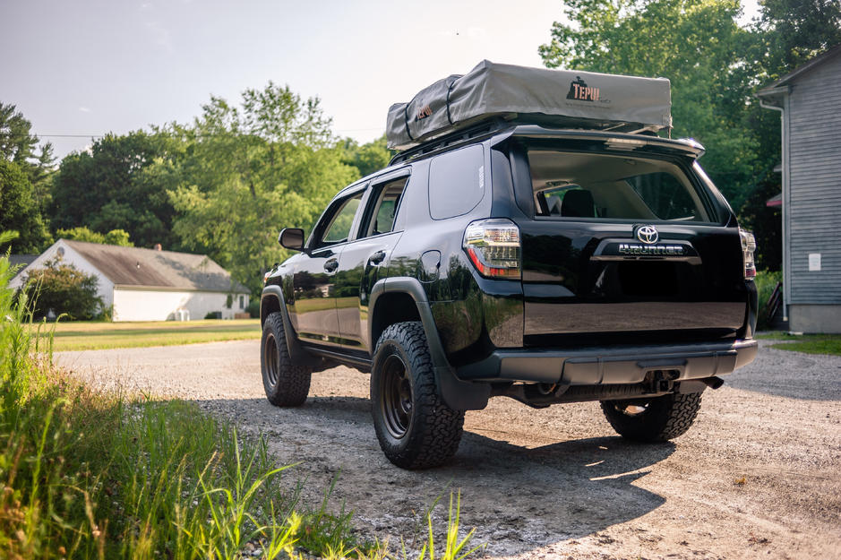

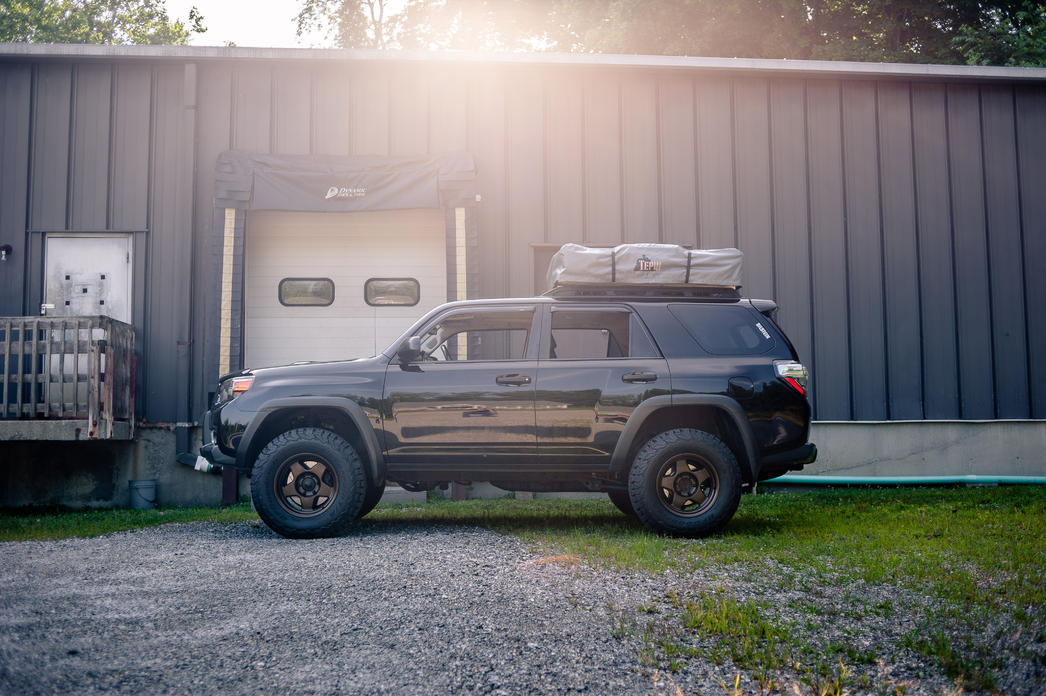

Got back behind the lens to capture these:

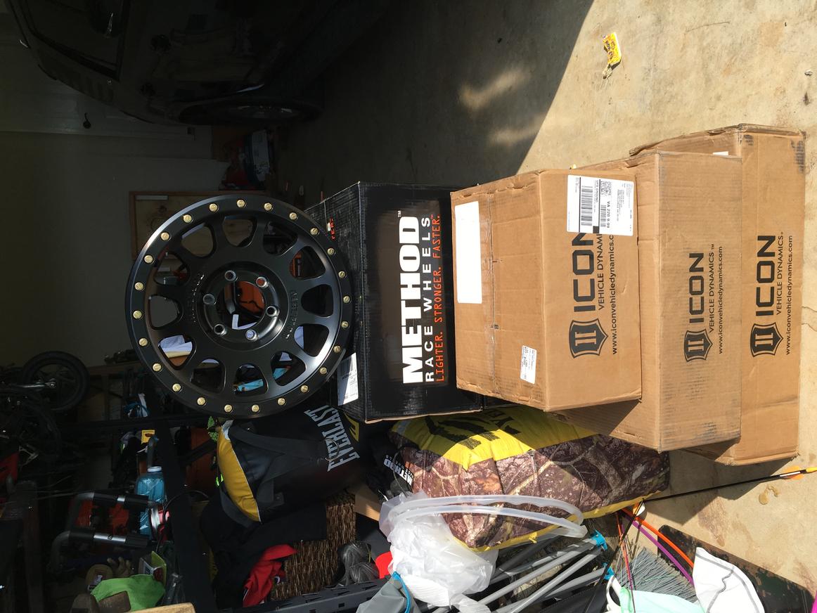

Christmas in July?!?
Wanted to shout out to Richard at total automotive performance for setting me up with my icon stage 2 suspension lift, Christmas is coming early ladies and gents! I’m going on Vacation Tuesday, the crap part is I won’t be able to get it all put on until the 23rd, such a long time to wait

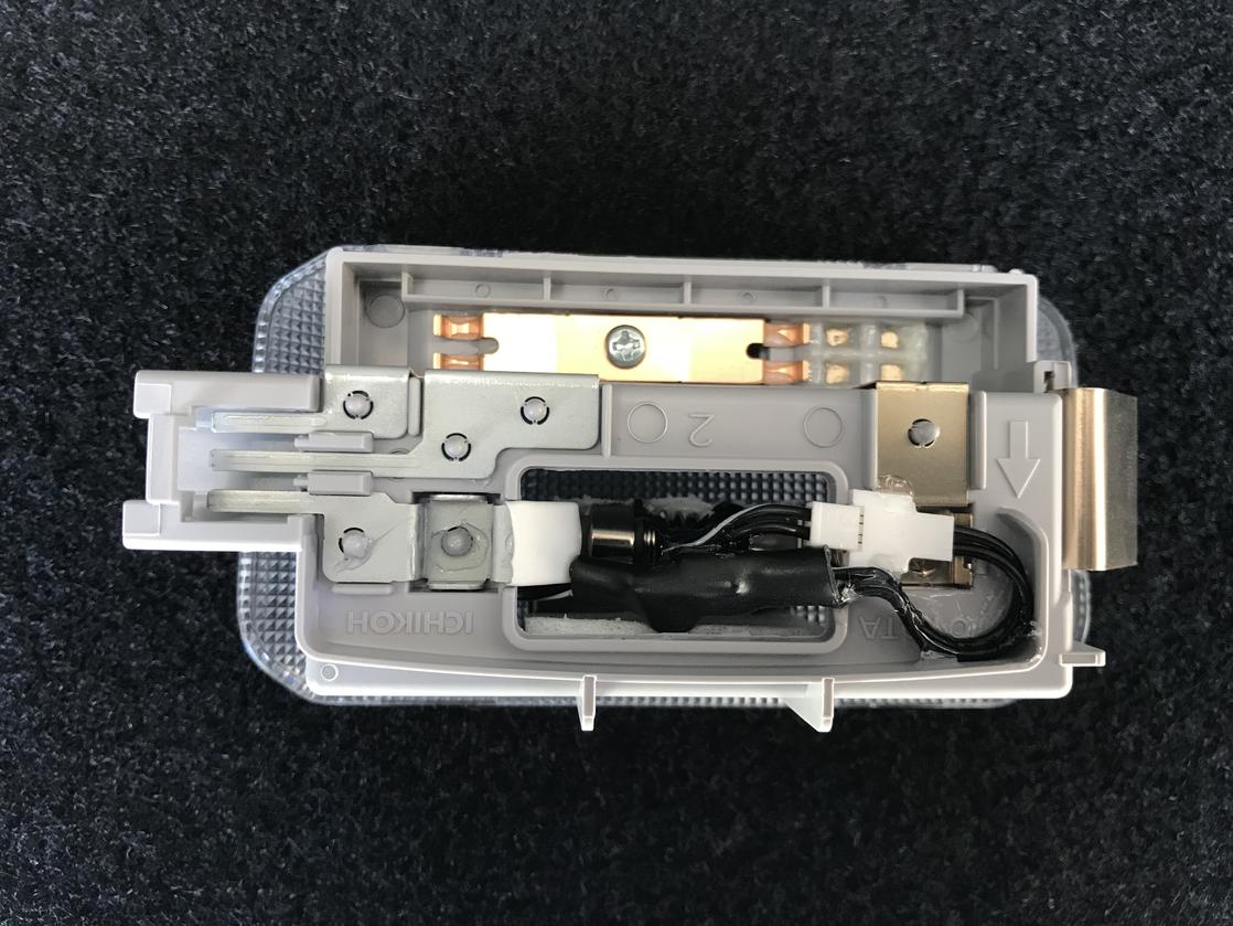

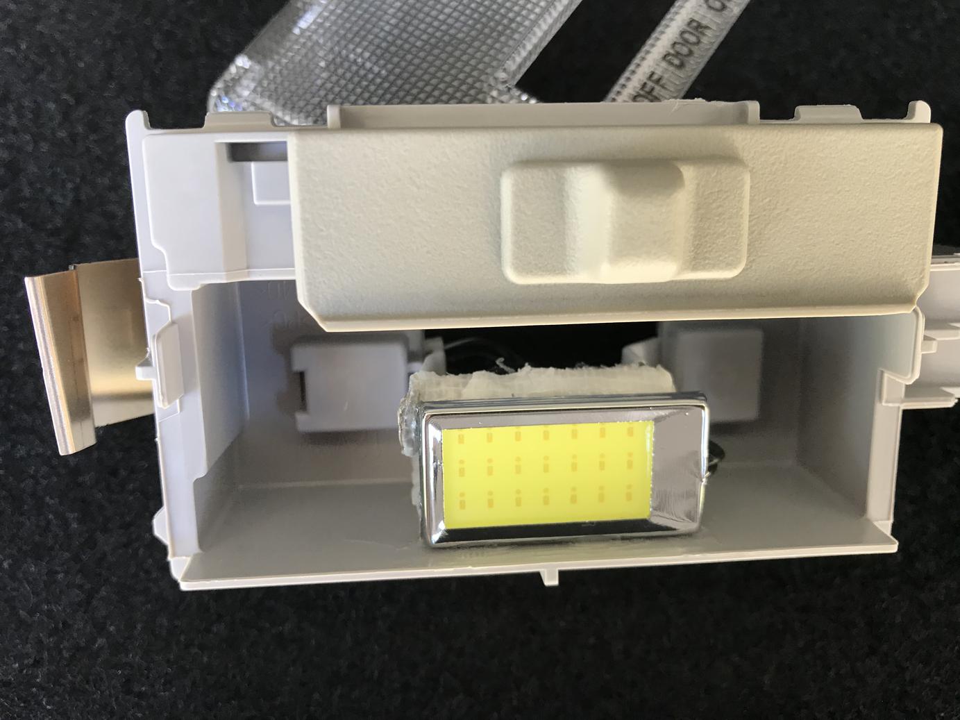

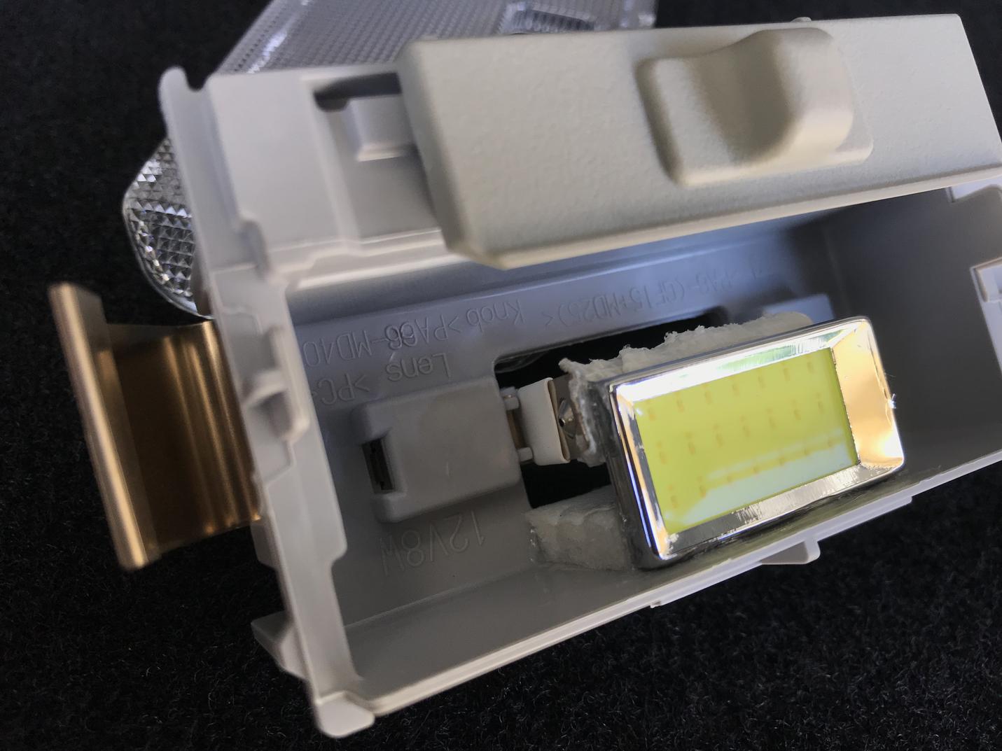

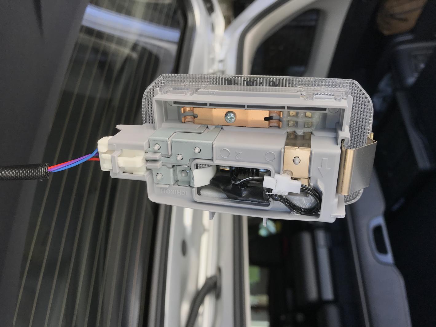

What bulb did you use for the rear hatch? I know Amazon is littered with them but I've had so-so results with random Amazon bulbs.
I'll probably be keeping my interior lights incandescent just because it's easier on the eyes at night but I do like the idea of having more light in the back.
For my rear hatch lights on a 5th gen I got two of these Pilot Plasma LEDs (model CZ-3261W) from my local Pep Boys. The package included a battery and switch so you could test before buying. They are very bright.
They’re also on Amazon:
https://www.amazon.com/Pilot-Automotive-CZ-3161W-Replacement-White/dp/B011CFAMZY
They come with several common adapter connections, I used the festoon to connection into the 4Runner prongs.
Double-backed tape and heat-shrink tubing were used to insulate the light fixture prongs from the back of the metallic LED body. I used plastic spacers and liberal amounts of R6000 adhesive to mount the LED and tack the wires solidly in place.
It works great. Lots of light in the back now.
