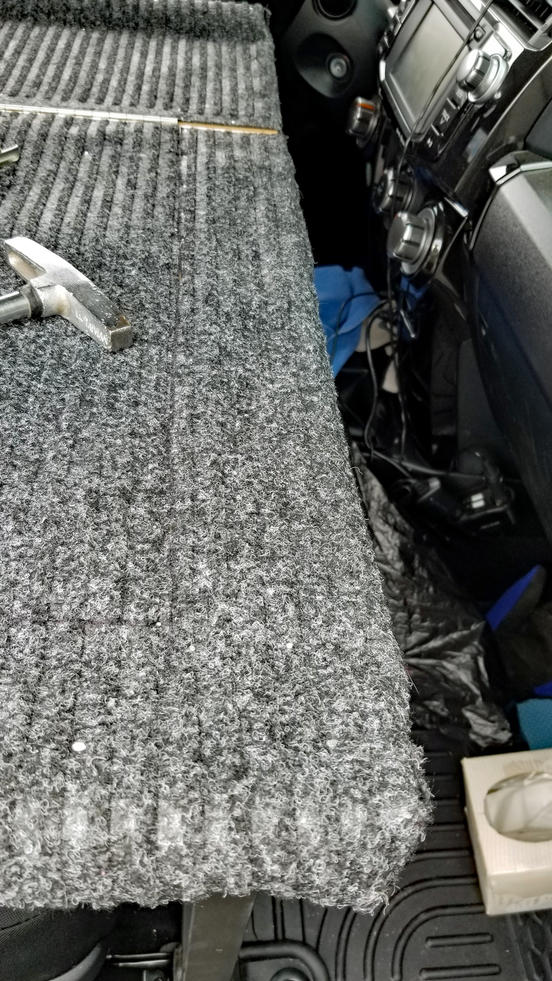

...More Progress On My Sleeping Platform-Part-4...
...Howdy, again!

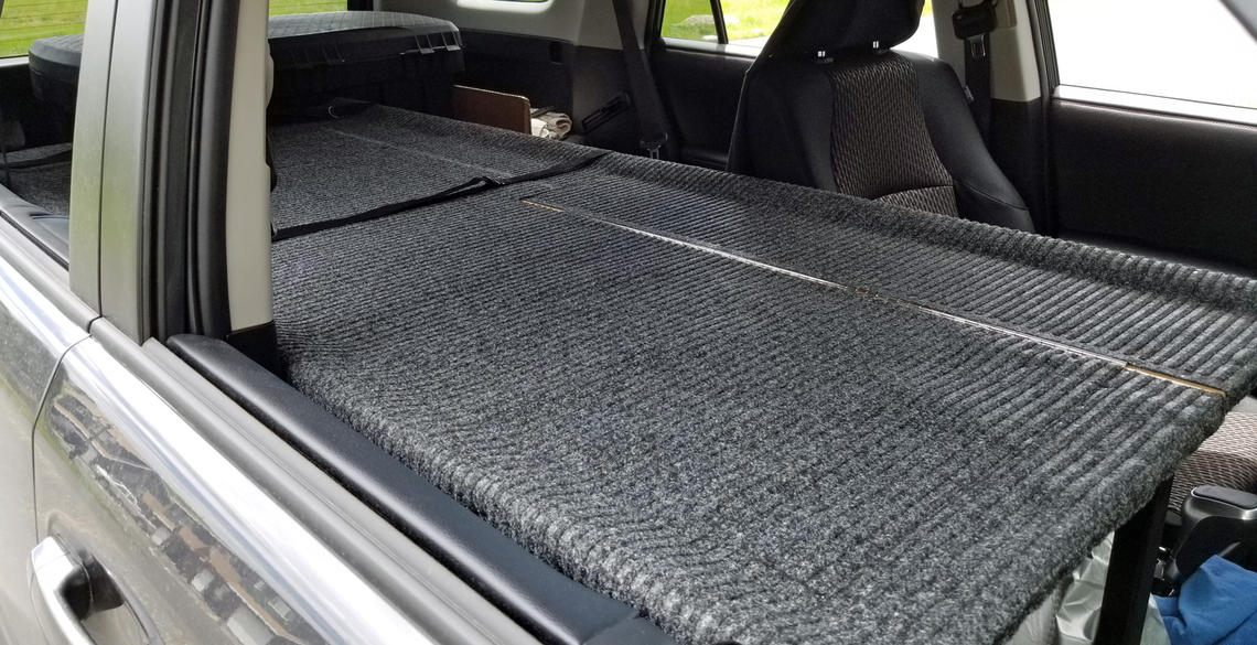

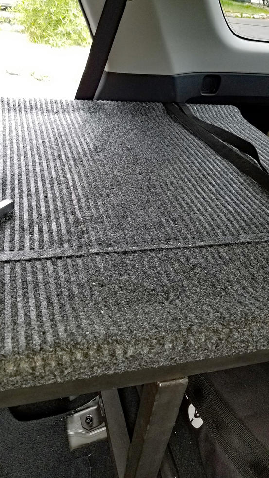

...Once the platform was bolted to the metal-support frames that are attached to the front and 2nd-row seat hard-points with nylon-locking nuts...
...I then finished nailing down the two carpets strips that covered the bolt-heads...

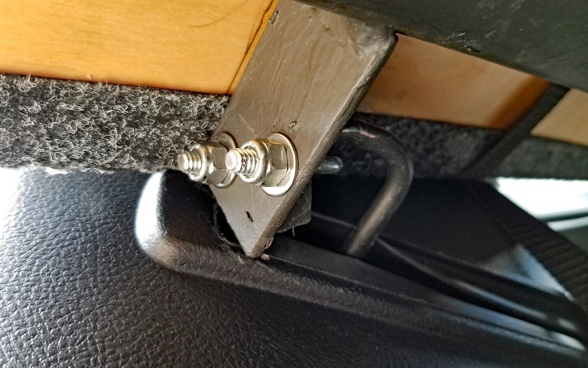

...The toughest connection was the seat-back hard-point for the back of the 2nd-row seat...that U-shaped metal loop that holds the seat-back rigidly in place when upright....I thought this would be an excellent place to also bolt the platform to the side wall....to give it more lateral stability....
...The genius fabricator that did all my work created a spur to capture that loop using a U-bolt...and it was one Helluva tight fit gettin that sucker in there to bolt up!...
...Profuse and highly creative obscenities screamed quite loudly for prolonged periods seemed to aid in it's final placement....

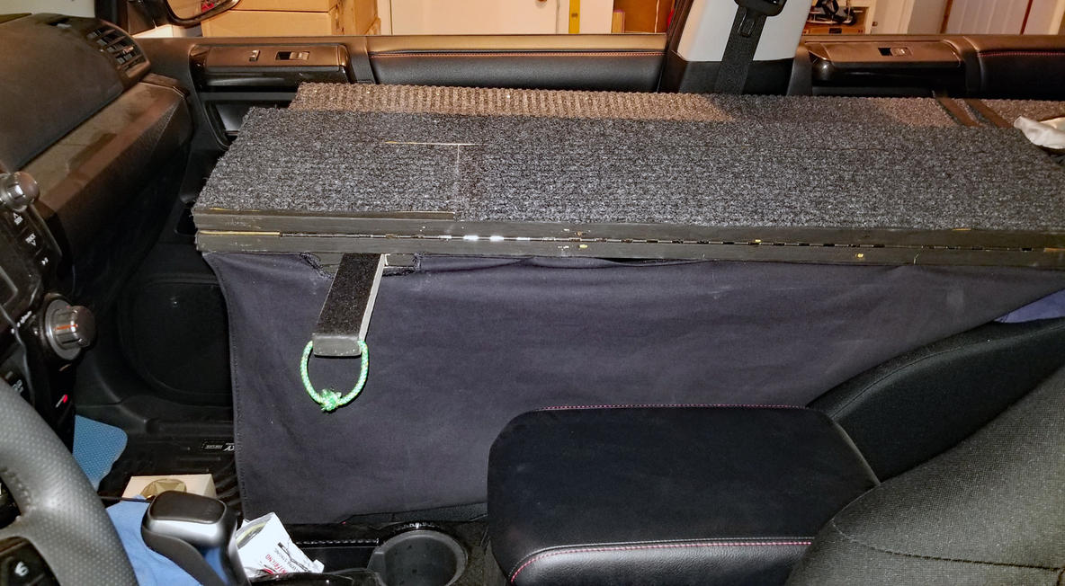

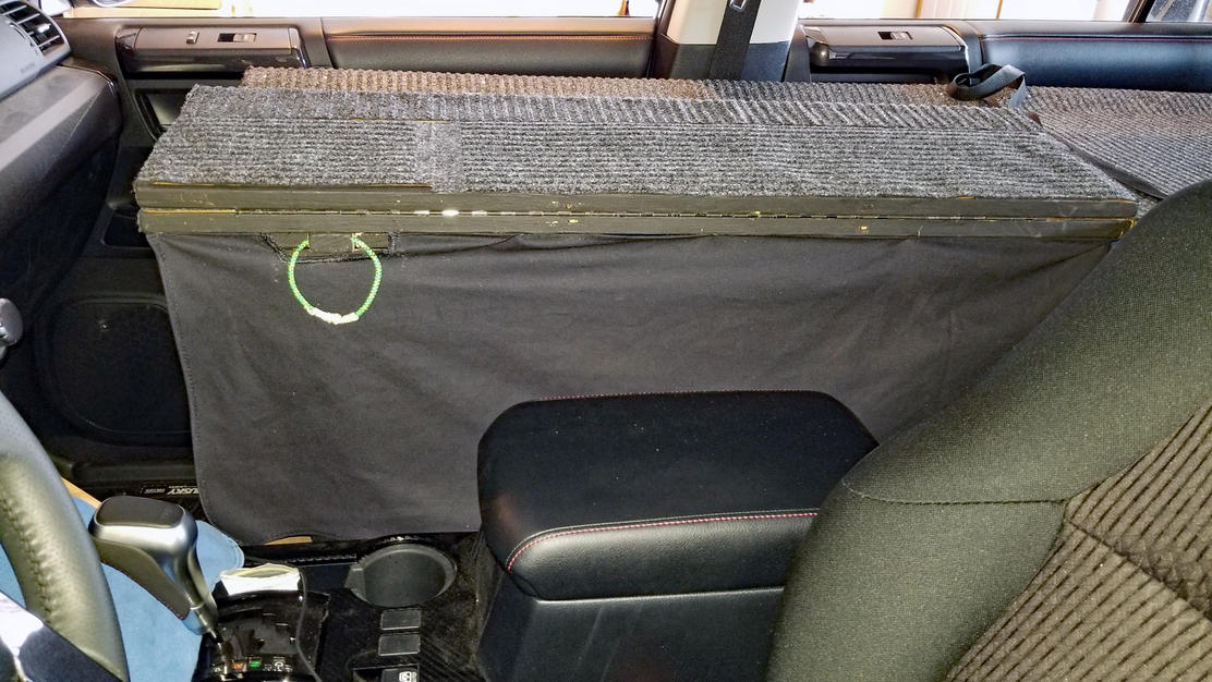

...I then added a black curtain to the underside that folded over...to hide items I might want to store on the front seat while driving...like binoculars or a camera, etc....
...I believe it is best NOT to tempt an honest man, ya see?...

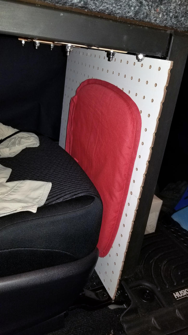

...I also zip-tied a piece of pegboard to the rear of the front platform...and added a cushion to it..in case I had to make an emergency-stop...to prevent the delicate contents of the seat from flying forward onto the floor....
...The final weight came to about 85 pounds....so I took it out on some National-Forest service roads for a shakedown-cruise...and it is incredibly Solid!...
...I am quite pleased with the way it turned out...the fabricator did Amazing work....highly-precise and accurate...and it is great to take an idea from inside your twisted and crowded head and finally see it completed even better than you had envisioned it would be!...
...SOooo...next...onto some blackout curtains for when I have to reluctantly spend nights in organized campgrounds with close neighbors....
...Please see the pics below to make all this a bit more clearerer:

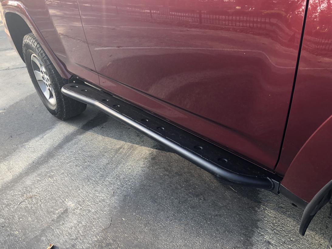

Lift and rock sliders

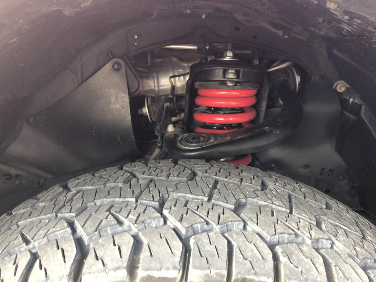

Just got these Perfreybilt Rock sliders that I found on Craigslist paid $180
And also the TRd pro suspension with the dobinsons springs
Let me know what you guys thinks??????

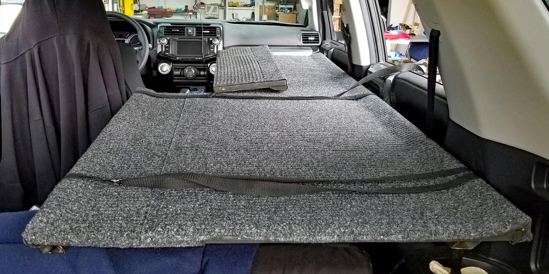

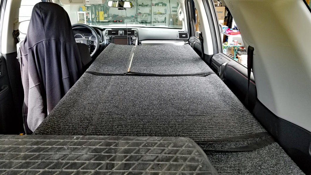

...Final Touches to My Sleeping-Platform
...Howdy, once again!
...OK...so ran out of available spaces for pics in post 33801 above....so here are the last few:

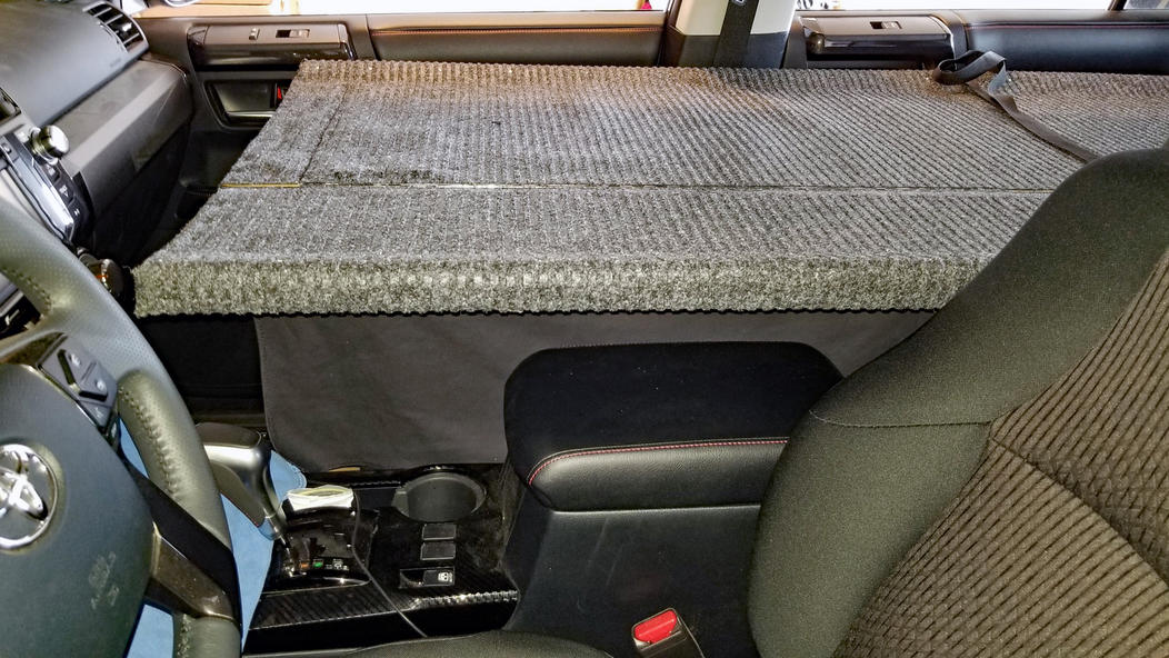

...( I also realized I never showed the final version of the support post for the portion that folds over flat up in front...This is the oak board that slides out to support the frontmost corner of the platform..all surfaces covered in adhesive-backed felt to prevent rattling when driving..)...
...I had the fabricator extend the lower frame 3-inches to provide solid support for the rear portion of the fold-over part as well...

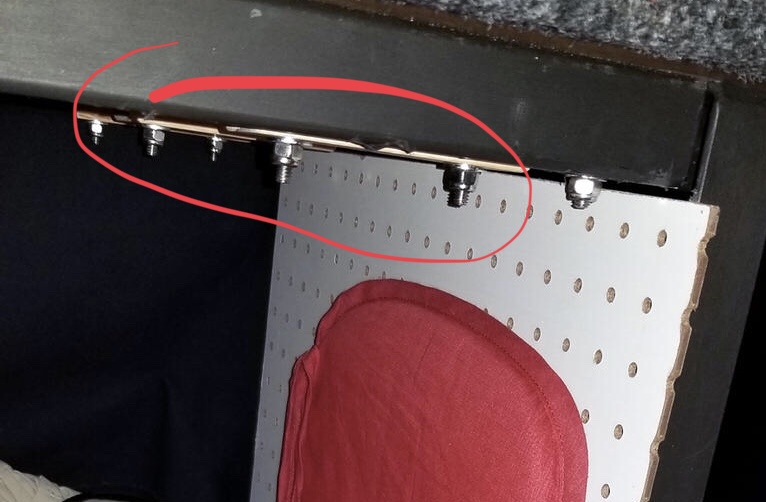

...Included below is a pic of the pegboard and cushion to prevent the seat-contents from shooting onto the front floor in case of an emergency braking situation...
...Once it was All done....took it out for 47 miles of rough NPFS roads to see if anything would rattle or loosen...but the entire thing is incredibly SOLID!...
...and some of the views made my crushed-kidneys worth it!....LOL!...
...Now....onto the curtains in the next installment post!...:thanks:

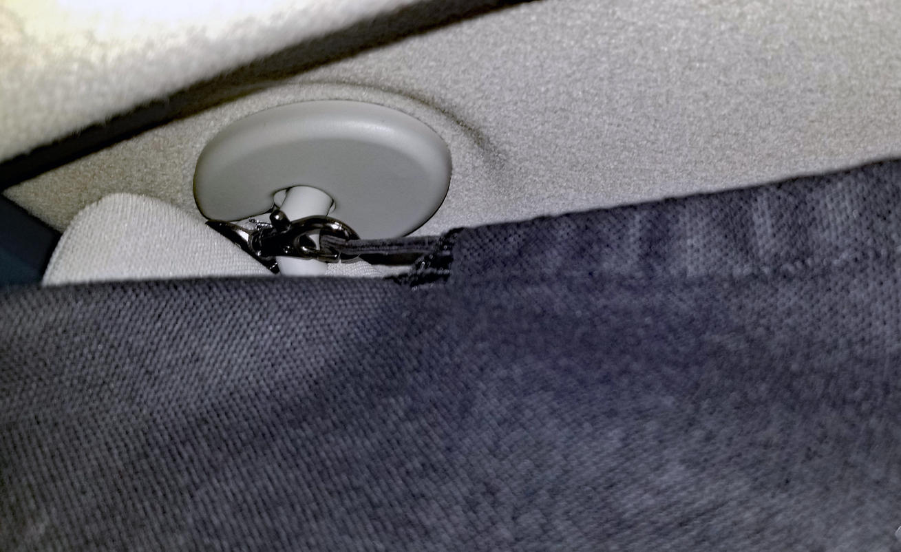

...Blackout Curtains...
...Howdy!
...Sorry!....didn't mean to store it up and then post it all at once...but it just kinda worked out that way......:Cry:

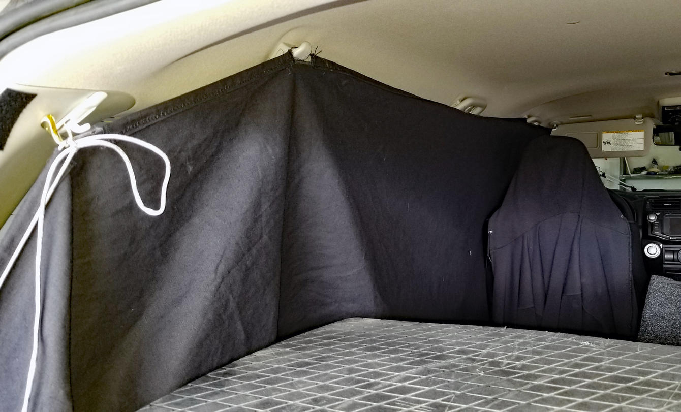

...Since I will be sleeping and working in my 4Runner..there would be times when I would need some privacy from prying-eyes....as in when it would be sadly necessary to spend a night or two in crowded campgrounds...( think National-Parks )...and also to offload images from my memory-cards at the end of a full day of shooting and filming....
...( I do a LOT of time-lapses...and those full RAW images tend to chew-up the empty space in memory-cards way too quickly! )...

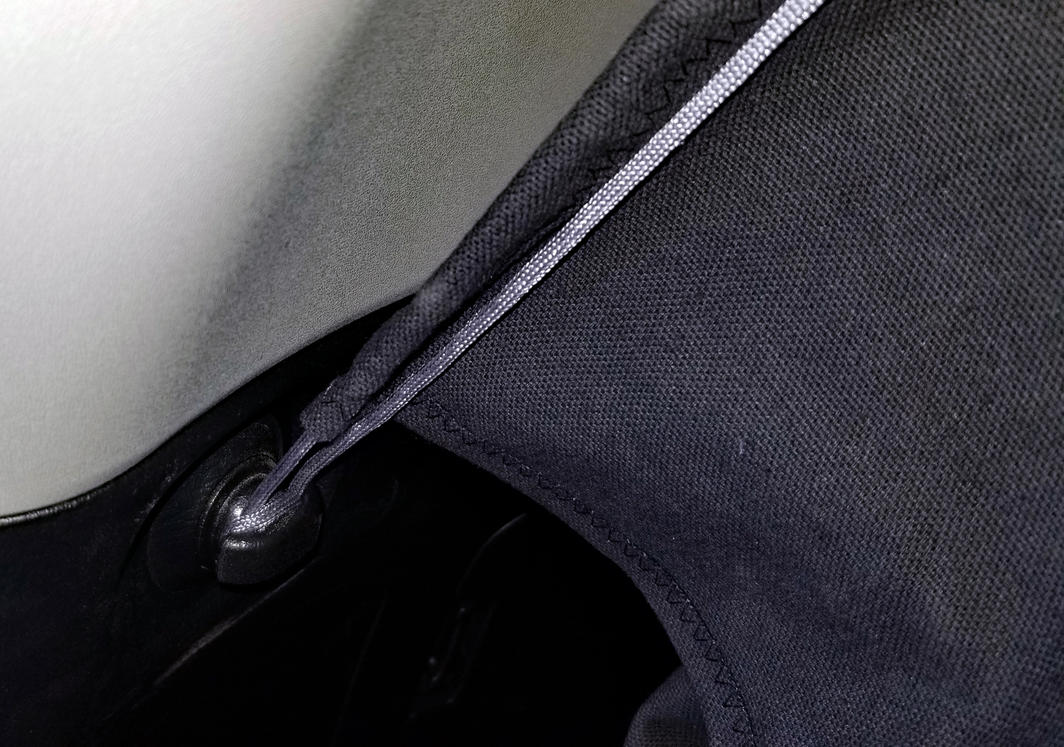

...I saw on this forum that another guy made some simple, yet effective curtains for the sides of his 4Runner....so I modified his idea using much heavier black cotton-duck material and nylon ripcord...
...I attached the cord to the post on the front visors using a simple small clip...then stretched the cord tight and added a hook to the rear panel...
...I sewed the material over the cord...with cutouts for the over-door handles..and hangar in the back...drawing the cord down to the double-hook on the lower back-panel...then brought the cord back up and tied it off on the additional hook I added up top...
...I added velcro up front on the forward posts...and just left the extra material in back in case I need to pull-out my camera-gear box while the curtains are still in place...
...The rear curtain is small..so didn't need any cord...so I just used velcro to hold it up in place....( there is a center plastic-cap covering one of the screws holding the headliner panel in place...which made a strong and convenient spot for a chunk of industrial-strength velcro )...
...It's pretty cotton-pickin dark inside...which was the planned results from the start....Not too expensive, effective...and washable.....( ain't too pretty...but I was going for substance over style here...)...:thumb3:
...Hopefully...the pics below will make all of this easier to comprehend?...:shrug:

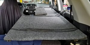

The platform design looks good!
I guess you’ll never have passengers again!
Looking at the underside, you might want to put some plastic caps on the exposed bolt threads so you don’t tear up hands or gear.
Have you slept in it yet?

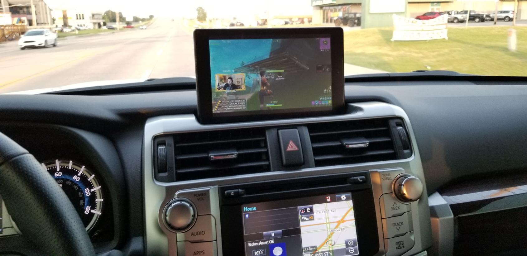

Got my tablet mounted, it fits there perfectly and almost looks factory, have it bluetoothed.
Tablet mount
Looks great! I'm fine tuning my setup (magnets and a tablet stand) to do the same thing. I just ran into a snag, when I wear my polarized sunglasses, the tablet screen is all black.
What hardware are you using to hold up your tablet?
...NO passengers unless they want to lay prone on the platform?....LOL!....
...I agree with you and do plan to put caps on the threads....but Muchos Thanks for the great suggestion!...:bravo:
...I have not slept in it yet...now sewing up a removable liner for my sleeping-bag...so it can be removed and washed after trips....:emptybath:
...Gettin there...one small....slooow step at a time!...:snacker:
