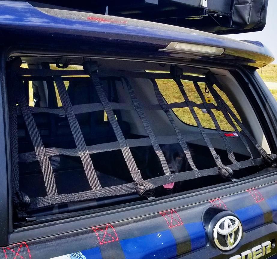

Back window net.

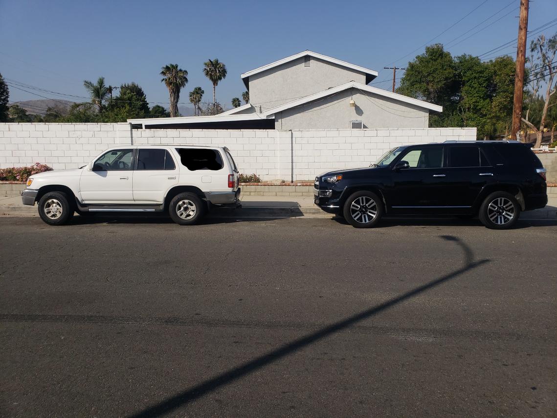

I parked My 5th gen next my 3rd gen So I could take a pic. of the 2 of them together. Before the 3rd gen goes Bye-Bye.

I had seen those on one of your last posts and wondered when you changed wheels, they look really good!
Hey Morgan, yeah, last week we installed 4 of 5 and finished up yesterday with the install and painting the center caps black. Thanks buddy, I'll catch up with you soon...

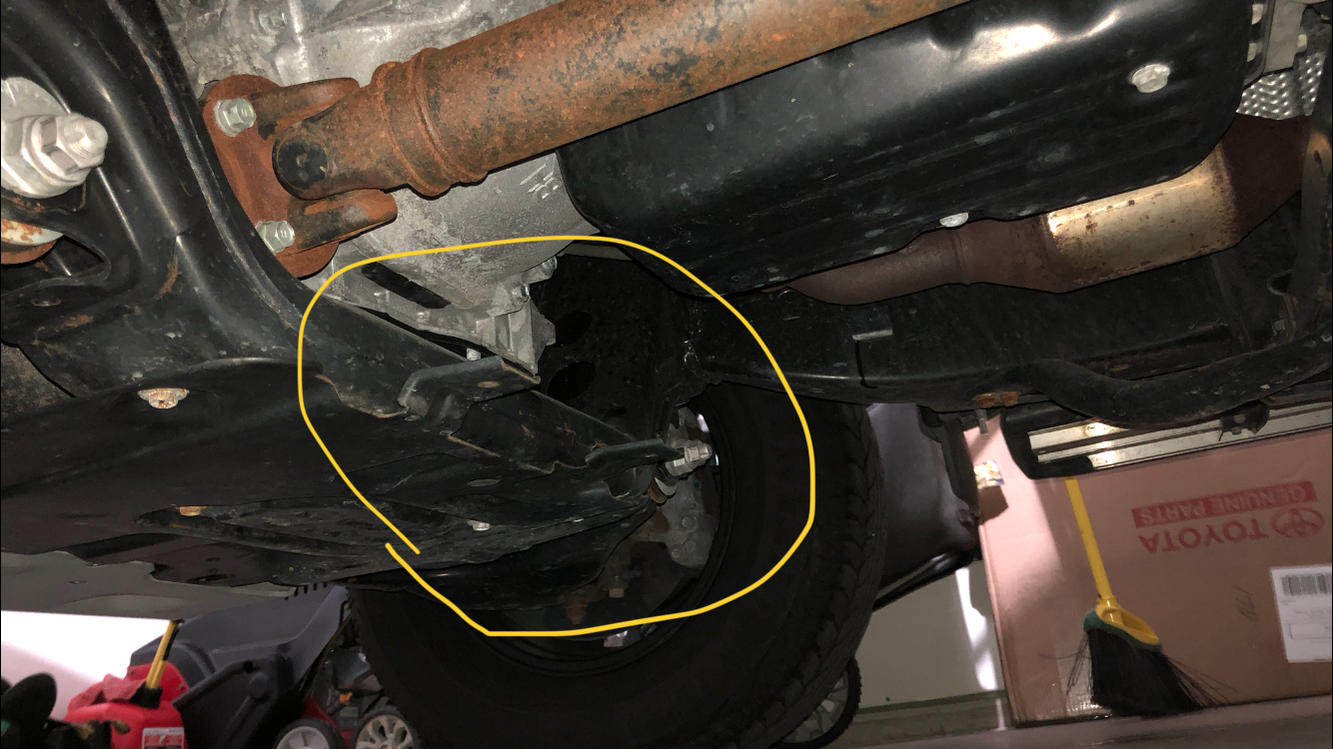

I saw this today. Should something be connected to it?
Any idea what connects the this? Should I be worried?
Some models have factory transmission skid attached to. Part of some package. You don't miss much as that skid is more cosmetic than the real deal. I have removed mine and put my own steel plate skid plate. Not for off roading but to protect cat converters from being stolen.
