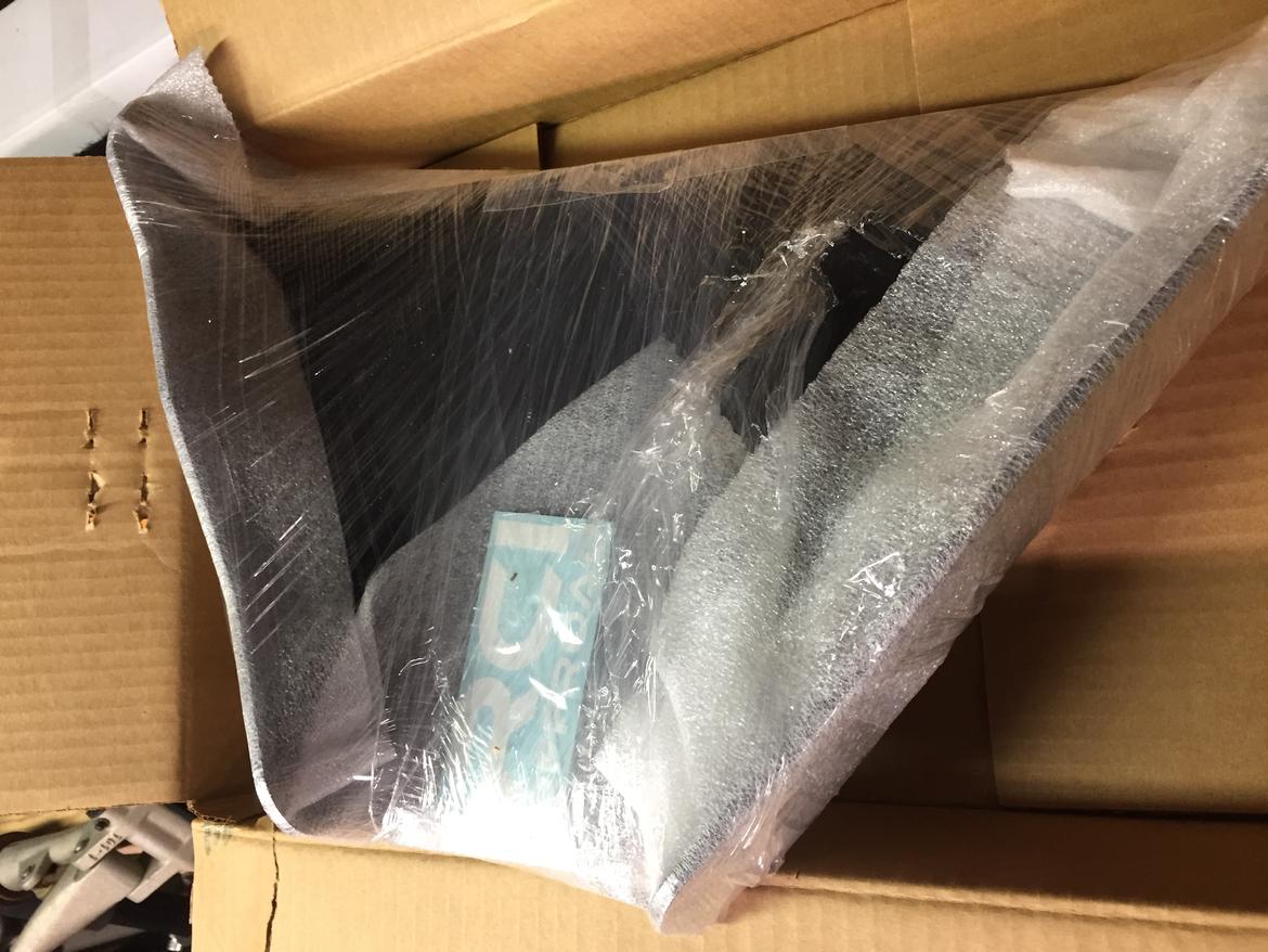

A little bit of trouble but managed to get the leveling kit installed, instructions sucked, not as simple as the videos made it look but very pleased with the results. Oh, and got new shoes.

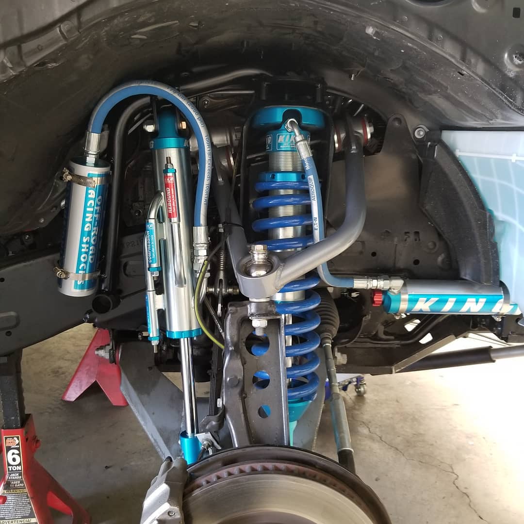

This seems excessive... whats the advantage and application for these?
It gives you the ultimate control over compression and rebound with a position sensitive shock (the exterior bypass tubes). The application is for beating the crap out of it in the desert driving fast(I also run bypasses in the rear). I log a ton of miles in the dirt during desert season so its not excessive to me but it would be to 99.9% of 4runner owners with a lift.

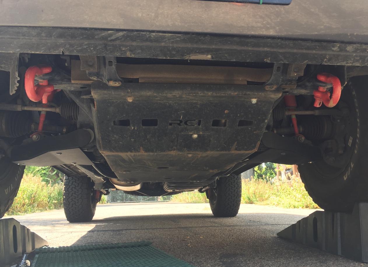

RCI Rear Differential Skid install
PITA :mad2:
Super tough to get to several of the bolts...but done. You only want to do this once :violin:
Tight like a tiger:dammit:
