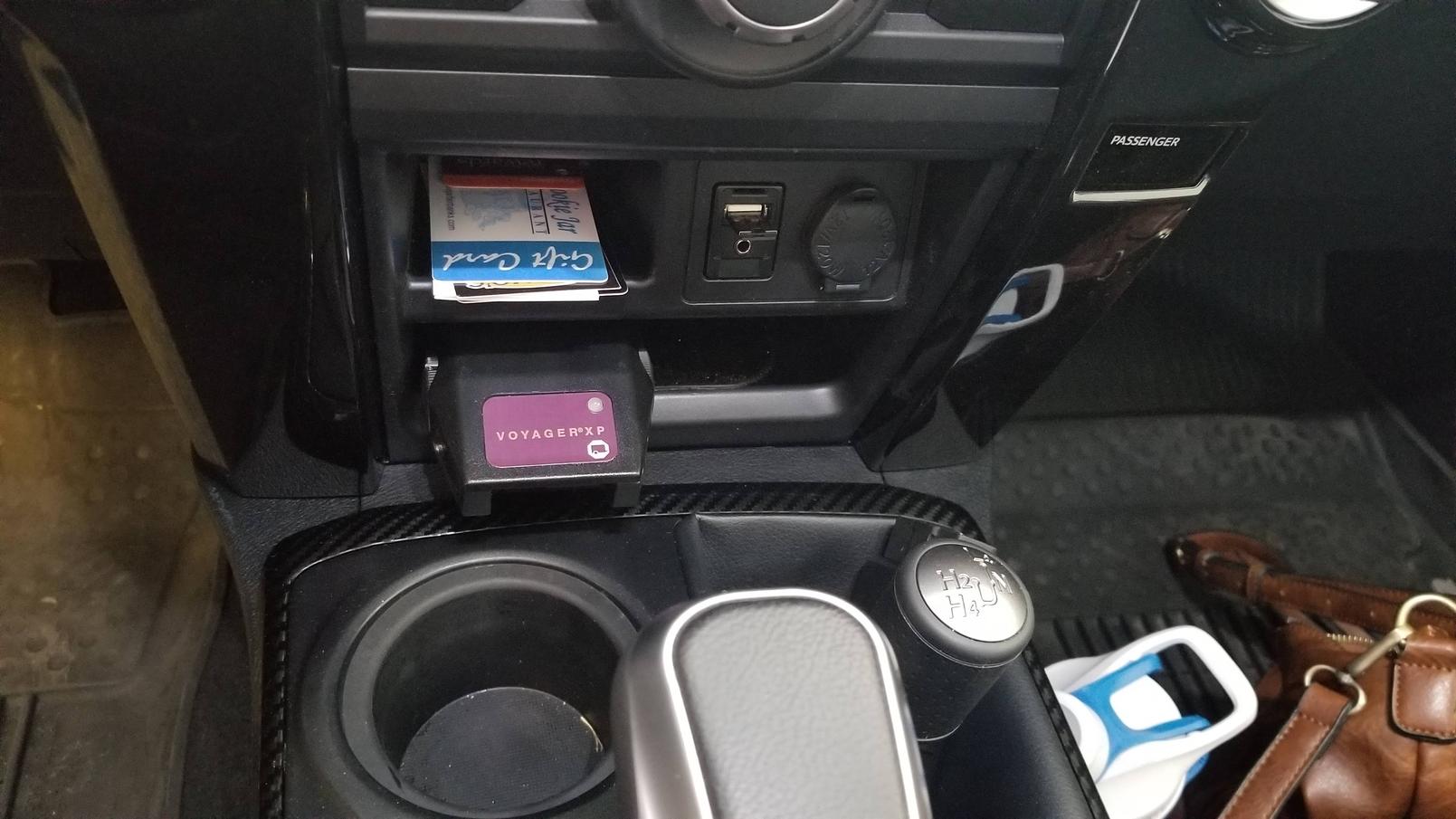

Picked up the camper trailer, installed a brake controller and ordered a Toytec leveling kit
Cleaned up my wiring and switch pros controller mounting it in a plastic housing, sealed with wire glands.
Mine went in the same spot! It was just meant to be :biggrin1:
Nice looking rig, BTW.
Thanks! I was waffling on were to put it. I felt the knee board was a bad place with the airbag so close. Fits nicely and out of the way.

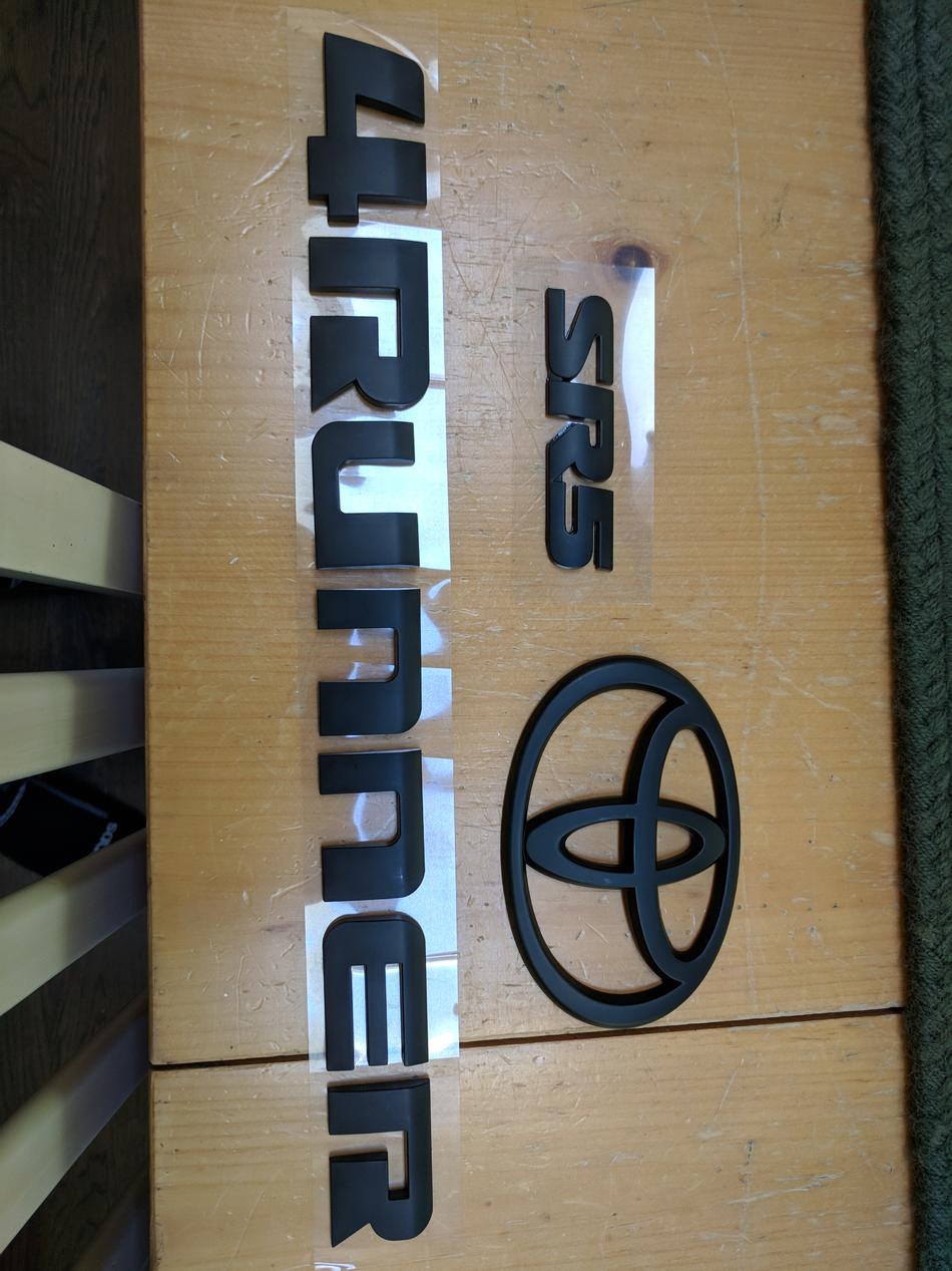

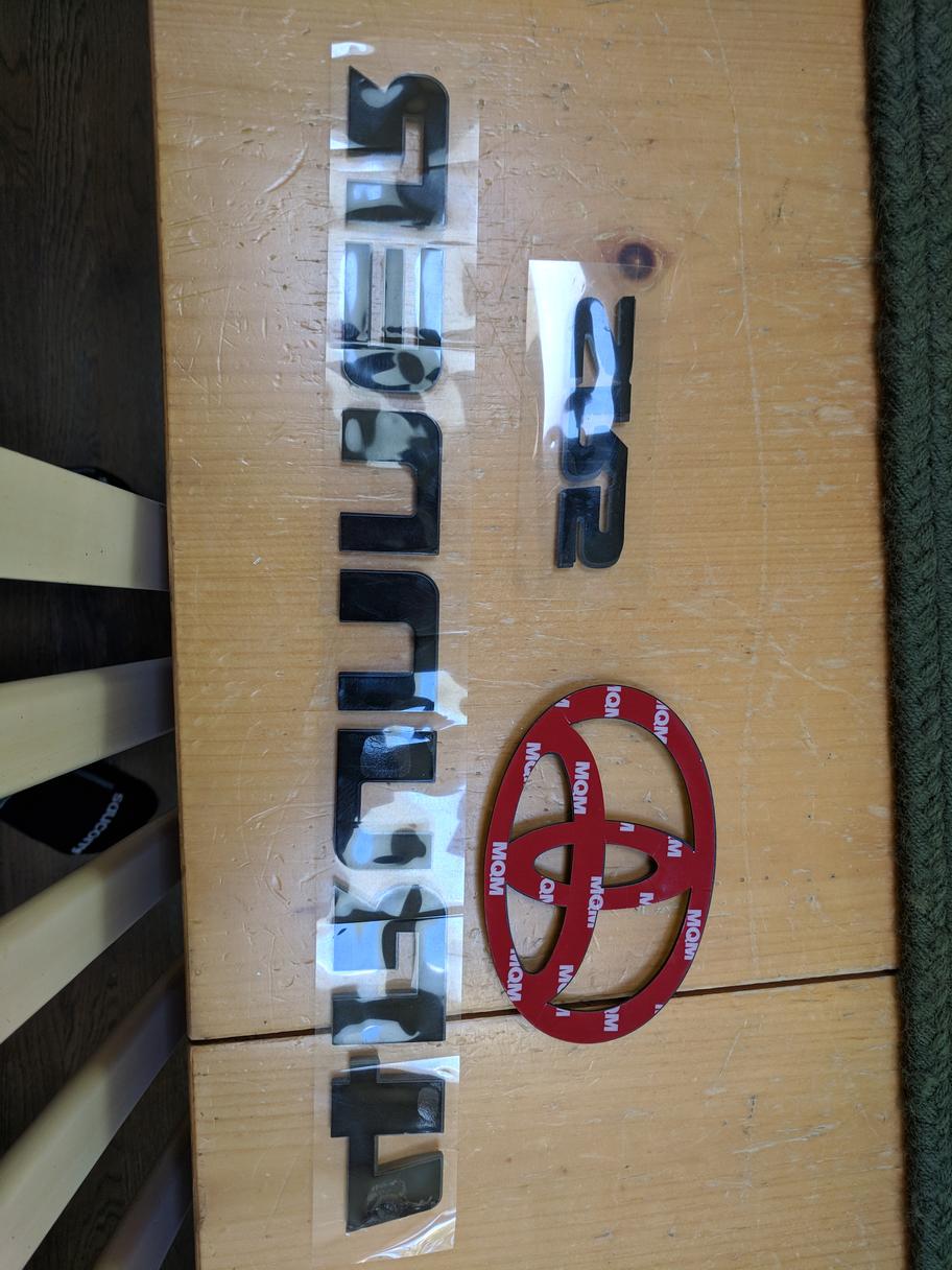

Post pictures of what they sent you. Something doesn't add up here.
Letters and emblems are solid--or mostly solid. They don't fit over the emblem they are a direct replacement. Most SR5 emblem overlays are kind of stuck together and have plastic between the letters--these are the exact same size as the chrome lettering and are "solid". The Toyota emblems have cross-bars across some of the emblem on the back--not hollow to fit over anything.
I think they just sent me the actual emblems instead of the overlays--ebay buyers( and there were a few) said how easy they were to stick on--nope.
OK so post a link to the auction. The ones I got were OEM Toyota and were installed in 5 minutes. They were super thin and hollow, fit right over the chrome and held in place with double sided tape. Sounds like maybe yours aren't OEM Toyota?
Nice set up! Curious, what is the Dry weight on your camper? I recently got a WolfPup 16BHS, dry weight 3000 w.out the rack on the back. I also got a weight distribution sway hitch.
What are your thoughts so far on towing that with your 4Runner? Lastly, how did you get the brake controller installed there? The dealer installed mine down by my right shin, I keep hitting it with my leg. Annoying.

Here is the link--the price has changed to $267!!! I'm not an idiot and didn't pay that...I paid 67 with free shipping--good reviews from the buyers. I haven't been contacted by the seller. The pic shows how the SR5 isn't perfectly cut out, but mine is.
https://www.ebay.com/itm/2014-2019-TOYOTA-4RUNNER-SR5-MATTE-BLACK-OUT-OVERLAY-EMBLEM-KIT/113236956793?hash=item1a5d72d679:g:Fs0AAOSw~FlbkTvz
Post up a picture of exactly what they sent you, front side and back side.
Thank you! I read great things about the Wolfpup. The local dealer sold KZ trailers so we purchased the E191BH Escape(also got good reviews). It’s dry weight is 3200 lbs I believe. We got the load leveling and a back up camera as well. I just got it so not much pulling yet. I’ve done a fair amount of towing and it feels just fine so far. My only complaint is lack of visibility but I have not mounted tow mirrors yet.
I did a little write up in the tech section I may redo it to make it easier to understand. I have concerns about mounting it at the knee board. First there is an air bag in the knee board so mounting anything there seems like a bad idea. Second there is not a ton of room down there so your legs are bound to hit it. Installing there was pretty simple. I removed the trim piece and cut a whole in the back of it. Then ran the wire to the whole and mounted the controller with Velcro. I’m happy with how it turned out. If I did it over I might put it in the empty spot above.
I only took pics of one emblem(rear) and one SR5--They are not overlays-they are the exact size.

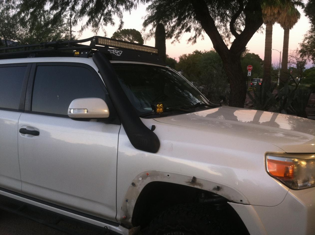

Drilled a huge hole in the fender. Hood opens full swing with sdhq brackets and BD squadrons. I cut the antenna but not sure how [MENTION=68685]Ducmonsta[/MENTION] got that to stay inplace back in the fender hole/grommet.

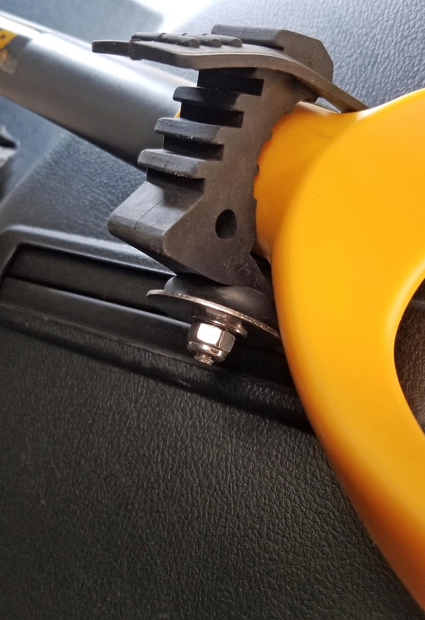

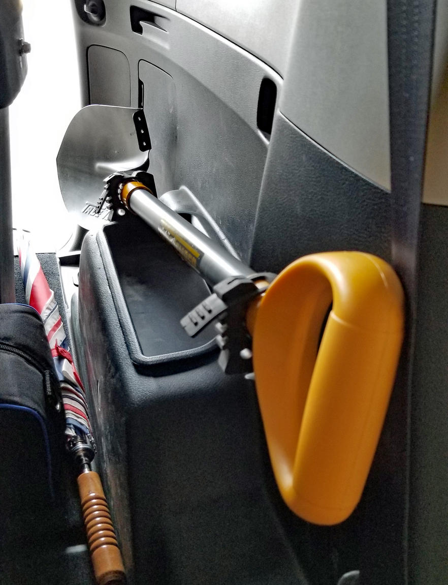

...Finally figured out where to put my shovel and axe inside, as there are limited options with all the other stuff already in there....
...Using quick-fists, I mounted the shovel to the side wall...since I already removed the back seats...The metal clamp that held up the rear seat-back was a handy and secure place for a mount....( see pics below )...

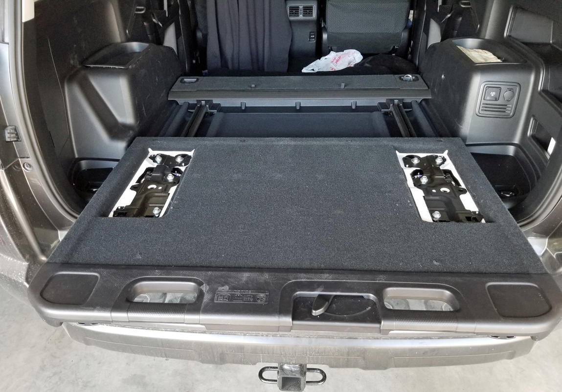

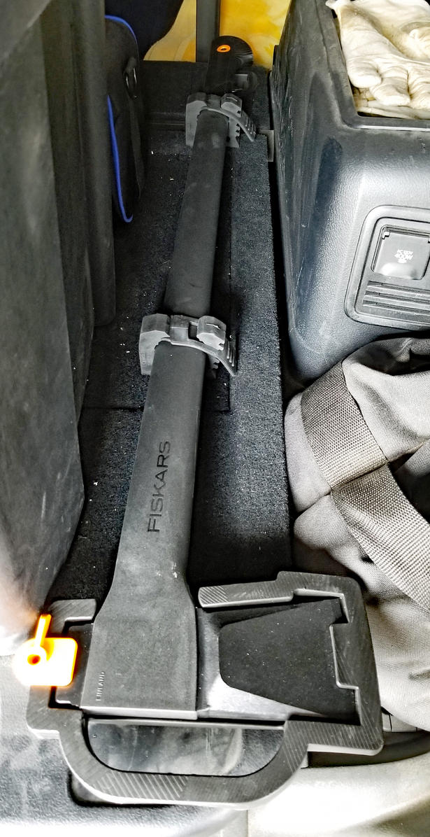

...Not too sure how many of you will be able to use this next idea, but I have the sliding rear cargo-deck, so the axe found a new home on the deck itself next to my big gear-box....also mounted with quick-fists....
...( if ya try this, be careful NOT to drill thru the lock/release cables hidden in the deck....make small diameter exploratory drills first....or remove the two access-panels to see where the cables route thru...)....

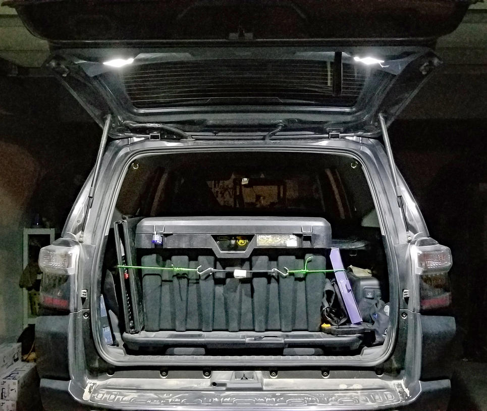

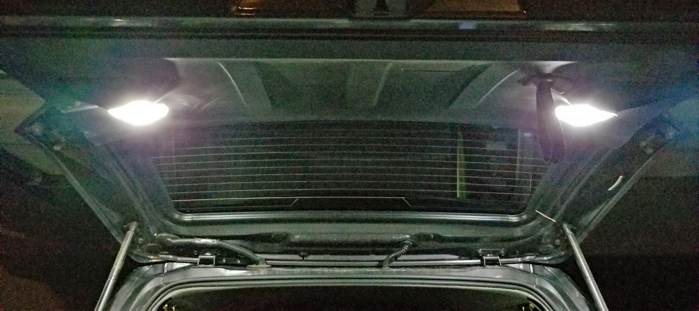

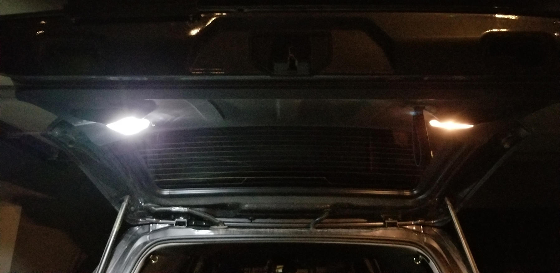

...Finally, and by far the cheapest mod, was to replace the rear-hatch lights with much stronger-brighter ones!....link below:
https://www.amazon.com/gp/product/B01EJNMR40/ref=od_aui_detailpages00?ie=UTF8&psc=1
...the link 'claims' this does Not fit a 2018...but it sure does!...( fake news? )...
...They are easy to replace....there are even vids online on how to do it!
