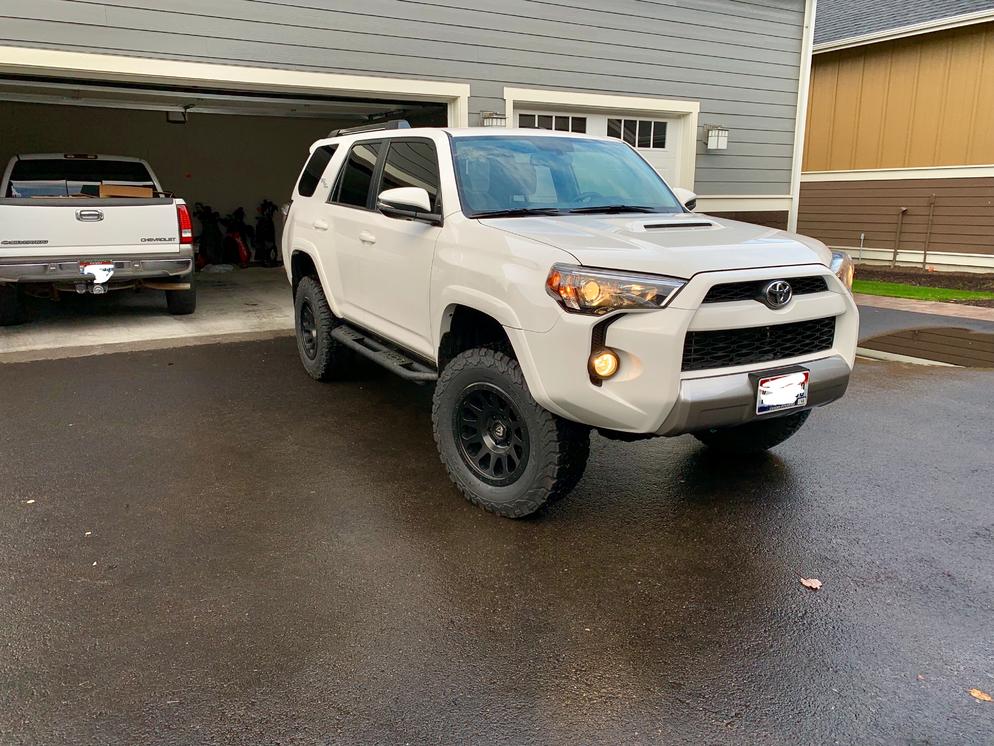

Added some steps today. Fitment is good, super easy to install. Not the fanciest but I like the quality. Each side is about 40lbs, powder coated and feel very sturdy.

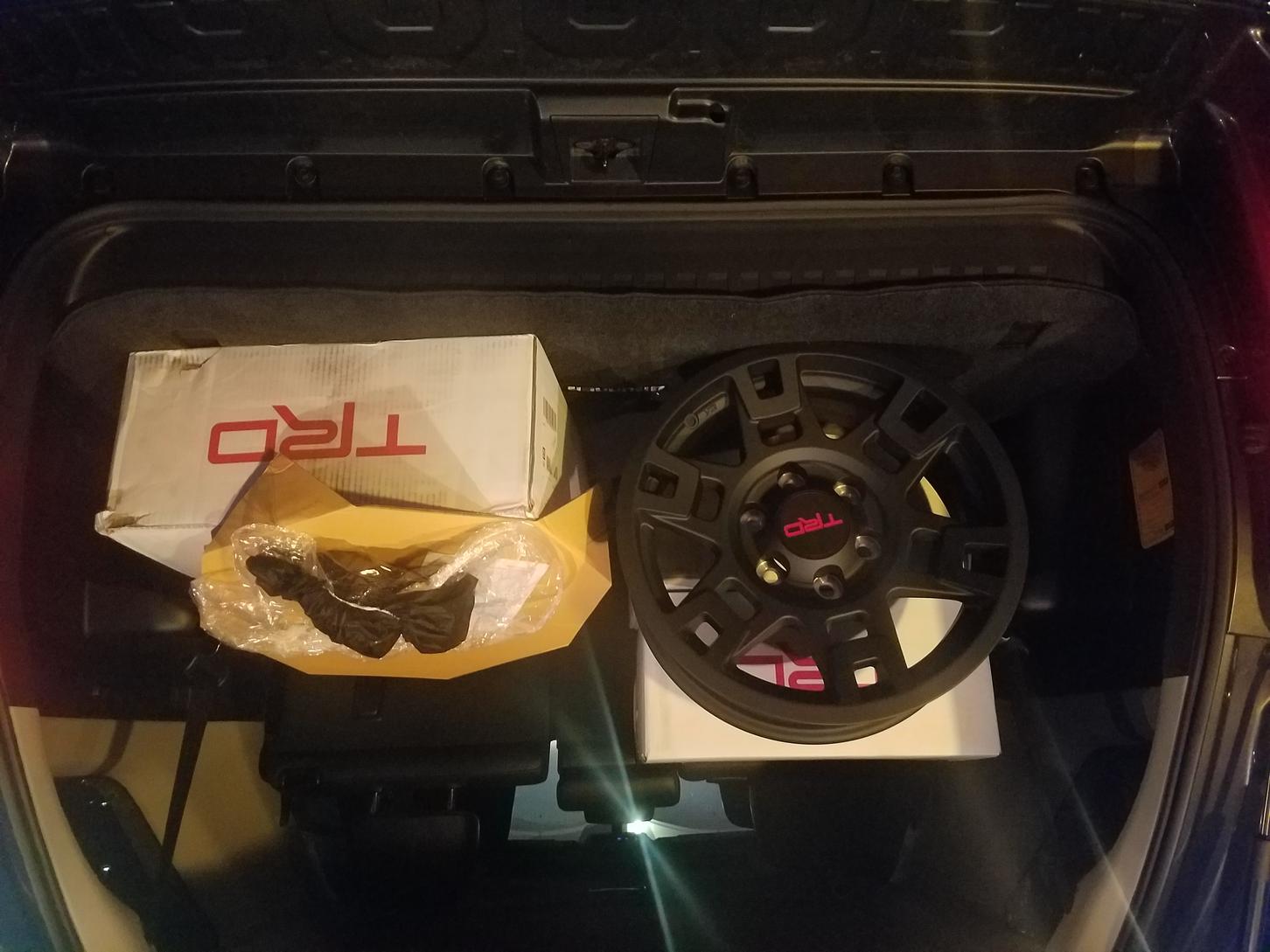

These came in today. Getting installed in the morning. TRD Pro wheels and K02's on a non pro? I know... nevabendunbefo.:lmao: It is almost impossible to find good looking wheels that don't have ugly fake beadlocks. Might switch to RPT1's later.
