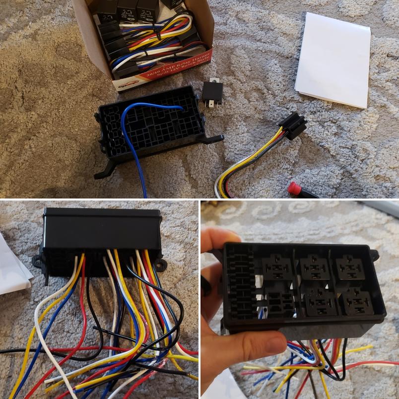

Made a start on wiring up a new relay box for some current and additional electrical needs.

What panel did you use? I assume you bought pre terminated relay plugs and just used those wires to pin out the new block?
[MENTION=153213]2016 4Runner SR5[/MENTION]
That is correct. I just slid the wires out of the harnesses that came with the relays and slipped them into the new box.
The relays have a tab on them for hard mounting, I just broke it off. When I have all of the pigtails wired up to the fuses and such, I am going to fill in the bottom with silicone to insure a good waterproof box. I am also going th o-ring the top and bottom of the box. This will require me making a 1.5mm grove all the way around it for the o-ring to sit in. It is a pita, but for less than $30 all said and done, you really can't beat it. Honestly, that may be a bit overboard, but I just like my electronics to stay nice and dry. I'll make a jig with 2x4 pieces of wood and sandwich the box inside of it. Then with the dremel fixed on a mount I will set it and slid the box through making a perfect grove all the way around.

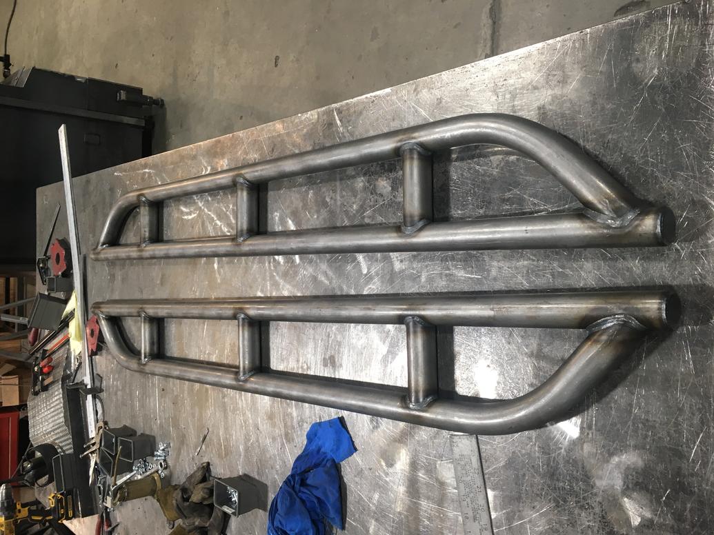

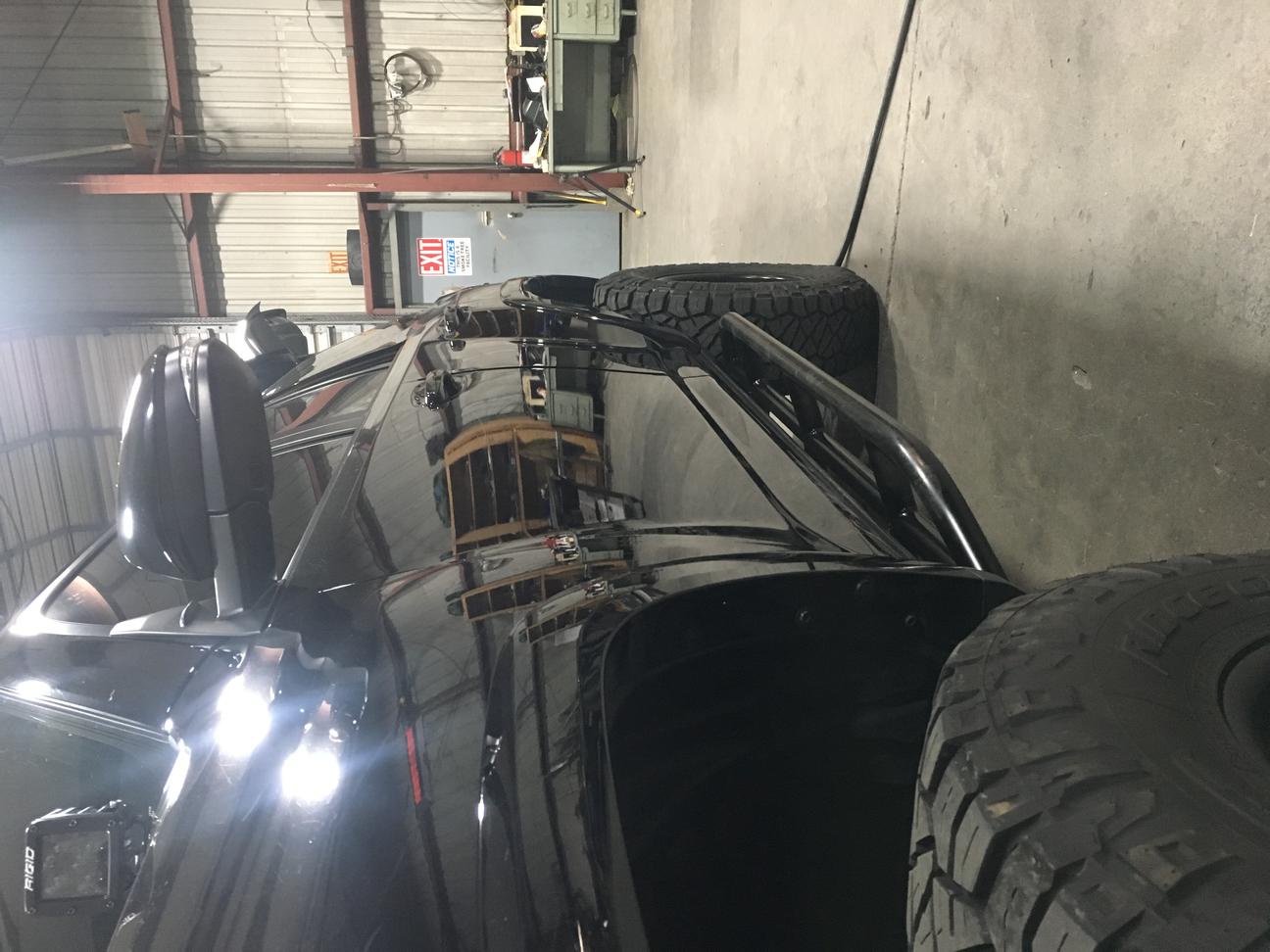

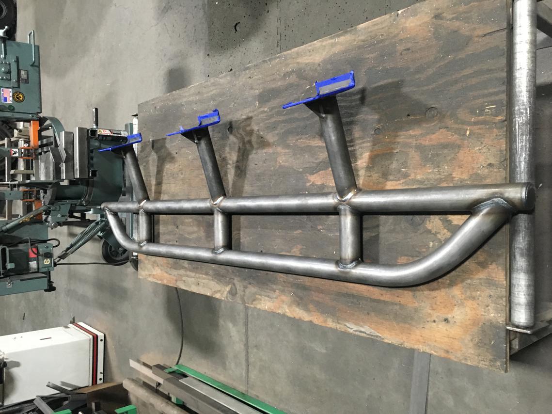

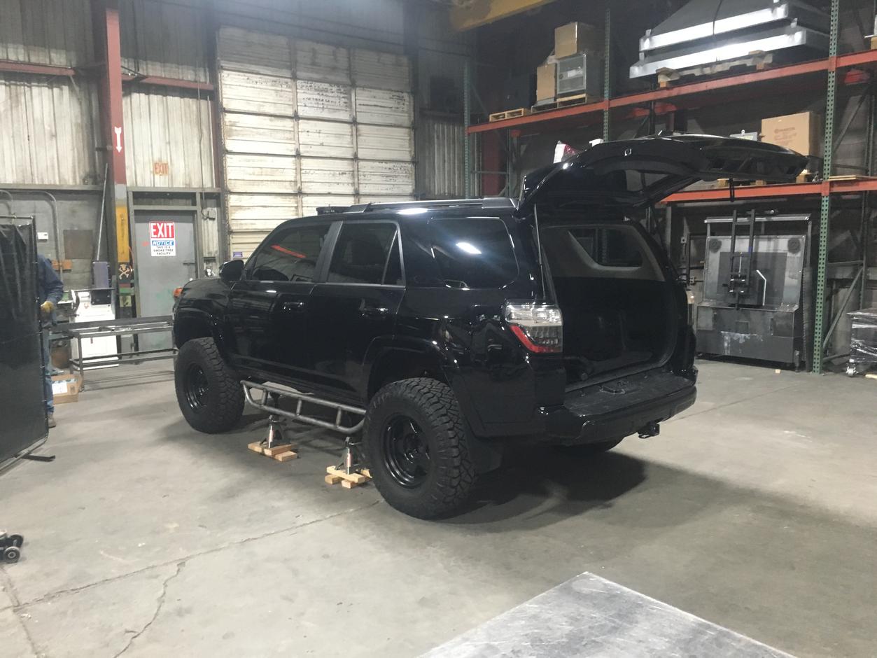

Finally got rid of my N-fab nerf bars and fabbed up and installed some real sliders. I'm happy with the way they came out. The wife though, not so happy with how big a step it is to get in the rig now. Oh well.
