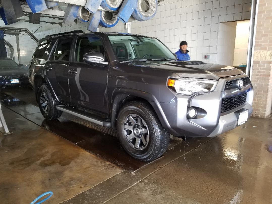

Here is a before and after Pic.

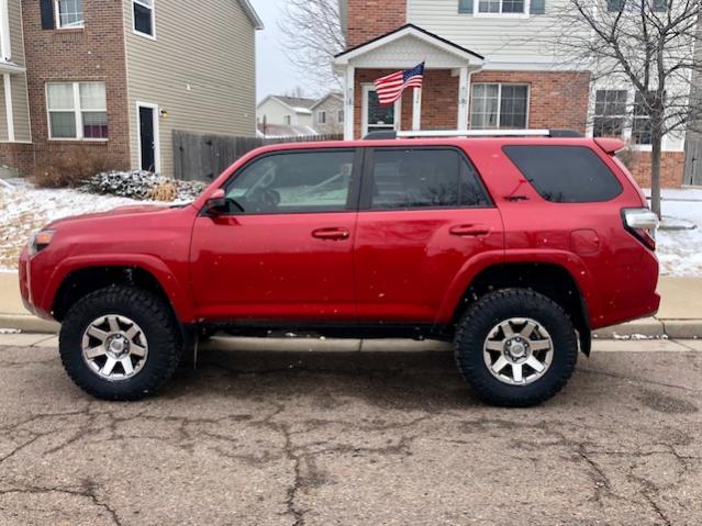

It's all about your wheel choice and intended use. This is my 2016 SR5 with a 1.5" lift front and rear. Wheels are 17x8 with 4.5" backspacing and 0 offset. Tires are 295/70/17 Nitto Ridge Grapplers. All I did is the fender liner mod. No body mount chop needed, no rubbing at all on the street. If I was to take it off road and flex it, I have no doubt I would have rubbing. For a street driven rig, you're all good to go.

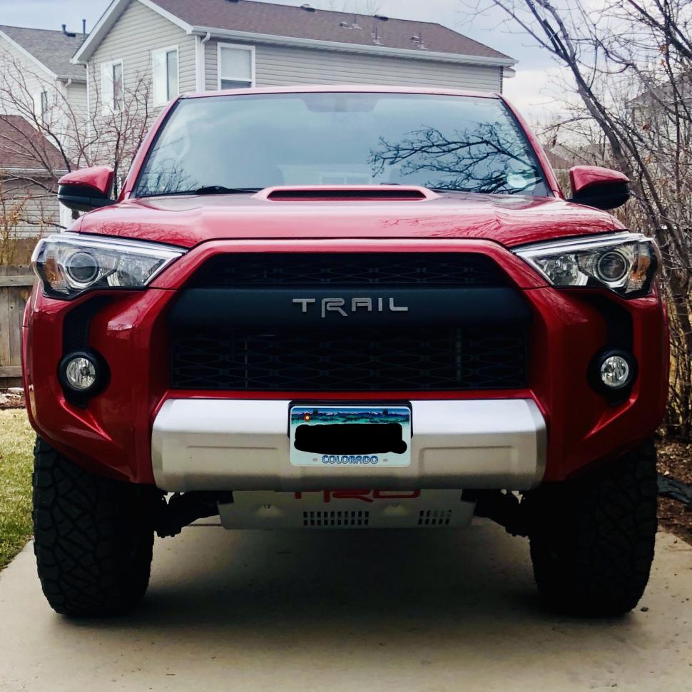

I’ve been on the forum since 2015 when I bought my 15 Trail with KDSS and any questions I’ve had have been answered with a little bit of searching but I finally have something to post! In the last few weeks I installed the Toytec/Bilsteins 3” lift with spc uca, Nitto Ridge Grapplers 285-70-17. The TSO Trail grille and TRD skid plate. Wish I would have done this 3 years ago but here it is. Hopefully the pictures post.

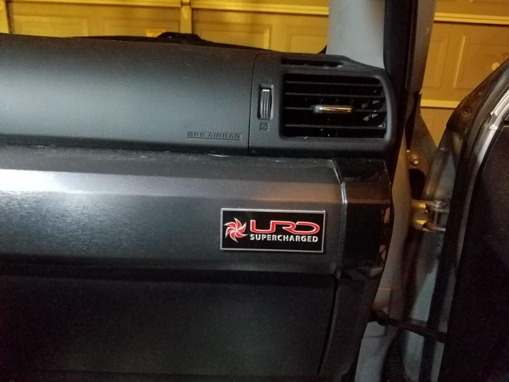

I also finally decided where to place this piece of shiny:
(Yes the rest of the dash and whole interior needs cleaned/detailed)

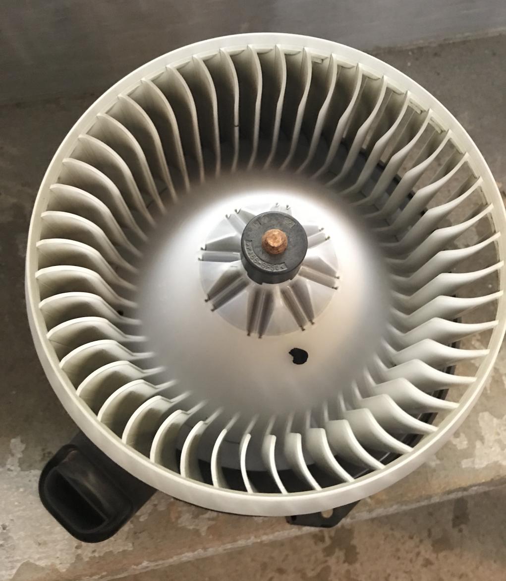

Had to replace my hvac blower fan. SO MUCH QUIETER!
