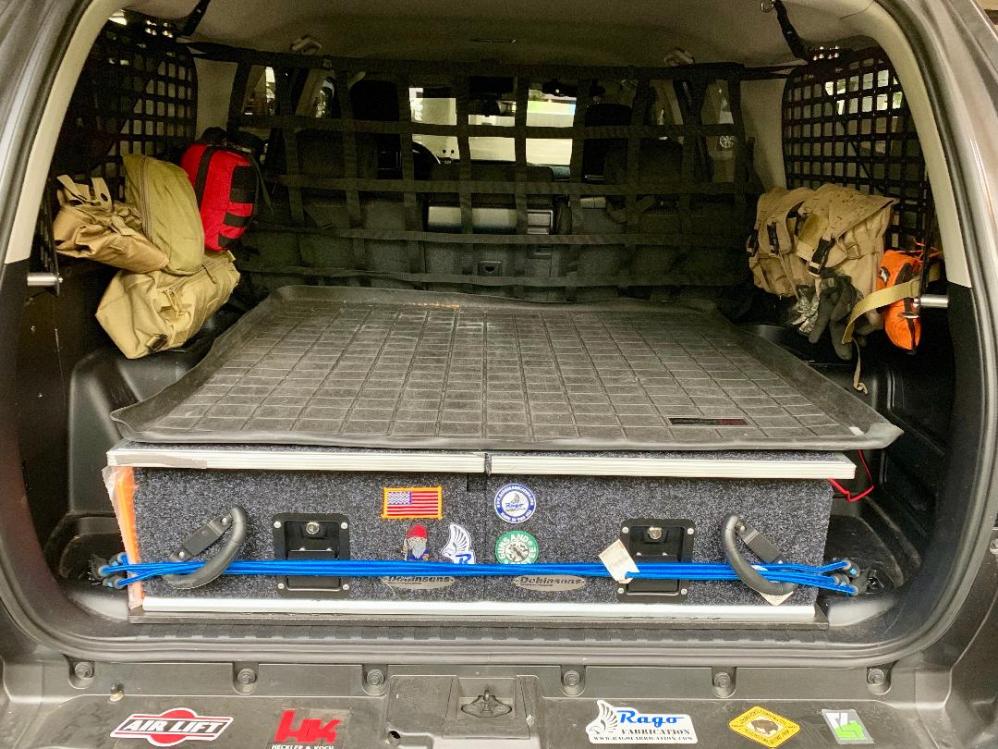

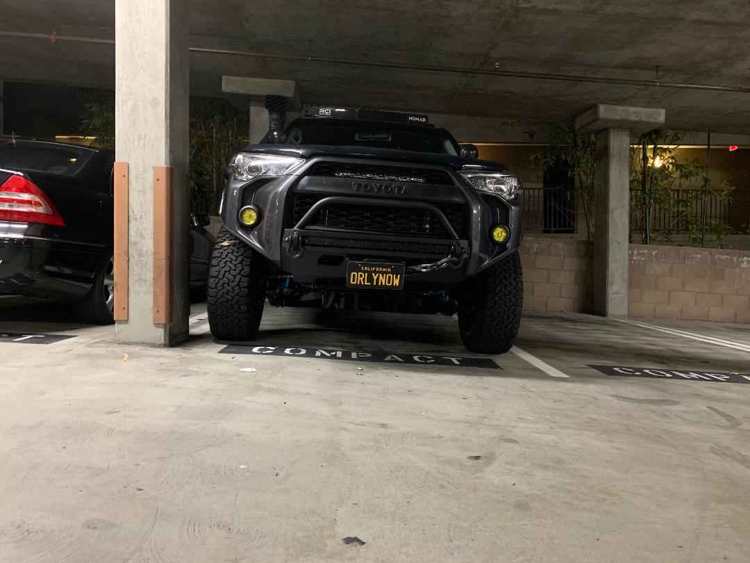

Cleaned up the cargo bay and chased down all the rattling and squeaking....oh and i finally was able to con a buddy to help me install a winch, and polished out then blacked out my RCI skidplates (giving it a black chrome effect).....

Which steel front bumper is that? Which led? Looks great
thanks man,
SSO w/ high clearance wings.
LED is some 30 inch amazon special that is broken, so I tinted the lens. Its to difficult to remove once the winch is installed so I left it there. As for lighting...i have enough lighting to wake the dead, so I didn't bother fixing it.

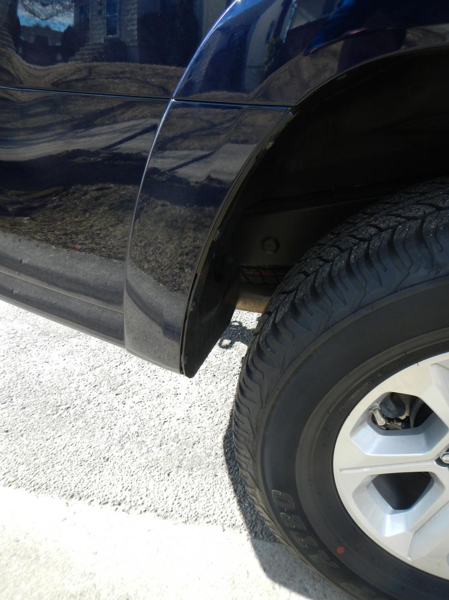

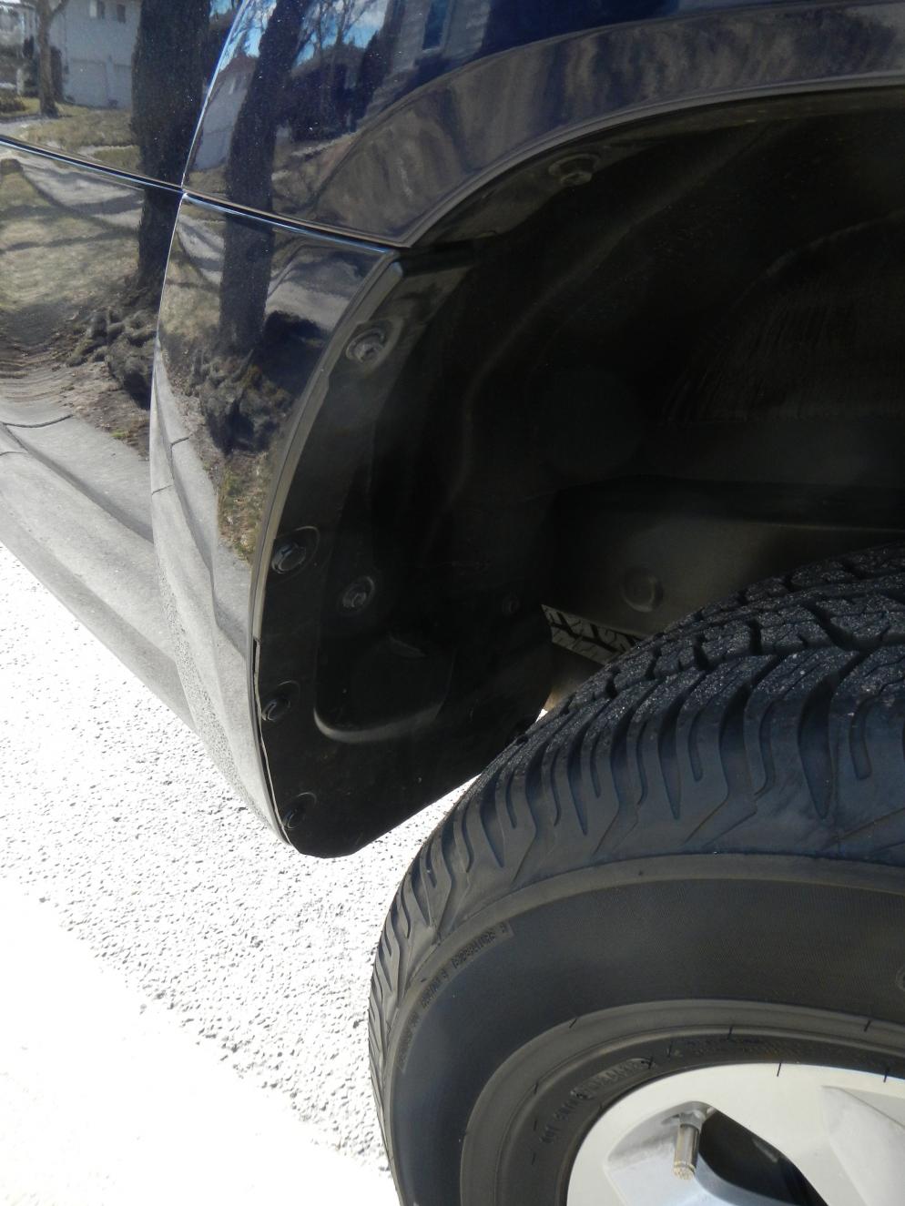

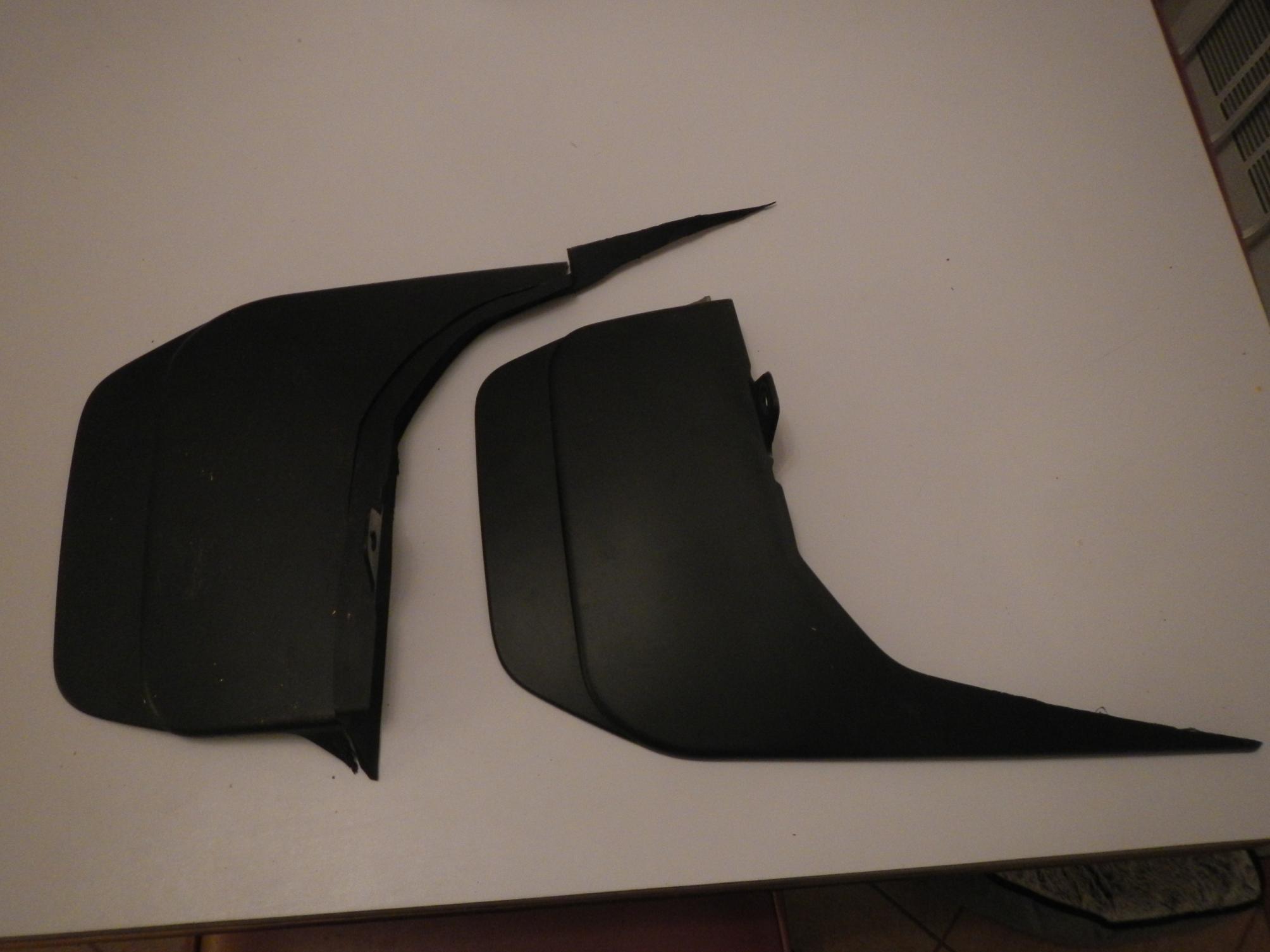

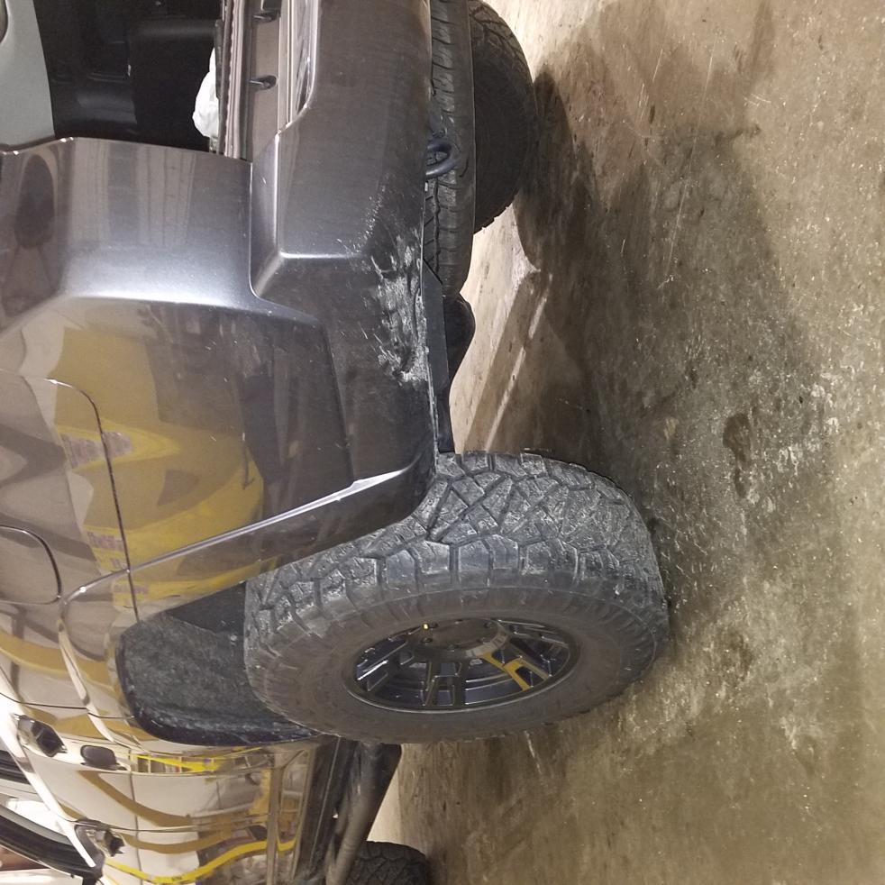

Took off the mud guards. I hate mud guards! The rears leave a gaping opening when you take them off so I cut them down and reinstalled them. I didn't take any pics (should have). They don't completely lay flat against the wheel well lip after the trimming so I'm going to mess with them a bit. I'll take some pics tomorrow.
Update: Here's a few pics. You can see they don't lay flat. I'm going to try a few things to fix that. I'll let ya know.

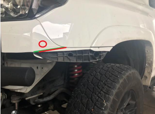

Installed a hefty tube bumper but now I need to figure out how to cover this up.
I wish I didn’t cut so high but any ideas on what to cover this with ?
i would cut the black plastic filler piece (~green line). the body colored sheet metal below will look better than that filler piece.
then cut that ugly tail of the bumper cover (~red line - enough to cover the remaining portion of filler piece)
then put a washer/screw thru the bumper cover into the remaining hole in the black plastic piece that was cut to keep it clipped in (~red circle)
edit: i think you could also cut that piece of sheet metal off that hangs below the quarter panel as im pretty sure its only purpose is to support the bumper cover that isn't there anymore

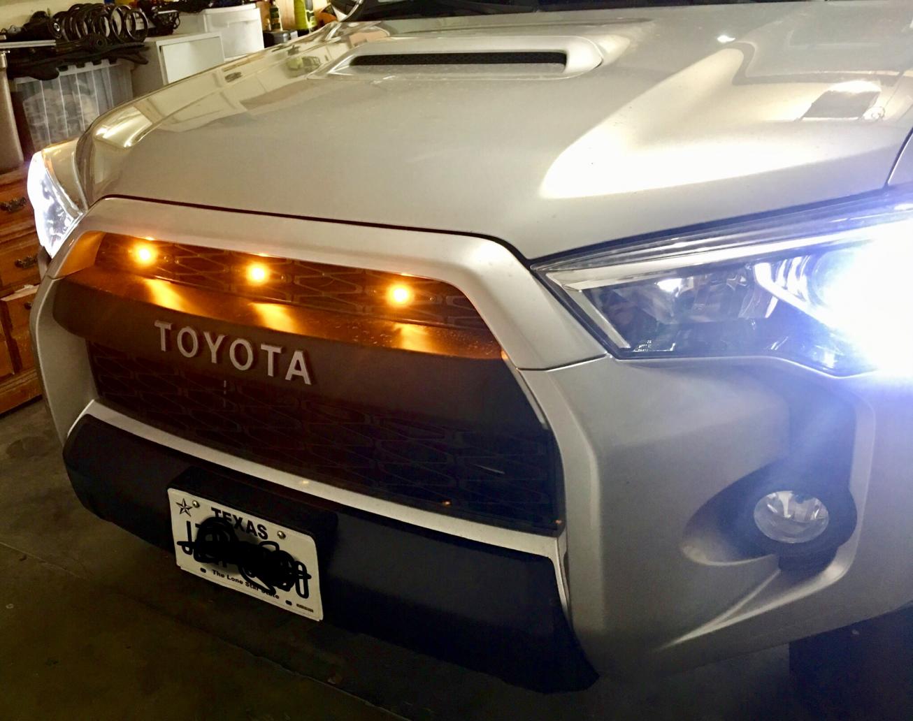

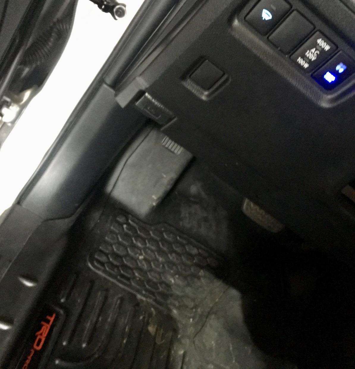

Got these Gunns Cadd Shop grill lights installed finally. I wanted independent control of them so I used a AOB switch in the dash

Remind me to NEVER drive behind you especially in dirt. Thanks for being "that guy", at least now we know who you are.
LOL man someone's triggered. Mine are cut the same way, MANY cars and trucks do not come with mud flaps at all, is what it is. Much more likely a rock will be thrown up by a rig than by anything else on the road.
